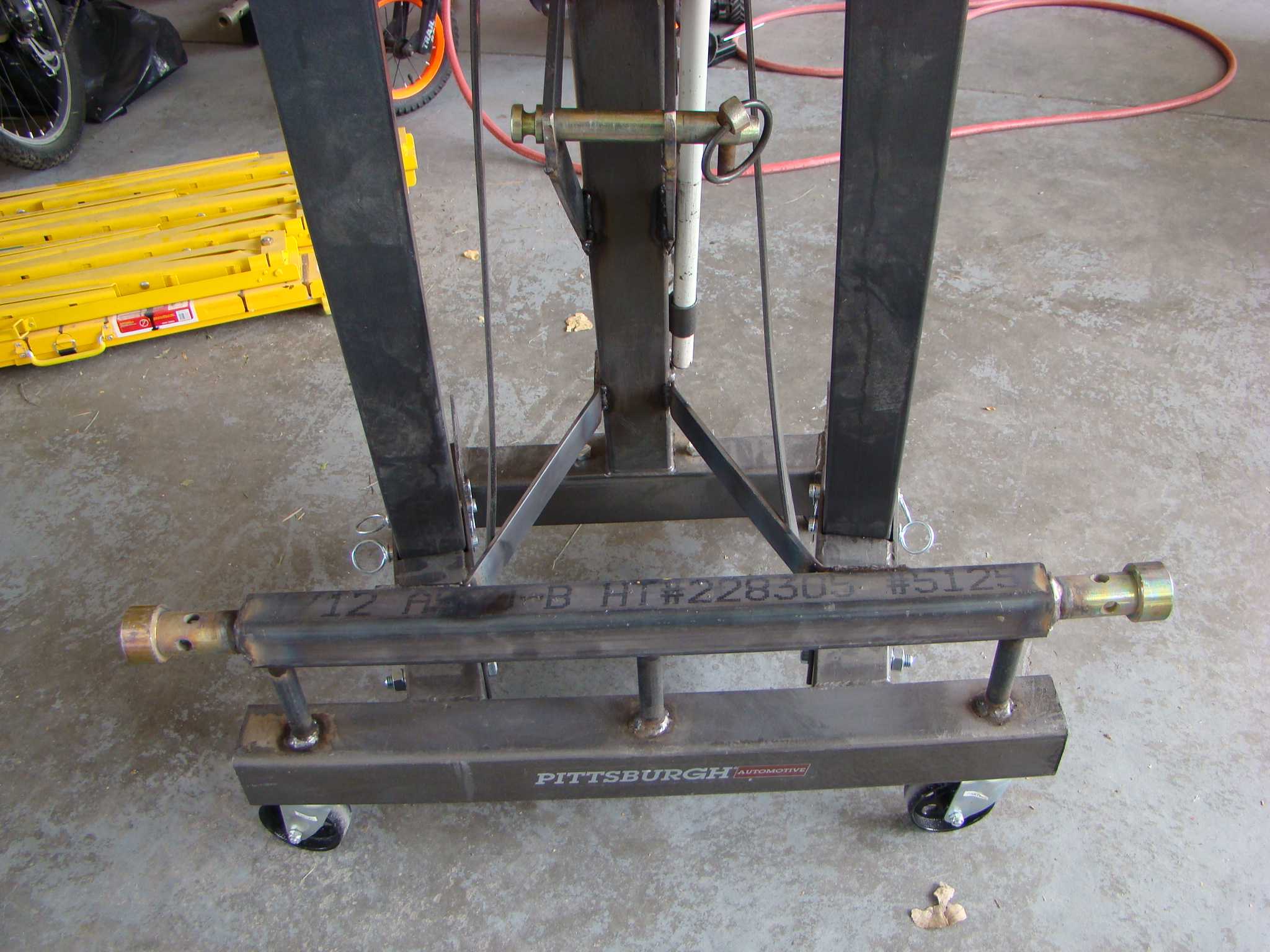

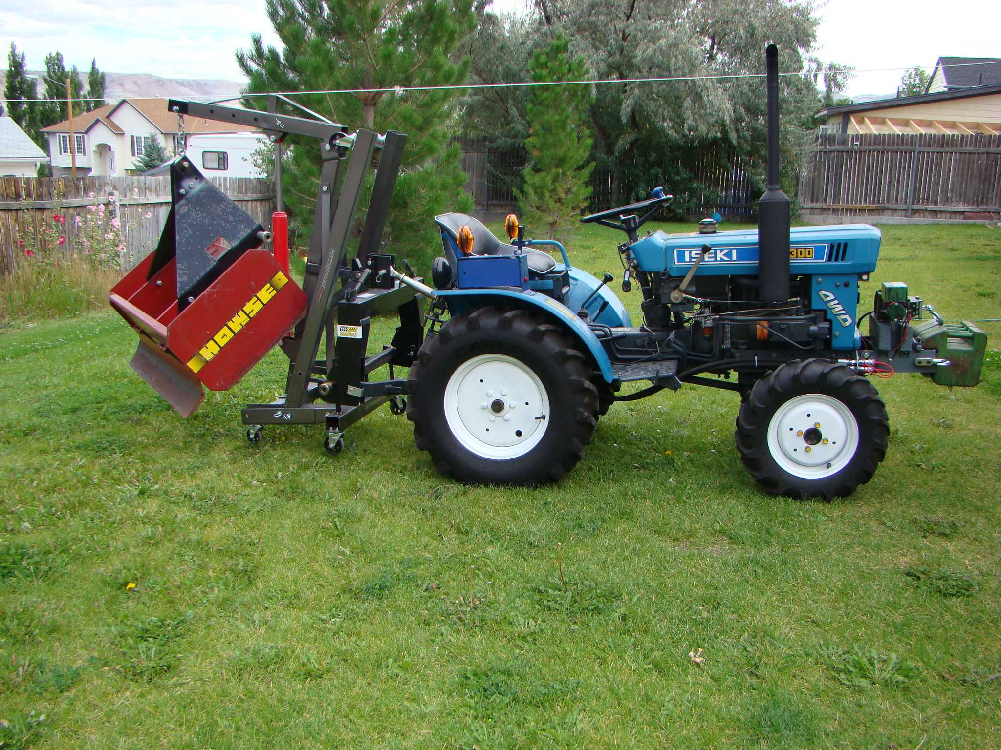

I always wanted to rig up a 3-pt connection to move my shop crane around. Finally got around to it. Works great for pulling up small trees/shrubs with the mobility it has now. I only plan on transporting it and not using it like a boom pole but I suppose it could be used like that as well. Just throwing out ideas for those that already have a crane or someone looking to get a boom pole - this might be a more useful option for close to the same price and a little fab work.

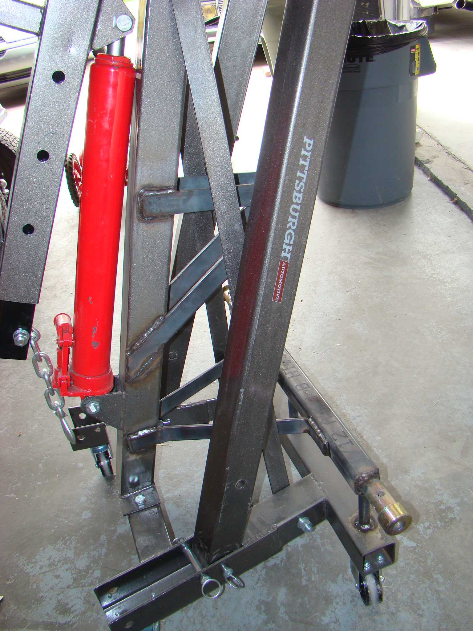

Thanks. A couple nice features of a 3-pt crane:
1.) It allows smaller tractors to have the ability to lift more than a typical boom pole and loader setup. Of course the crane needs to be set down to do so. You can still pull the unit along assuming the ground is hard and level enough to allow the crane's wheels to work. I realize crane manuals state you're not suppose to move the crane under load but I think they're pretty useless if you don't and have seen it done a lot.
2.) With the crane attached to the 3-pt, there isn't a big need to put down the legs which I find can cause problems with access to the item you're trying to lift.
As a test, I hooked up a 300 lb. load to the suspended crane just to see how it would hold-up. I added some extra bracing since the last picture.
My crane is only a 1-ton version, but I probably would have bought the 2-ton now. Something else to consider...

Neat stuff. Thanks for the links. I figured others have explored similar designs but the main thing for me is that it was kind of a hassle to move it around - the folding legs aren't rigid when they are upright so you can't grab it and move it easily by them and it doesn't roll the greatest. All the wheels swivel and it makes it hard to direct. I also have an inclined driveway and it can be a challenge moving it up and down it (well down is easy :) - lookout below!). This helps a lot with that and has a couple of added benefits. It is a good idea to run it off the tractor hydraulics - could save a lot of time if you're doing a lot of work with it off the tractor.

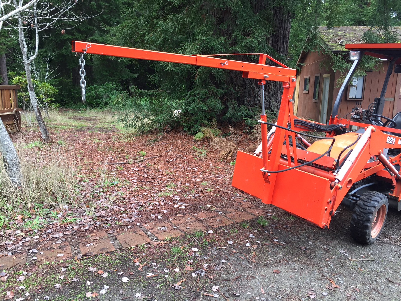

Nice job. I put my old 2 ton Harbor Freight shop crane on the front of the tractor with a SSQA conversion. Extremely handy to have an all terrain mobile shop crane. I can use it in the shop if I need to, and anywhere else as well. Since I already had front hydraulics on the loader, it was easy to swap in a hydraulic cylinder to replace the HF jack.
