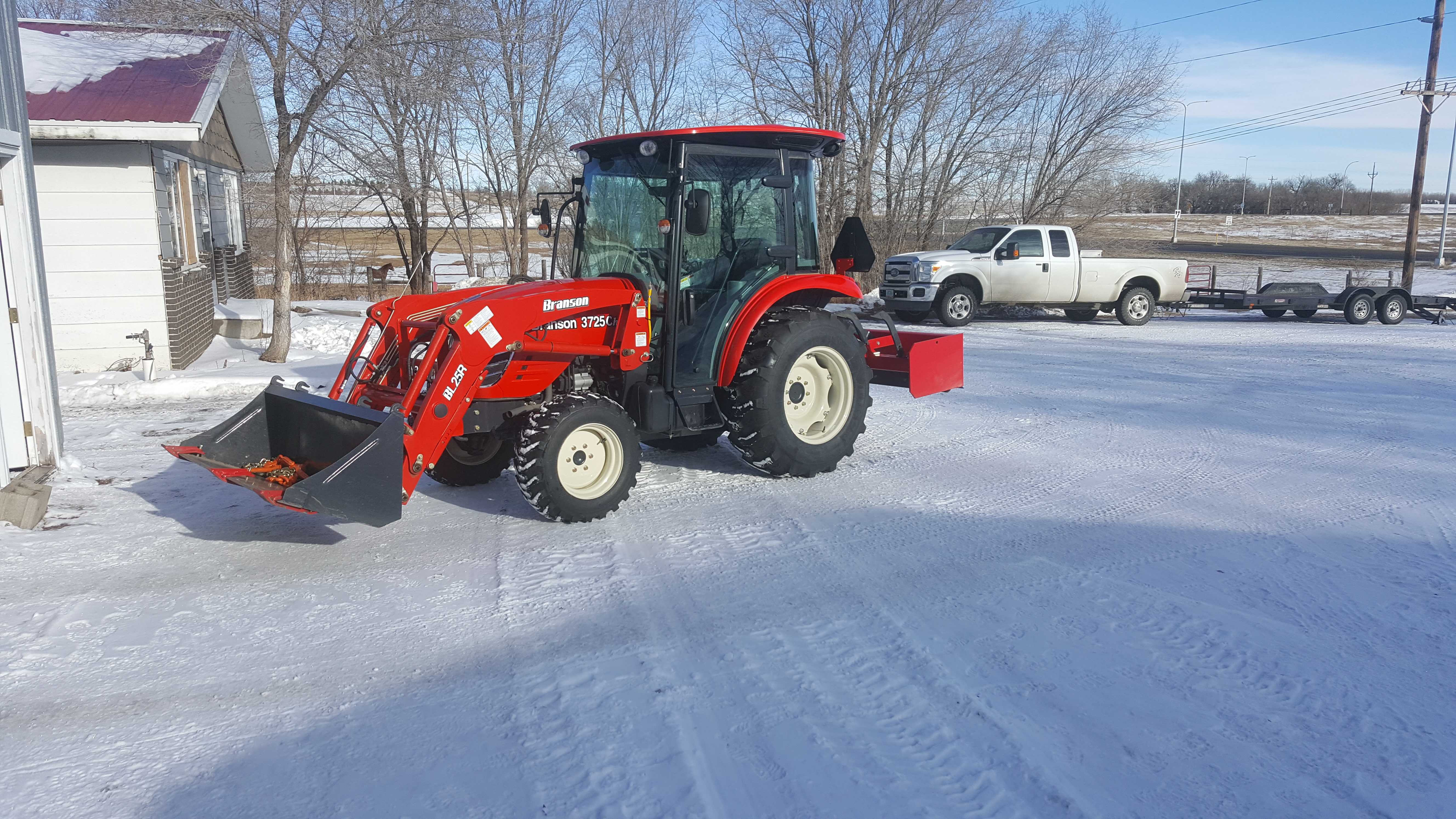

Edge Tamers on your bucket will really help with carrying gravel with the snow on your current setup. Not sure if your ground freezes hard and stays that way. But normally for us, once the ground freezes, it stays that way until spring. So I normally don't need to worry about picking up gravel once everything freezes solid.
I'm currently still using my FEL bucket and rear box blade, and once we freeze up hard, I take the Edge Tamers off the bucket. I'm a little wider than you on the rear tires, so I'm looking pretty hard at an 84" 3 pt blower myself. I think you'll be fine with a 72" blower on your tractor. Looking back over your shoulder may or may not be an issue for you, but I find that looking back at my BB hasn't really been a problem. But with a blower instead, I'll be looking back more, using the blower more than the bucket (like now). I'd love to have a front blower, but since I don't do this for a living, I can't justify the added cost (and extra hardware hassles) over a 3 pt blower.

I use (2) of the 4” Edge Tamers on my 72” bucket. The company recommends (3).
As far as the blower, I ran a 72” blower on my previous L3410, which I think was around 28hp at the pto... no issues.

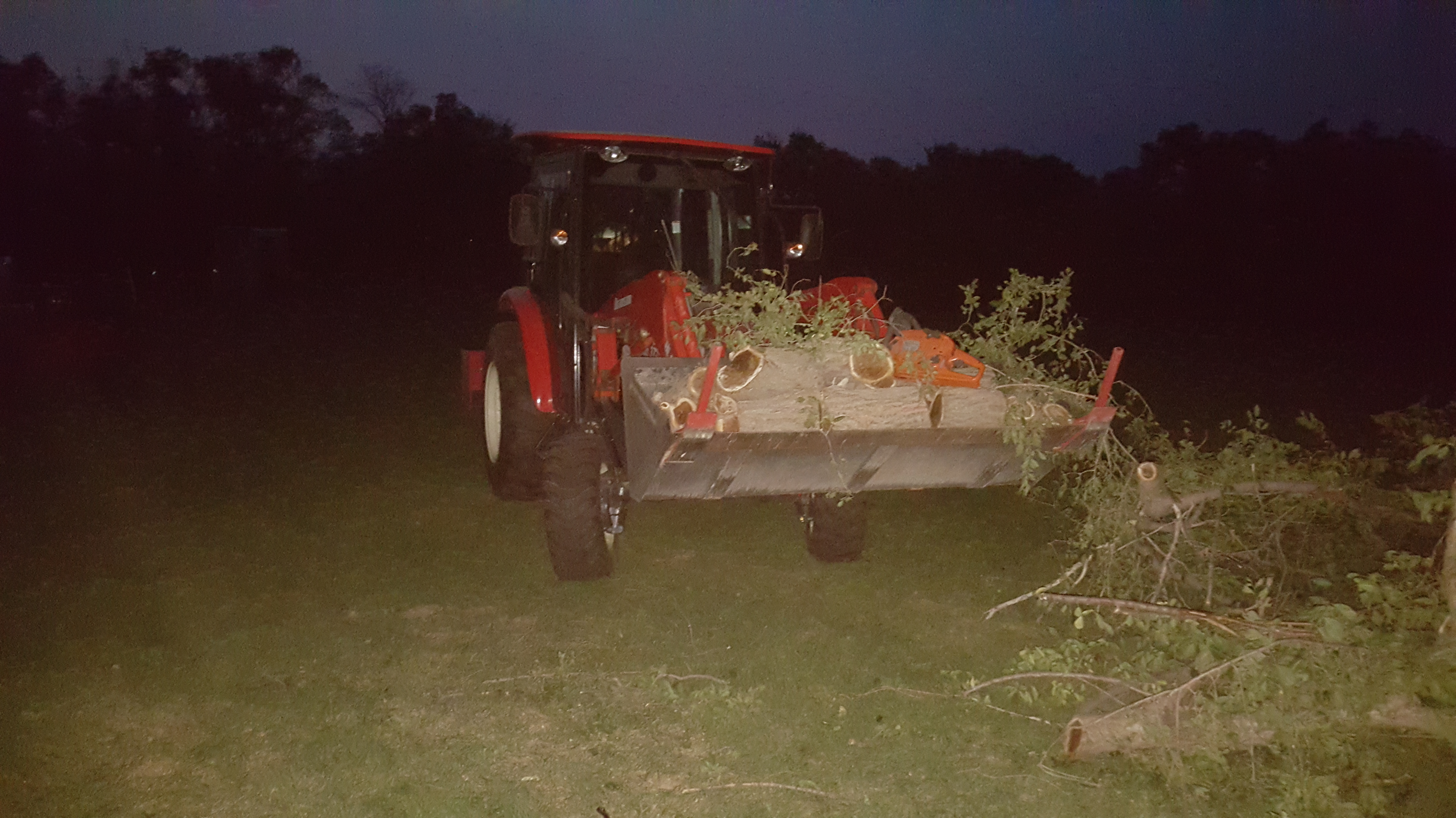

I'm using 3 across my bucket now. The wider the bucket, the more of them you need, to prevent the unprotected portion of the edge from digging in over uneven ground, like say the crown portion of a road or driveway. You can kind of see how they are spaced across the bucket edge in this pic.
I don't have a bolt on cutting edge, so I haven't had to worry about interference from that. I also bought the Edge Extenders, and do use them from time to time. Just one bolt attaches them to the base Tamer. Can kind of see 2 of them in this pic, since I'm not using the Edge Tamers (in this shot) to guard the bucket edge, I was only using the 2 on each bucket corner to carry tree limbs with the Extenders bolted on.

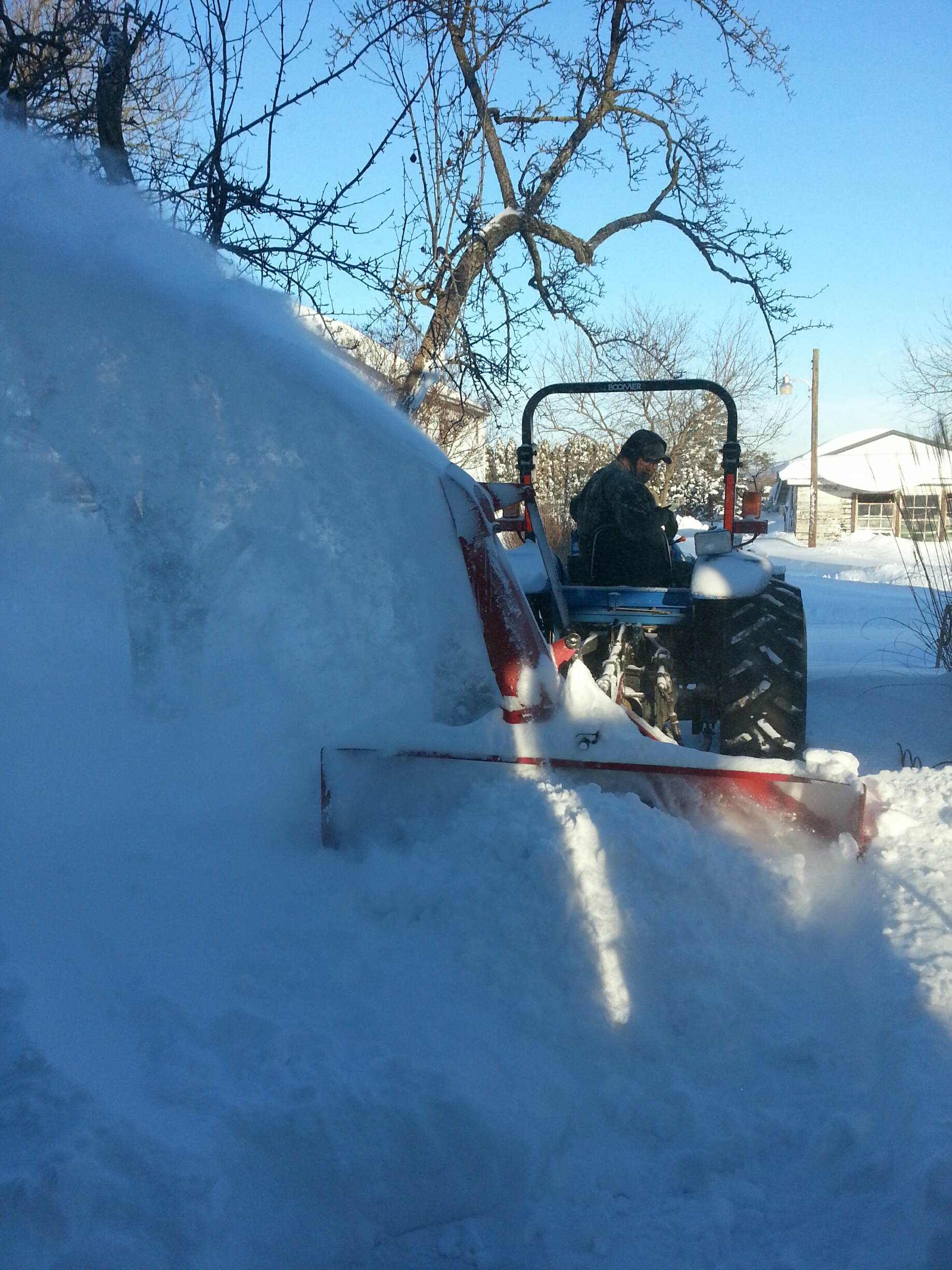

I was in a similar position in the summer of 2017. I had pretty much decided I could not justify the cost: nice to have, but don't need to have. A local friend knew I was debating a snowblower, and offered to sell me his 64" Provnost Puma. It was in great condition - missing paint in a couple places, but otherwise just fine. I had been debating buying a 66" or a 72" blower, so I had some maneuvering room. 72" might be on the big side for my 33 HP tractor, but I figured with the hydrostatic transmission, I could always just slow down (Provnost says the 72" Puma is for 20-35 HP, which I found hard to believe at the time).
At 64", his blower was just 1" wider than my rear tires. 1/2" extra on either side did not seem like enough to me, but when he said he wanted $500 for it, I reconsidered. I told him "you do know these are selling used for something like $1300-$1500, right? I'd feel like I'm taking advantage of you." He insisted that he just wanted it gone.
It's been working out great, and the narrower width has not been an issue. Definitely worth the $500 I spent.
