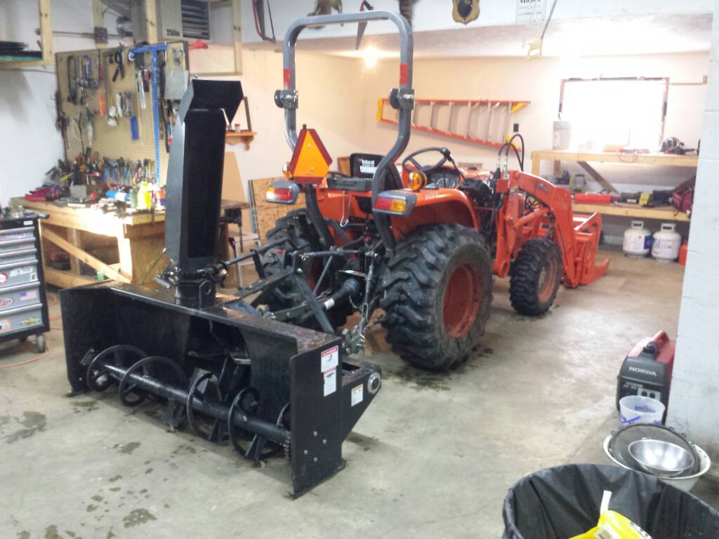

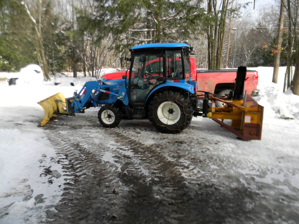

For a 3 pt. blower width I'd suggest a blower that is wider than your tractor track width. My tractor is similar to yours at 36 HP and is 66" wide and I run a 7 1/2' plow on front and an 84" blower on the 3 pt. I have a plow for my truck but rarely use it because the tractor is much easier to maneuver in tight places.
For your 68" width a 72" blower would be fine. That's what I was looking for but found a deal on the 84" I bought on CL. My plow is an old truck plow I had laying around and adapted to a QA plate. I had previously run hydraulics from 1 rear remote to the front to control the angle. If you don't have front hyd. a manual angle plow will work too. For the gravel drive adjust the blower shoes to keep the blower up off the gravel as it will throw gravel.

So which one do I order, 60" or 72"? The 60' says its for 25-40 hp tractors, the 72" says 35-50 hp. The reviews on both, people say they are easily handling them with below rating tractors. The Workmaster 35 is 33 hp, 68" bucket, and 64" wide at the rear tires. Am I safe with the 72"?
Can it physically handle it (lift it, not get light on front wheels)?
Horsepower is a measure of speed. (How fast you can do the job).
Width is just one factor that determines how much horsepower is needed.
How deep is the snow?
How dense (heavy) is the snow?
How fast are you trying to go?
Not every storm is the heaviest, deepest snow it can handle. Reality mixes these factors. Speed is the one you can control (along with how big of a "bite" you take after the first swath: full width or overlap some?) With a hydrostatic I wouldn't worry about going big because you can always go slower....as long as the tractor can physically handle it.
Funny, the New Holland Workmaster 35 is just a rebranded LS 3033. This is basicly the exact setup I was thinking, blower on the back and a blade up front, but I figured I would start with the blower, and see how necessary the blade would be. Trying to get the wife to pony up half the money since the horses are her business, and the gravel was her decision, but somehow Im the one doing all the work for free, and buying tractors, trailers, and attachments to do it to boot!

If you can afford the difference, go for the 35-50HP 72" blower. It will be wider than your wheels and it likely has stronger steel parts. Also the PTO connection may align more evenly with your tractor reducing forces on the shaft joints.
Definitely go for a hydraulic chute direction control if you have rear remotes. My chute deflector has a manual pin adjustment but I am working on a 12volt worm drive setup. I am open station and so being able to adjust the deflector will help with blow back.
