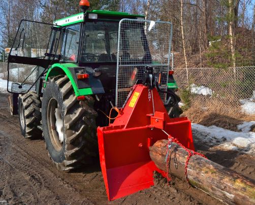

flingwing1969 - I consider the Norwood Skid Winch video to be...how shall we say, less than impressive. Skidding over clear, leaf-covered ground, is as easy as it gets. The videos of Farmi winches are typically much more interesting, stuff like pulling three trees at once through nasty terrain.
Originally I set out to just build my own clone of the Norwood, it looks so simple, anybody could build that. But hours of shopping for hydraulic motors came out with nothing that made sense.
High speed, low-torque hydraulic motors are readily available, but useless in terms of pulling power.
Slow speed high-torque motors are also plentiful, but all require massive flow rates, like 15-20 GPM. On the hobby-end of the tractor market, nobody has tractors flowing that.
I have no idea what Norwood picked for their unit, but given the video, I suspect they had to make a compromise in the end, and the unit lacks pulling power. Pretty sure my PTO winch easily out pulls it.
PILOON - If I didn't have a dual-shaft gearbox, I would have done vertical mounted drum. Working out the mounting for this gearbox in a vertical configuration was hurting my head too much to attempt, so I just went with horizontal.
Great write up and a very nice build!
Correct me if I'm wrong but doesn't a horizontal capstan require you to stand in the danger zone from a line snap? The advantage to a vertical capstan is that you stand off to the side a bit and out of harms way.
Could you weld a couple of eyes to the top link bracket and use a snatch block on the low tension side? That way you could operate it off to the side of the pull line.
Just my $.02

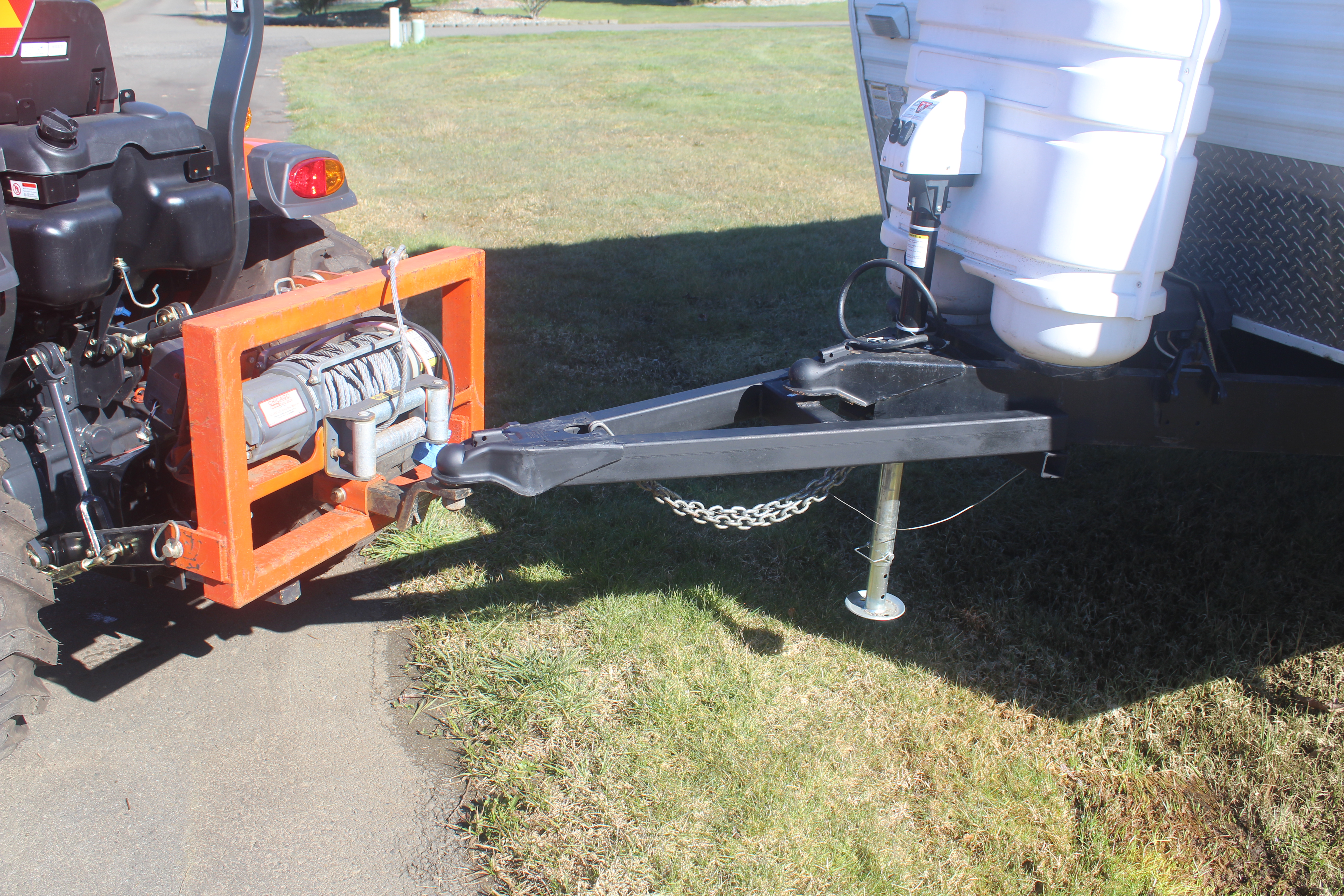

Is your trailer hitch extension just for maneuvering with the tractor?
No, I put that extension so my truck would clear when turning sharp. I pull it with a 5500 dodge flatbed and it would punch holes in the front of the trailer without the extension.
It comes off by releasing the original trailer hitch. I had just made it and used the tractor to bring it in the shop and back it out after building.
