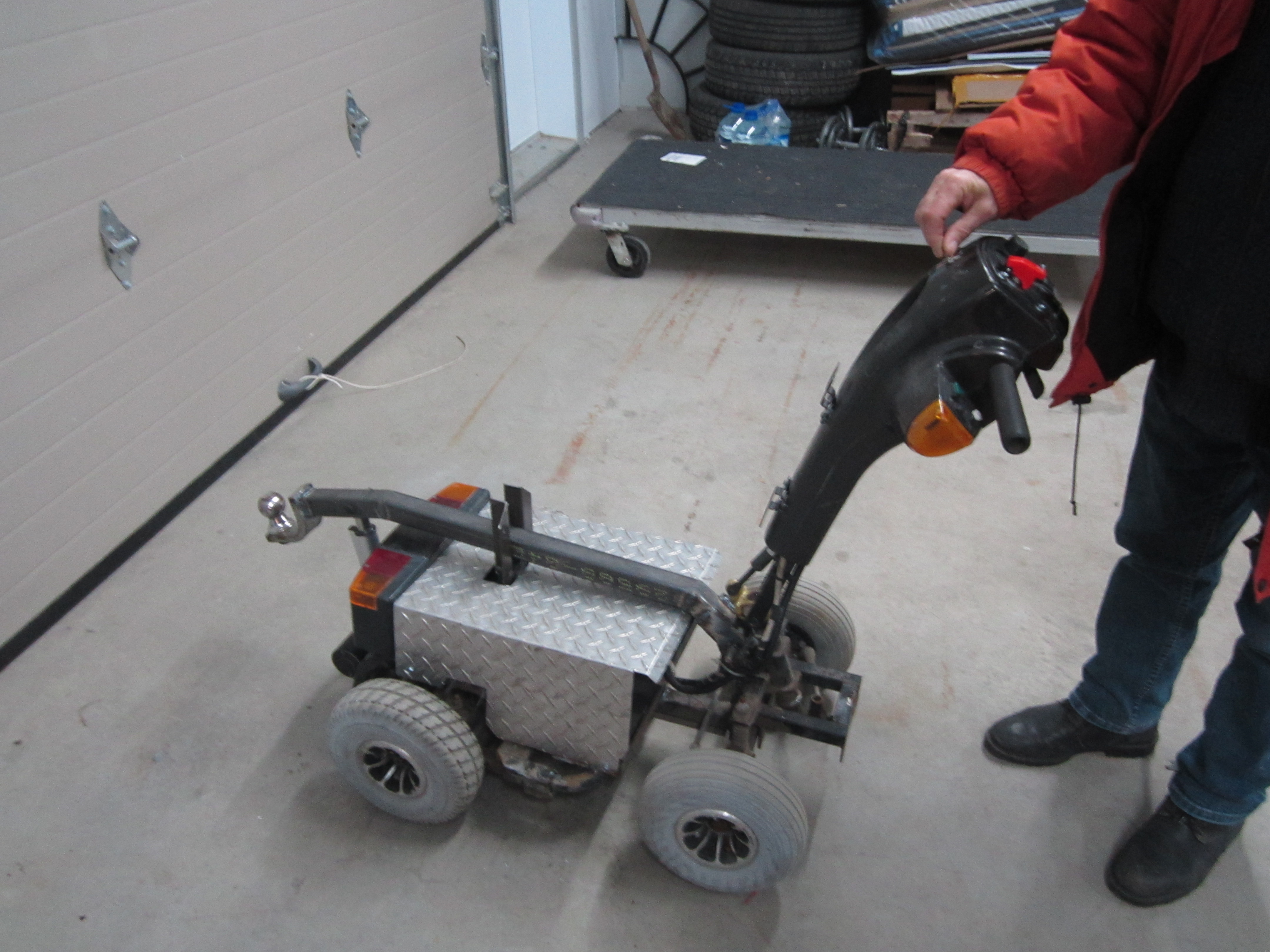

Do a new Thread for that one - assuming we're talking about the "wheelchair trailer mover thingy". Love to see that too as I happen to have a nice motorize chair not being used. They can be had "pretty cheap" too.
Photo should be attached.
Sorry only one I have is the finished project.
Note reversed handle bar, (easy mod), the framework was cut and shortened.
The lifting is a 12 volt electric screw jack that I had.
The lift arm is shaped downwards to slip under the trailer hitch.
Yet to come is some weight ballast that will be in a metal box below the steering post.
I calculated we will need about 125-150 lbs.
On the fun side, none of the electrics were modified so the 'mover' has lights, horn flasher etc. So it is 'night time rated'. LOL.
The hand in the pix is on the 'up/down' switch that controls the arm.
This mover is for my friends storage facility that offers free trailers for his clients to move in. He also rents as well so some days they move trailers a dozen times or so.
When we install the weight box it will also serve for parts and tool storage.
Was a real fun project, and it handles really well.

Instead of a weight box on back, put a stand on like a walk behind mower, that way you can ride on it and be the counter weight
