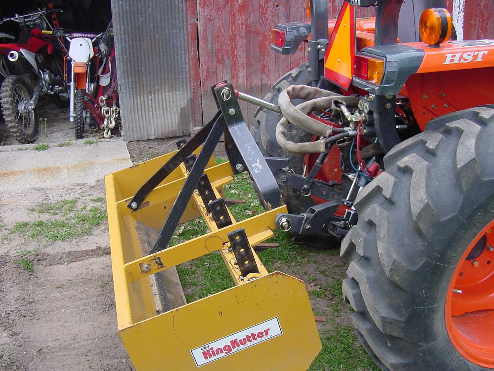

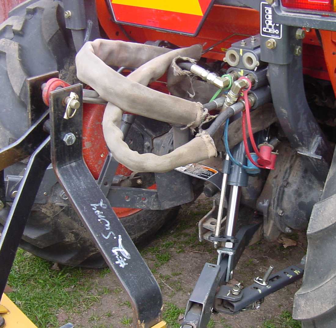

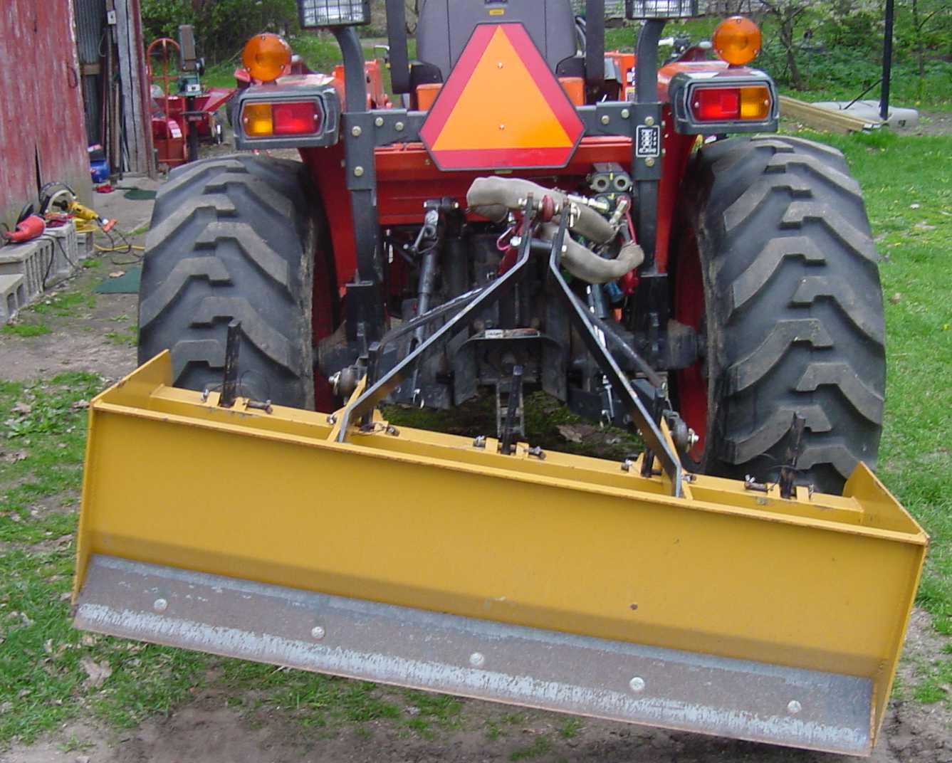

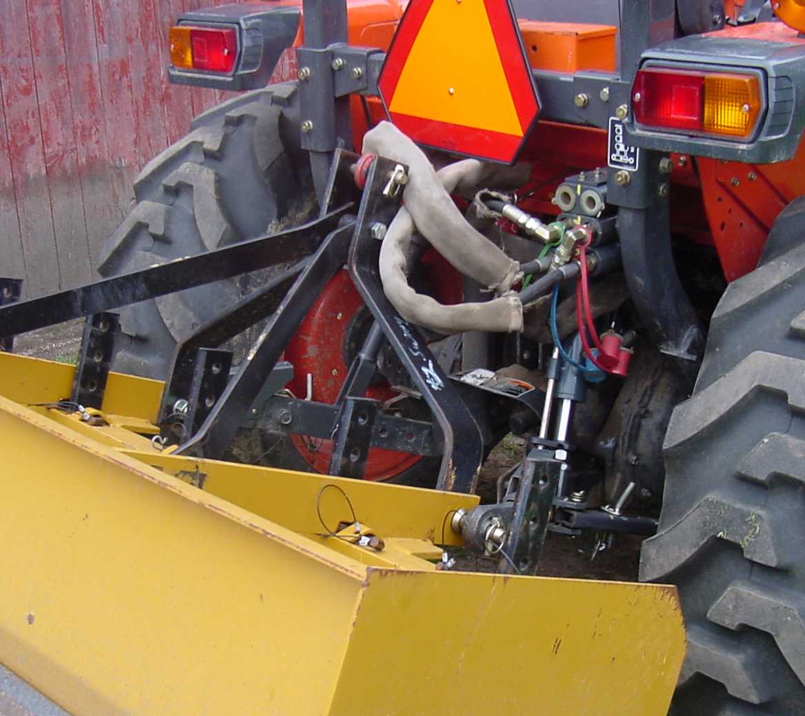

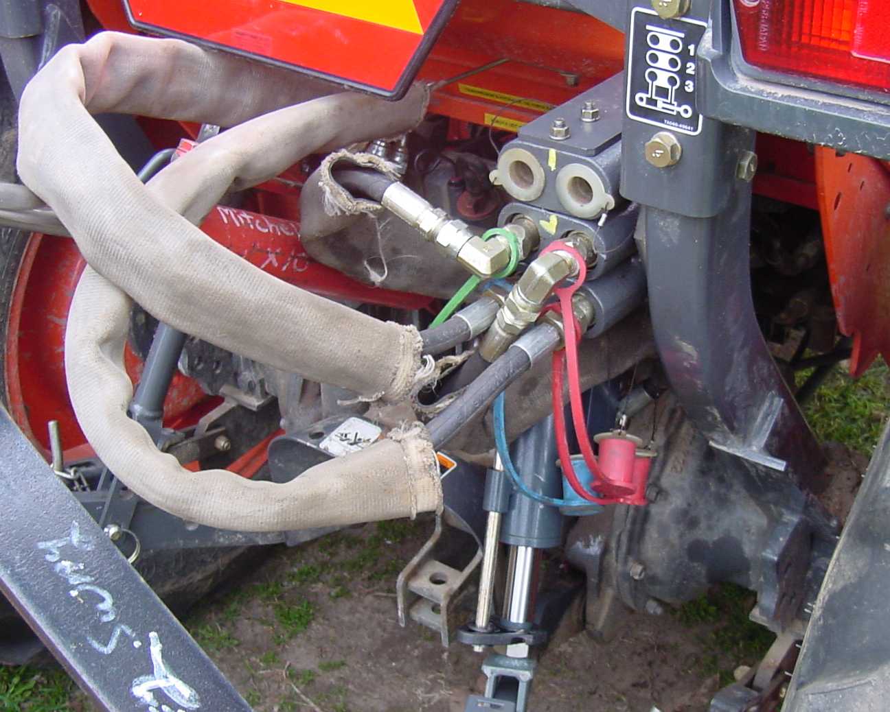

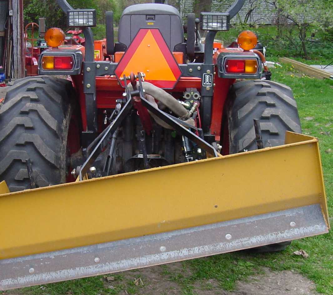

   / 3 Rear Remotes: Worth It?? #13
Here is some photos of my Kubota L3430 with three remotes and the Top n Tilt setup.

   / 3 Rear Remotes: Worth It?? #14
I have 3 rear remotes, 2 with 1/4" QD fittings for TNT and one with 3/8" QD for everything else like my dump wagon. In the winter I leave the hydraulic top link and use the other 1/4" QD for the snowblower chute deflector and the 3/8" QD for the chute rotator.
In my opinion, if you are going to get one then you might as well pony up and get all three. You will always find a need for them.
