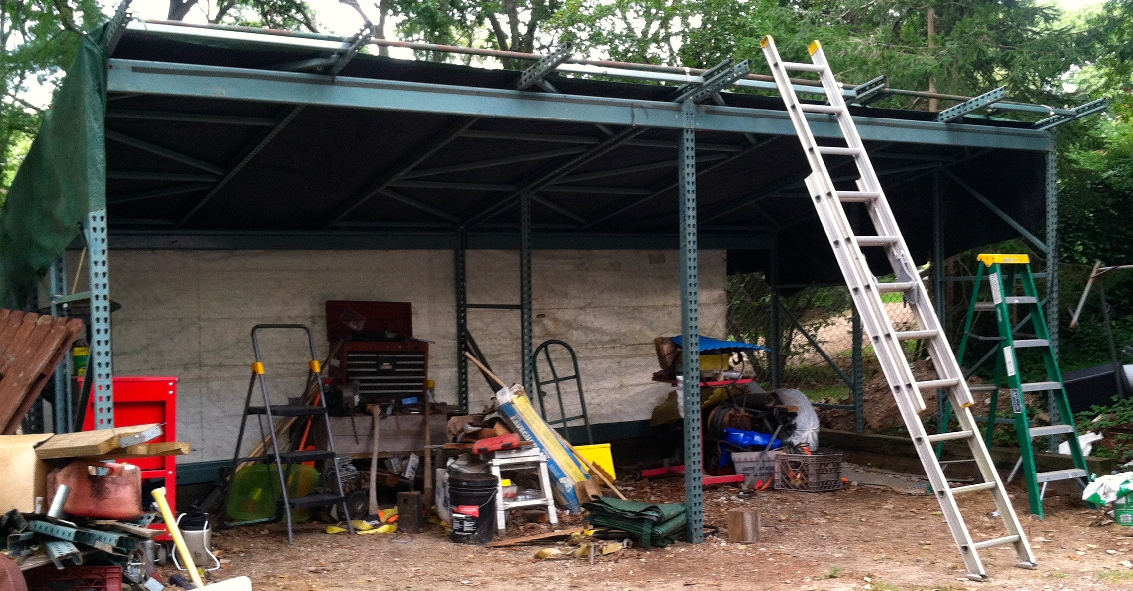

Much more important then the rafter size is what you will use for a header.
Agreed - interestingly, the plan reviewer in our town made me use 4X2X12 built up beam to support my rafters. Largest span is 15 feet. Beam sits atop 6x6 PT posts. Snow load is 40 psf where I live.
For the OP, the opening of my 'lean to' faces trees and is somewhat in a forested area. Over the last 5 years, I have had minimal rain / snow come in the open side, BUT, a) I have yearned for doors for 4 years now (and building this summer), b) humidity condensates on my equipment on certain days. My rafters are 2x10 on 16" centers. Longest unsupported span is 11.5 feet. This might help your planning but a call to your county might be helpful too.

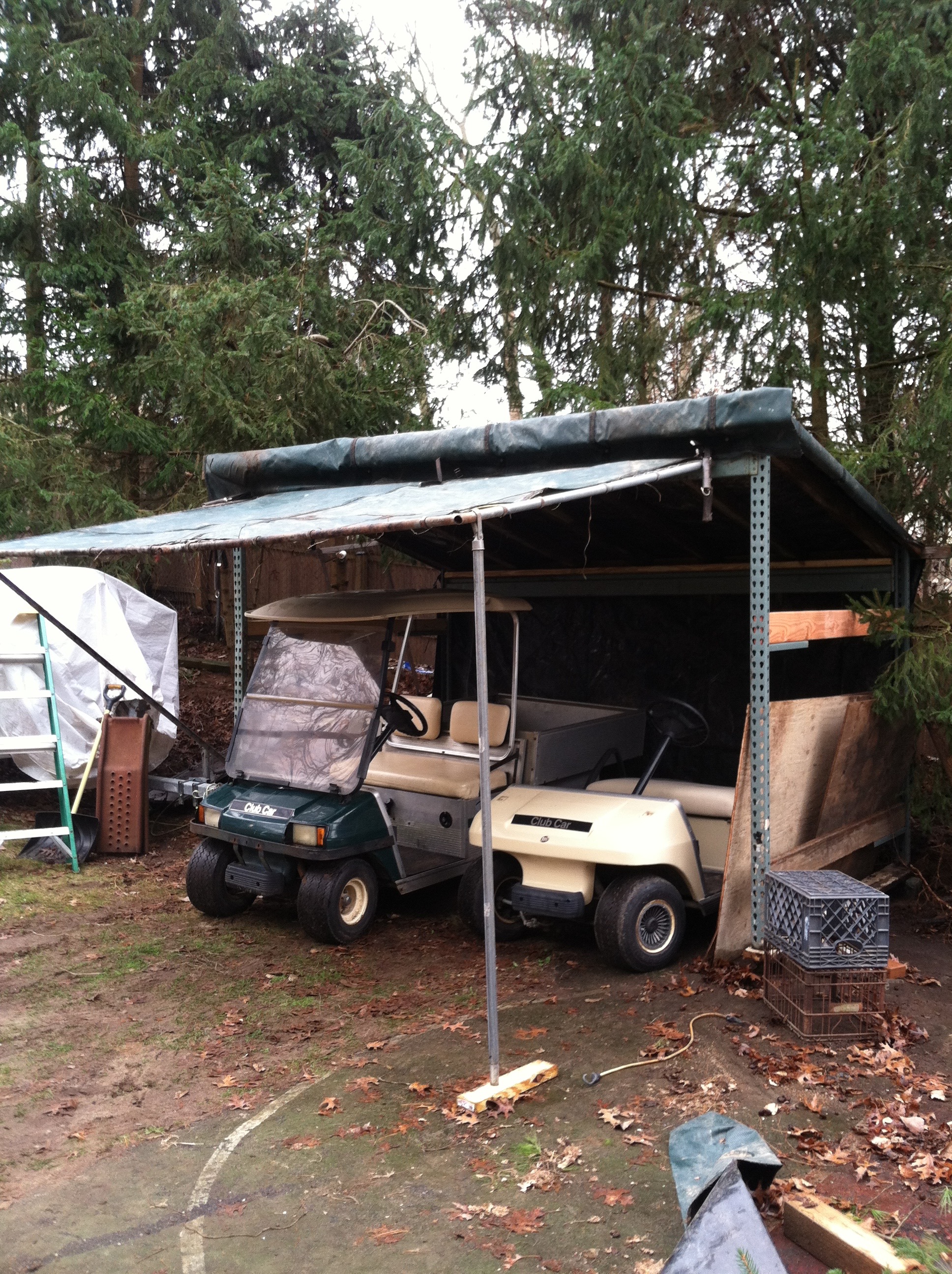

Any chance of a cab for you tractor in the future? If so, you will probably need a higher roof. Also as others have said, go with doors or at least a tarp.
Al

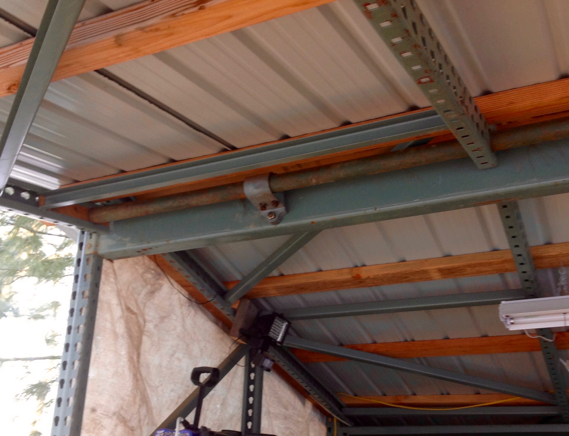

Here's my 3-sided shed that I built about 8 years ago. It's 28 ft wide (two 14-ft bays), 20 ft deep, 10 ft high in front sloping to 9 ft high in the rear. 28 ga metal sides and roof.
Equipment shed-1.JPGEquipment shed-2.JPGEquipment shed-3.JPGEquipment shed-4.JPG
I used doubled 2x12s glued and nailed together to span the 14 ft bays for the front, middle and rear beams that are carried by the posts.
The intermediate rafters are 2x10s.
No problem with snow loads in the North Sacramento Valley.

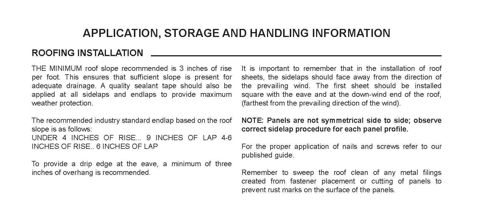

I think everyone here is giving lots of good information and references so you should be in good shape on sizing. The only caution I would throw in is to be careful on the roof slope, with snow loading. A shallow slope will leak a lot quicker and the snow will not slide off so easily. Your plan looks like a 1 in 8 slope. The metal roofing companies will tell you that they are designed for a 1 in 4 slope as a minimum. If I were doing it, I would raise the front by another 1.5 feet and, if I felt ambitious, add an overhang, sloping back down like one of the examples posted, to provide a little more protection.

Most steel buildings are a 1:12 pitch. I just built one and had to argue to get them do a special 3:12 pitch.
1.5:12 is fine for a metal roof.
/ 3 sided shed #28
Interesting. I'm attaching a sheet from a roofing supplier that says 1 in 4 is minimum recommended. I guess there are different approaches.

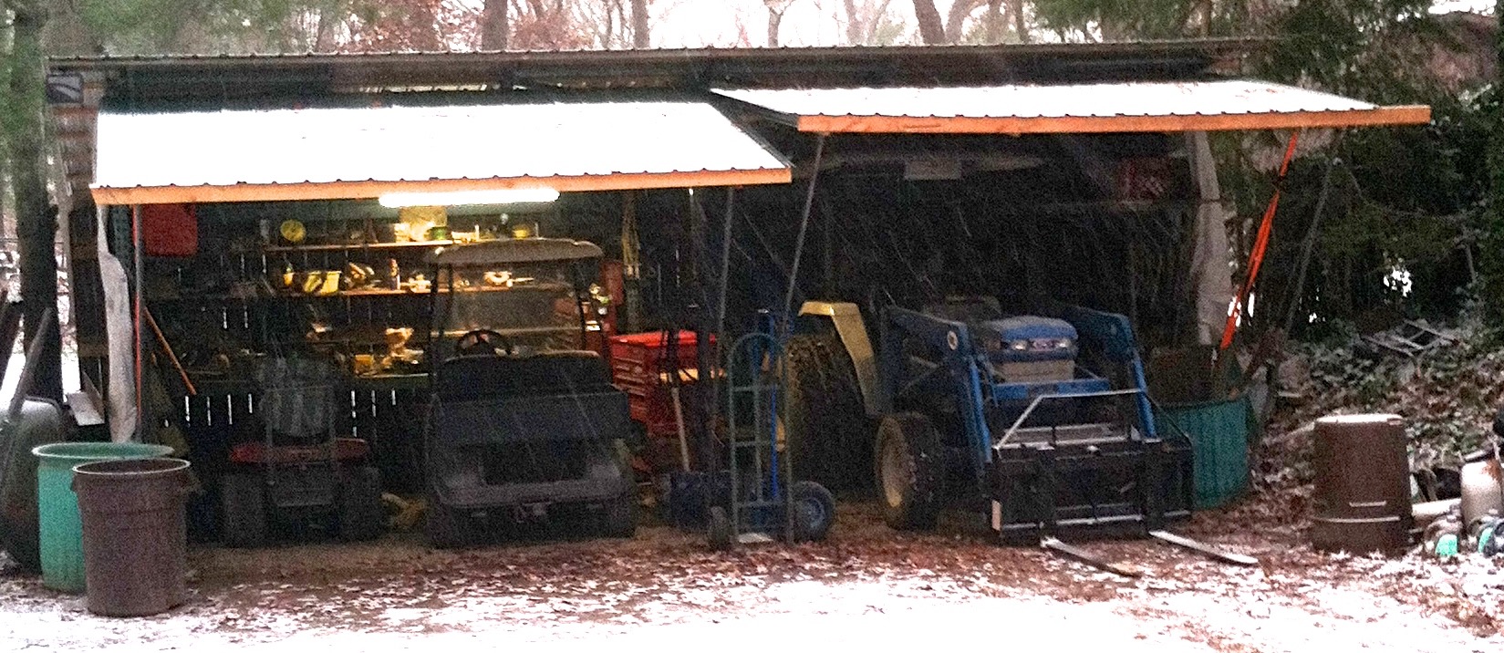

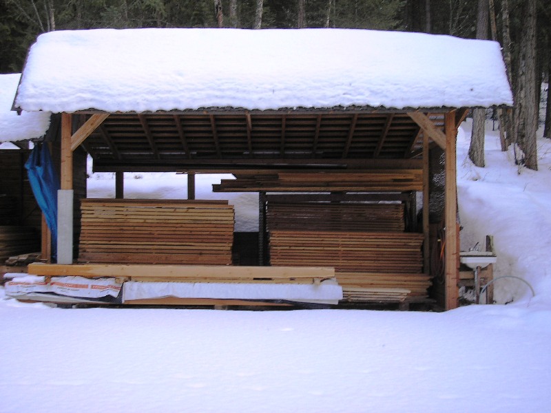

This shed is 14' deep ,16' between posts in front 6x12" beam,ruff 2x6 rafters 2' centers full 1x6" strapping 12" centers 12' high in front 8' at back approx. 3/12 pitch. Building is 10 years old now and had over 5' of heavy snow a few times no sags & no leaks. Metal roof with heavy felt paper under still gets condensation with the right winter conditions twice so far.

When the snow is really piled high, it's usually very cold and the snow is pretty light. It really gets heavy in the spring when it's mostly ice. It will slide off or drain off as it melts on the bottom from the weight. The problem with a low slope roof is that, as it melts, it forms ice dams and won't drain. So you essentially have water standing on roof, which is bad whether there are joints or not. We very seldom see lap joints on pole barns now that 40' sheets are available but the recommendation where I get steel is still a minimum 3 in 12. I'm not saying a shallower slope won't work, but the suppliers here say the 40/50 year warranty doesn't apply.

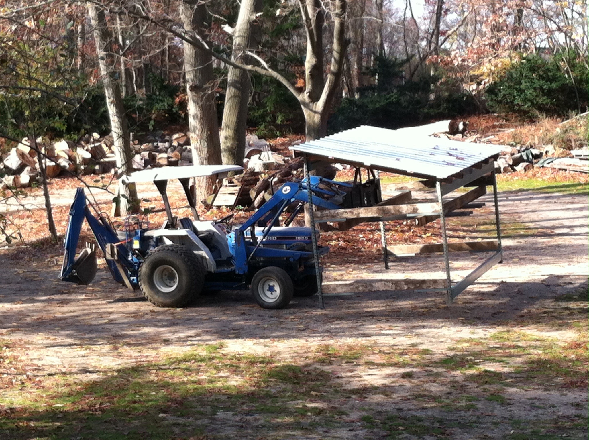

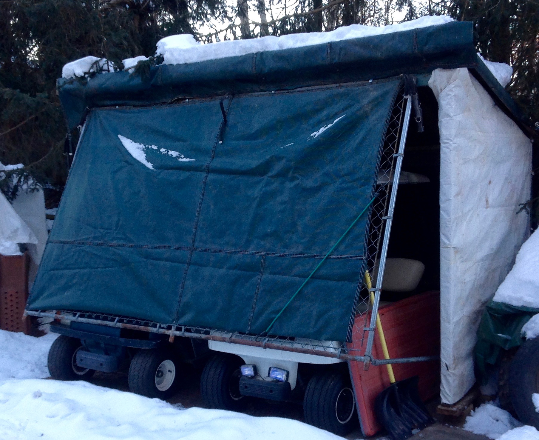

I built several very similar to this
first was for tractor over winter but eventually added a fold down awning for big snowstorms in winter.
shed is 10 foot deep and 22 ft wide 8 ft high at front and 6ft at back.
lagged down to double height 6x6 at bottom
awning adds another 7 ft of shade in summer
smaller one is 6 ft deep and 11 ft wide they are working out great
