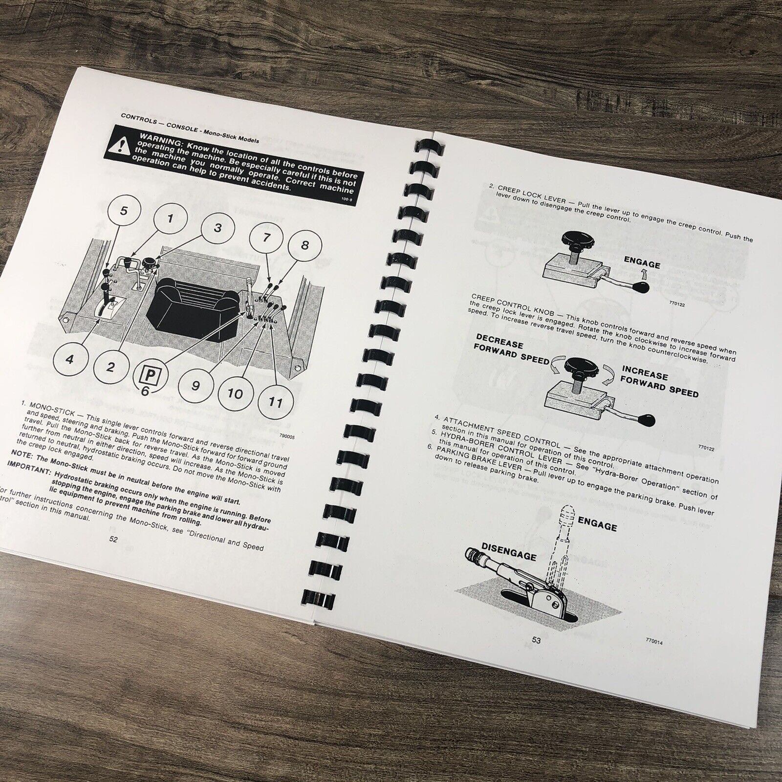

Found this photo through random searches, but mine is on the column.

I would expect the work selection is what would allow the creep to work, in forward or reverse.
