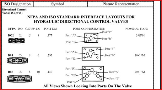

Okay, so if I can find a cartridge valve, open center, appropriate flow rate, with a single or double spool (or two stacked, whatever), it should stack together with my existing A16 valve?
That's the hypothesis. Gotta check that out. If anyone knows of one (including Mahindra's new triple remote valves- would love to check one out. I think they are just 3 cartridge valves stacked together)
So what about the "4" on the valve? Any ideas? Remember, it is printed in line with the A16, but before it and upside down. Had a heck of a time trying to figure out what it was in that tight spot, since the "A" was certainly an A and the 4 was certainly a 4 but were upside down from each other.

Found this on the site you posted, in the e-book. Lots of info there, but only grabbed a small excerpt to comply with any copyrights. Here is the link to the original page from the author:
CHAPTER 4: ISO Symbols and Glossary, part 2
Excerpt image attached.
Thanks, AKKAMAAN! Now to determine the port size and see if I can find the right valve- possibly even a solenoid actuated one if the price is right. Kennyd had recommended a good stackable valve, if it matches up. Here:
https://www.surpluscenter.com/item.asp?UID=2348022216550503&item=9-7852&catname=hydraulic
I think we're getting somewhere :thumbsup:
