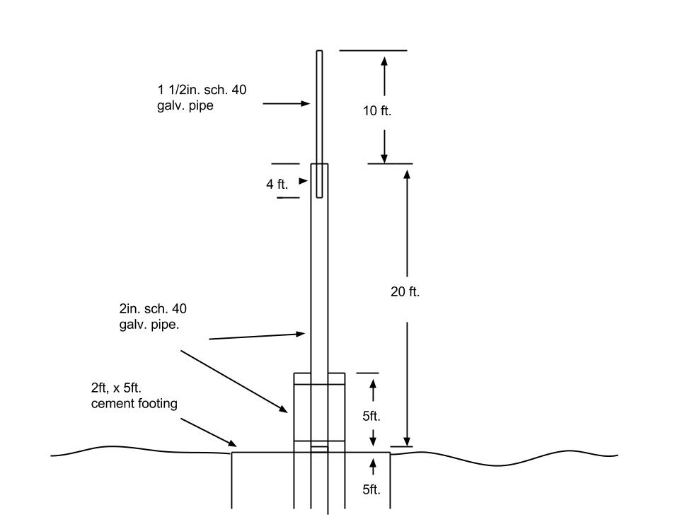

My wife has decided that "we" need a new flag pole, a 30 Ft. pole !
After pricing poles and recovering from the shock, I decided to build a tilt up pole. I have attached a drawing of what I plan to build and would appreciate your input.
One thing I should mention is that we regularly get 70 + mph. wind gusts and she intends for me to fly 2 - flags - 4 Ft. x 6 Ft.

is that footing 2 feet in diameter and 5 feet deep?
/ 30 Ft. Flag Pole
Yes

Assuming you have a hinge pin at about 4' ...are you then putting counter weight inside the center pipe up to that hinge pin? I was just thinking in order to get enough counter weight inside the pipe you might want to raise the height of the hinge pin. If you want a good look at the application of what you're designing - find a NWS ASOS site (surface observation system) and look at their tip over wind tower. They tend to be at airports but a good pair of binoculars will let you see what you need to see. Or visit the local NWS office (just walk in) and ask to talk to their ASOS tech. They're on the road a lot working on remote sites - but any ET in the office should be able to help you.....edit: you need enough counter weight in the lower section of the center pipe such that you have to pull the pole down - else it will come down with a vengeance and break the pole and anything that is unlucky enough to be under it. Also - I'd change the 2 support pipes to channel iron ...(just a preference)
All good stuff. I would run a piece of 3/4 sch 80 pipe throught the pole at the pivot point. It should run all the way throught and be welded to the pole then ground flush with the o.d.nof the pole. This will give added bearing surface over just the pipe wall.

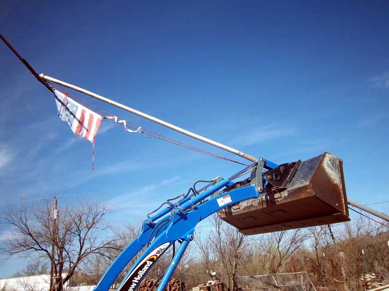

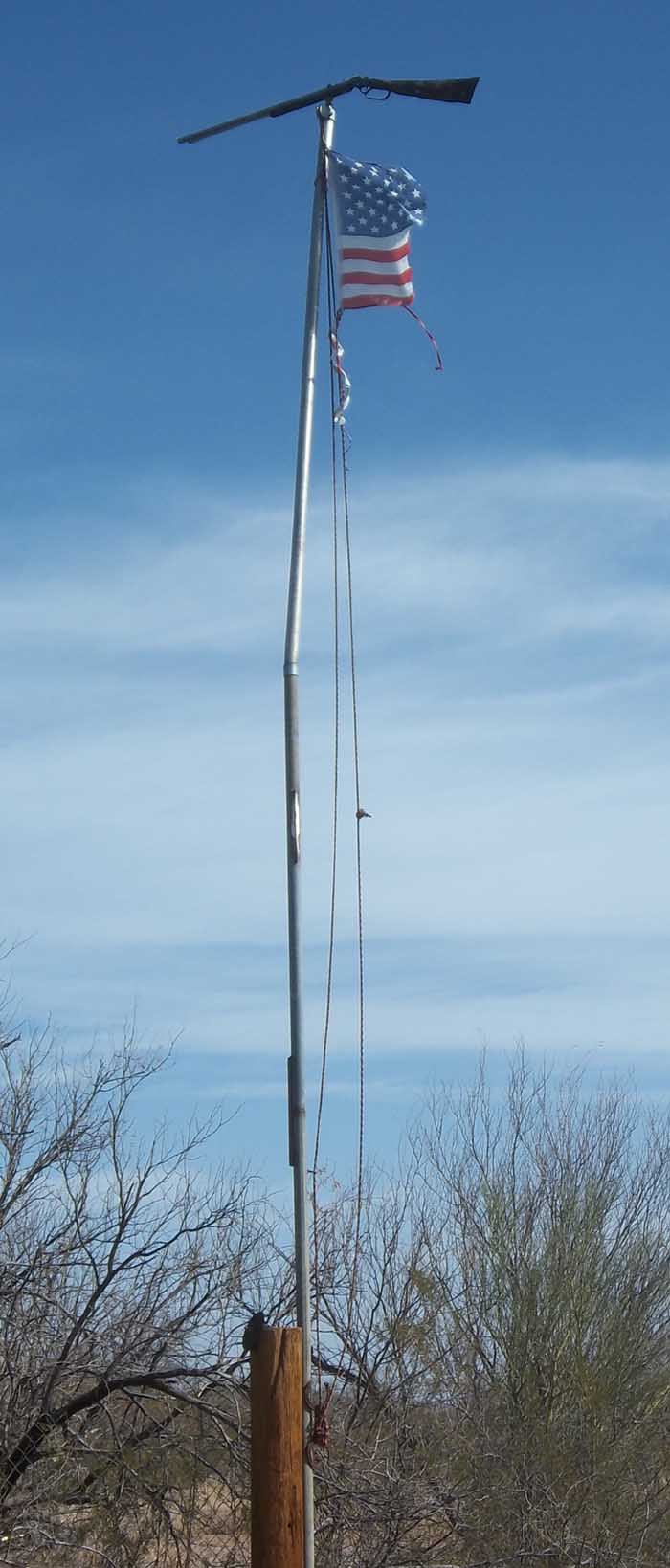

I've had some experience with a 30+ foot flag pole & high winds.
Your pole is going to be overloaded with 1 4x6 flag, 2 will be a disaster waiting to happen.
My pole is 2" lower & 1.5" top with all joints reenforced with welded on angle iron.
Had a 4x6 flag for a while & the pole swayed a whole bunch 2' maybe more.
still sways with a 3x5 but not near as much.
Lower pivot is a 5/8" bolt through an old power pole about 4' into the ground, top is another 5/8" bolt. The old power pole is very solid in the ground. No movement at all. Bottom bolt near the ground top a little over 6' up. No movement in that area when the bolts are tightened up.
Flag pole is much to heavy to raise by hand. I've had it up & down 3 times, with out help. By using the FEL on the tractor.
Have gone through as many as 3 flags in a year, usually 1 or 2. Current flag came from Home Depot & seems to be a good one, about 6 months old & still in good shape.
Hope the pictures will up load. 1 Picture is when I had a 2" aluminum top section. Too soft & it bent.

I don't believe you have a big enough footing with only 15 cubic feet of concrete. Two 6' flags make a pretty large sail.
That's 2,250 lb. of cement, I hope that's enough.
Thanks sparc.

I'm going to start with 2 - 3 ft. x 5 ft. flags and watch the pole carefully, before i consider a increase in size / load on the pole.
