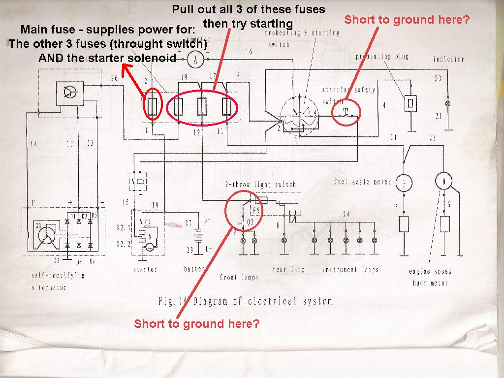

To find out if the switch is what's causing fuses to blow try these troubleshooting steps....
Is the switch mounted to metal or Fiberglass? If the switch is mounted to metal AND the case of the switch is shorting internally to +12 then, yes the switch can be bad. If the switch is mounted to Fiberglas (insulator) then the switch is most likely still good.
If swtich is mounted to metal - Try un-mounting the switch and have it "dangle" (case not torching any metal). Turn switch, if fuse still blows then switch is NOT bad....Whatever load is down stream of the switch is what's drawing more current than the fuse is rated for. Disconnect the glow plugs if it has them to rule those out. I suspect the starter solenoid is corroded internally shorting out windings. Disconnect the energize wire from the solenoid, turn the key several times see it the fuse blows then.
Does it have a clutch safety switch? (the schematic shows one) The clutch safety switch or one of it's wires could be shorting out to ground.
How many amps is the fuse that's blowing? You said it's blowing two fuses right? I can read the schematic, if the fuel gauge fuse is blowing then perhaps the fuel gauge is somehow shorted, I think you said that wasn't working anyway right? Perhaps that's why? Disconnect and tape off any and all wires going to the fuel gauge, to eliminate that drawing any excessive current. Through a process of elimination you'll find and fix it.

I rotated, re-sized and marked up the schematic you posted. Open it up full size to see markup notes.

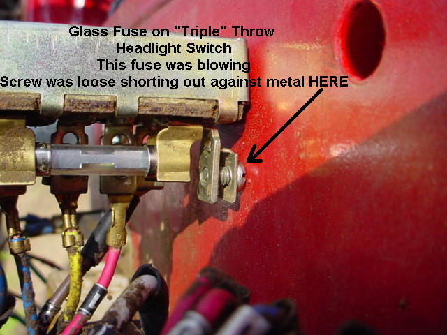

You might want to pull out the two position front and rear lamp switch. If the one it has is anything like what I've seen then those are notorious for shorting out. Attached is a pic of that switch. There is a screw, that when it comes loose usually dead shorts out to the metal panel it's mounted to.

Anything can be bypassed, Sort term you can try bypassing the clutch SAFETY switch to see if it's shorting out to ground. To do that, remove the two wires going to the switch (at the switch) then connect those two wires together and tape.
But before doing that try pulling out all fuses except the main fuse (see the schematic I marked up for info on that). Keep in mind the battery will not be charging as one of those fuses your going to pull is the charging circuit.
You keep saying it's blowing fuses as in more than just the main fuse. This make me believe something other than the starter circuit is the issue. Pulling those other fuses will confirm or deny that theory and go for there.

First of all, thanks for all the suggestions. Thus far I have pulled all the fuses except for one and I jumped the neutral switch per your instructions and the dozer started this weekend (after I jumped the battery). So I ran it for a few hours and put it away in a tent to keep it dry. I also bought a ford key switch but have not put it in yet. I will give you an update next week.
Note that prior to jumping the neutral switch it was still blowing fuses.
