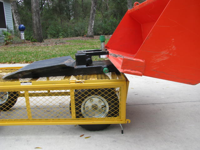

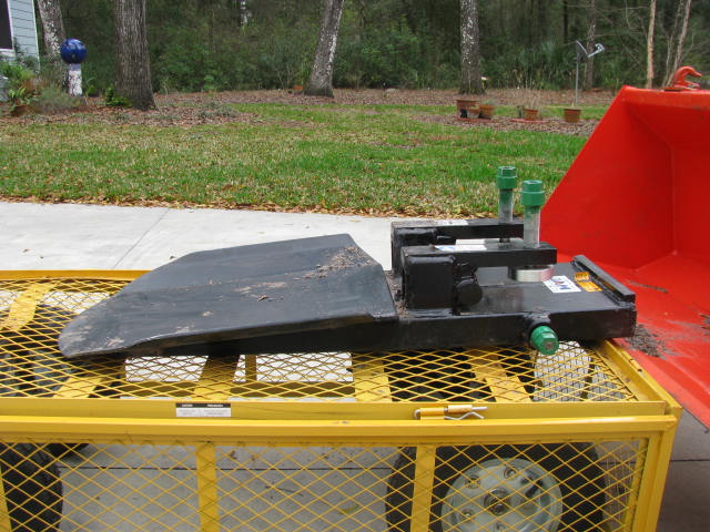

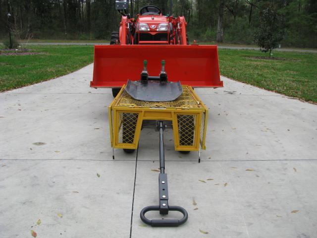

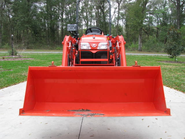

Here are some pictures of my used-two-days Bucket Solutions Bucket Spade.
My camera battery died after fourth photo --- RATS!
Spade is HEAVY, I estimate 100 pounds. My 33-hp Kubota B3300SU is not going to break it. Remained absolutely TIGHT during use.

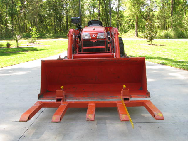

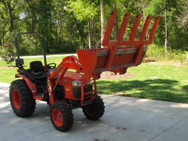

Here are photos of my Debris Forks.
Excellent accessory product for compact tractor bucket.
