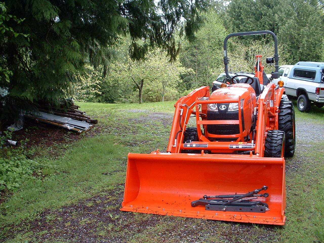

I have a 2011 Kubota B3300SU tractor loader package.
Kubota replaces a community-owned clapped out early-1980's Deere/Yanmar 750, 20hp.
The Kubota B3300SU is quite compact and maneuverable while having enough power ( 33hp ) to pull 3-5" wild Muscadine grape vines out of the ground and out of large Water Oaks. The (clapped out) 20hp Deere/Yanmar could not accomplish these tasks except on the smallest vines.
There is a lot of options these days for compact tractor buckets. Google "Bucket Solutions" and consider their $369 Quick Attach (Bucket) Spade. Perhaps you will not need a back hoe. I have this spade in transit and plan to post a video of it on Youtube digging out Mother Vines. Bucket Solutions also has quick attach/bolt on Debris Forks, which I own and use to scoop up vine debris and Water Oak debris into a MUTS dumping trailer, which I then pull to our community burn pile. The MUTS trailer is canadian built and of modular design. I use MUTS optional log arch, which displaces the bed, quite often for skidding heavy oak tree trunks over our community asphalt roads without road damage. I use a Wallenstein BX42 PTO drive chipper on the rear, to balance the FEL. I need to post a video of the Wallenstein chipping a 50' Muscadine vine in one slurp.
Relative to (indispensable) bucket hooks Google "Ken's Bolt On Grab Hooks" in Westminster, Maryland. I have two of Ken's grab hooks bolted on my bucket and one bolted on my cross drawbar and they are completely satisfactory.
Next, for what it is worth, one of the implement companies has THEIR direct comparison of the Kubota B3300SU and like sized John Deere 3032E tractor/loader package posted on Youtube. I found this Youtube comparison interesting.
My two minor quibbles about the Kubota B3300SU package regard storage space. I use a 20' X 5/16" chain with grab and slip hooks every time the tractor goes out. There is no place to wrap them on the Kubota between uses. So I carry them in a plastic basket mounted under the ROPS....functions fine but looks pukey. We have a lot of rattlers in my part of Florida. I like to carry a 1917 S&W .45ACP revolver loaded with shot shells on the job. For this I have bolted a "thin/flat" 40mm ammo can on the frame, beneath the ROPS, which securely carries the revolver and a couple tools. I have a bicycle water bottle holder secured to the ROPS itself with two self tapping metal screws. "Polar" insulated cycling container keeps half a liter of liquid cold quite a while. I wish the B3300SU had more designed in storage.
I hope this helps your decision.

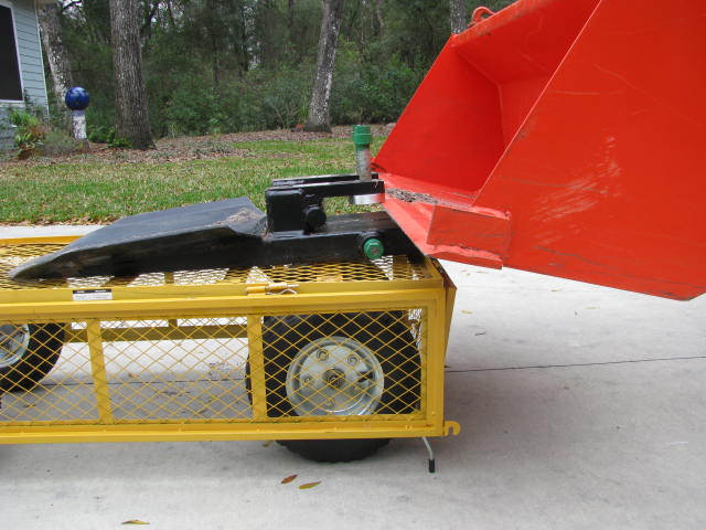

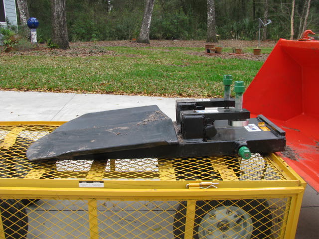

   / 30-ish HP TLB Thoughts #25

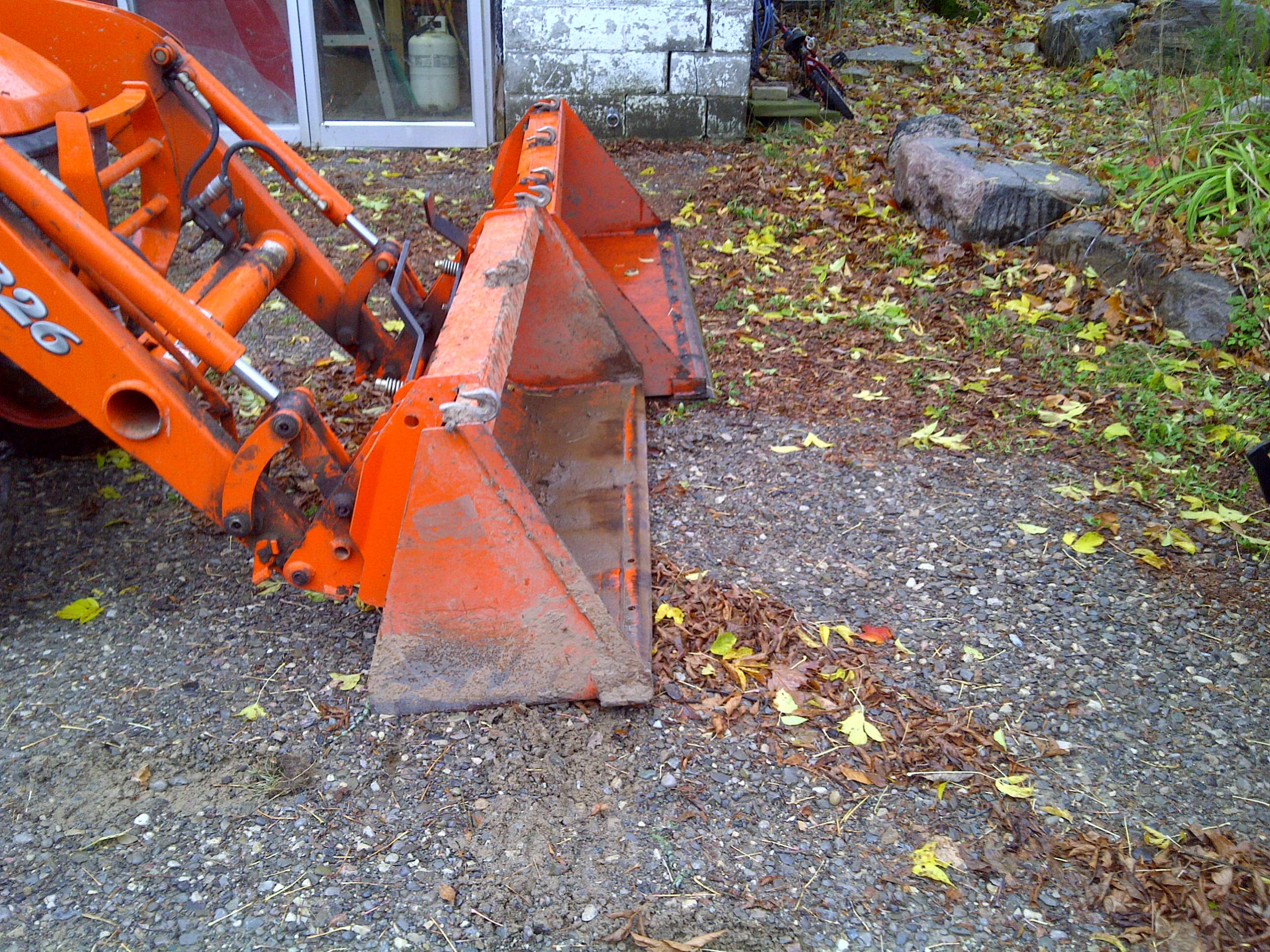

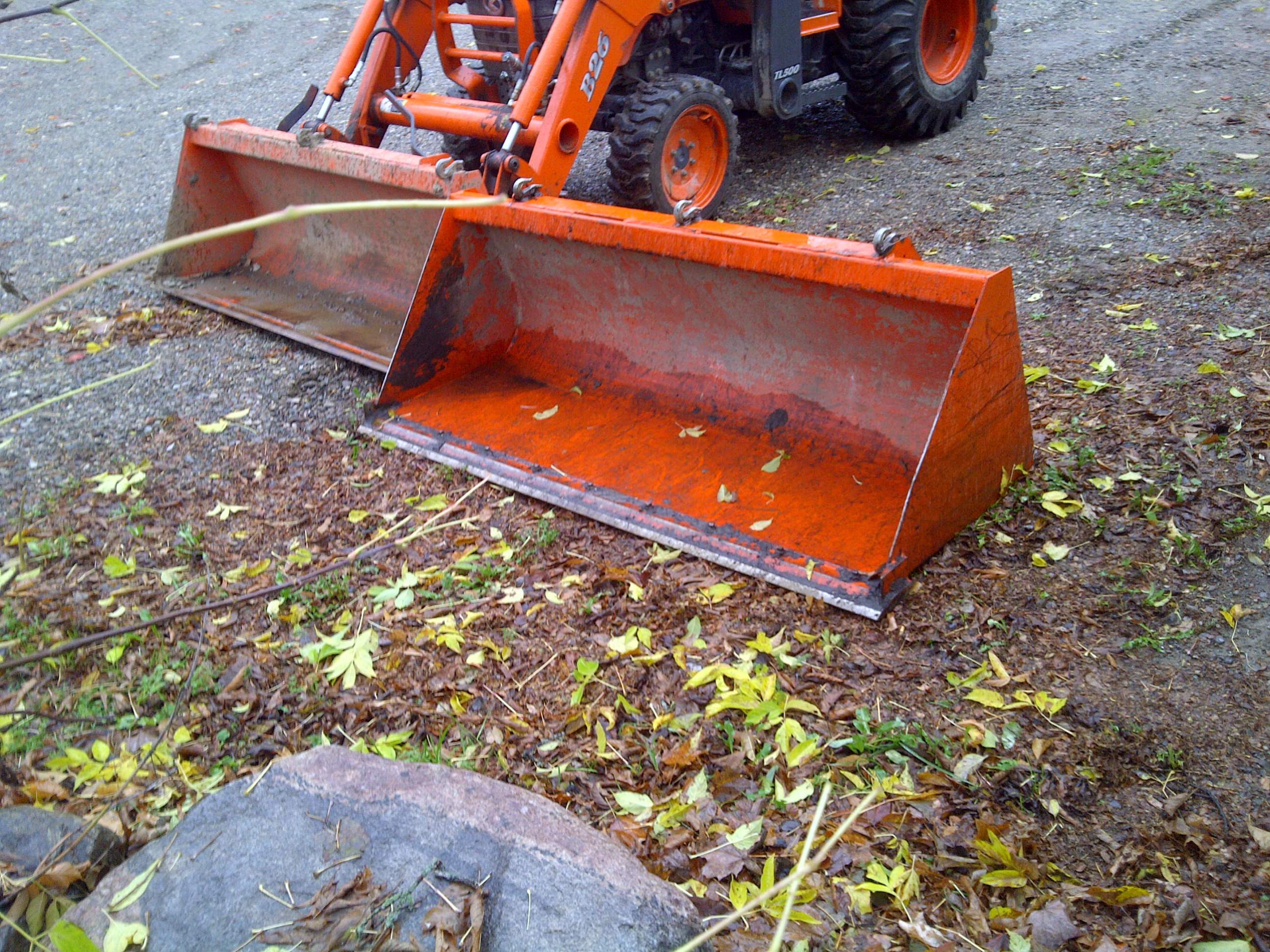

Here are some pictures of my used-two-days Bucket Solutions Bucket Spade.
My camera battery died after fourth photo --- RATS!
Spade is HEAVY, I estimate 100 pounds. My 33-hp Kubota B3300SU is not going to break it. Remained absolutely TIGHT during use.

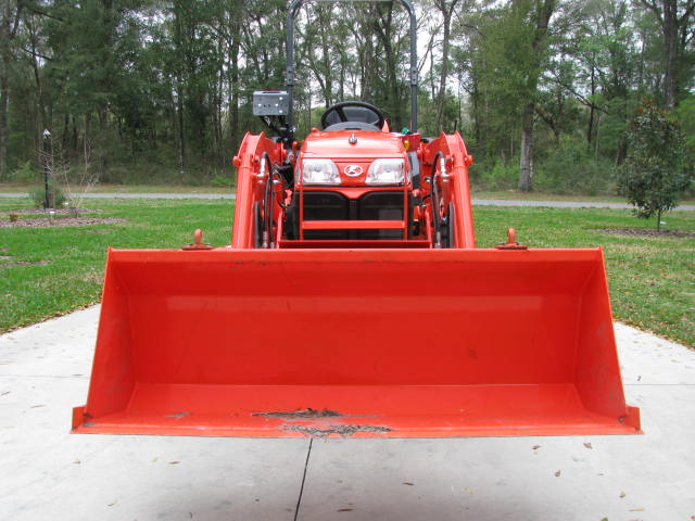

   / 30-ish HP TLB Thoughts #26

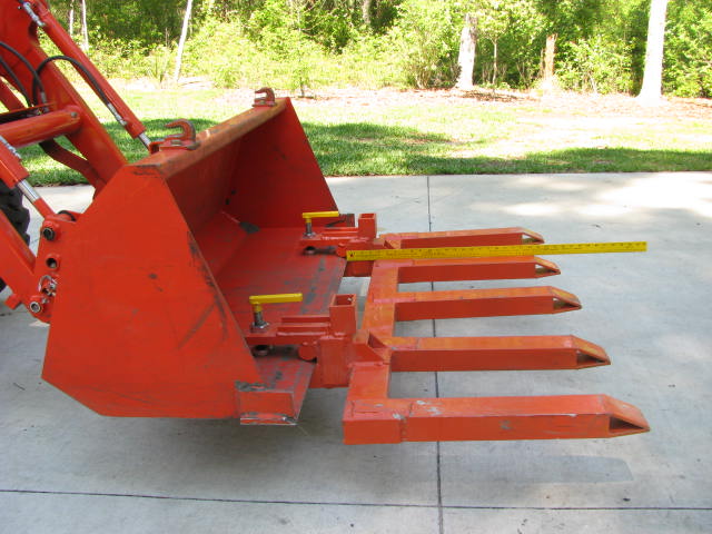

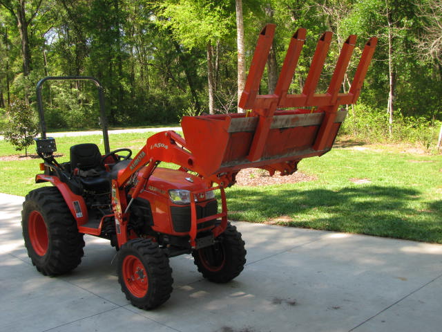

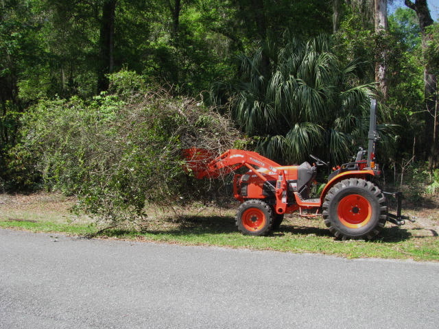

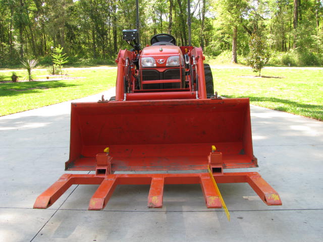

Here are photos of my Debris Forks.
Excellent accessory product for compact tractor bucket.
