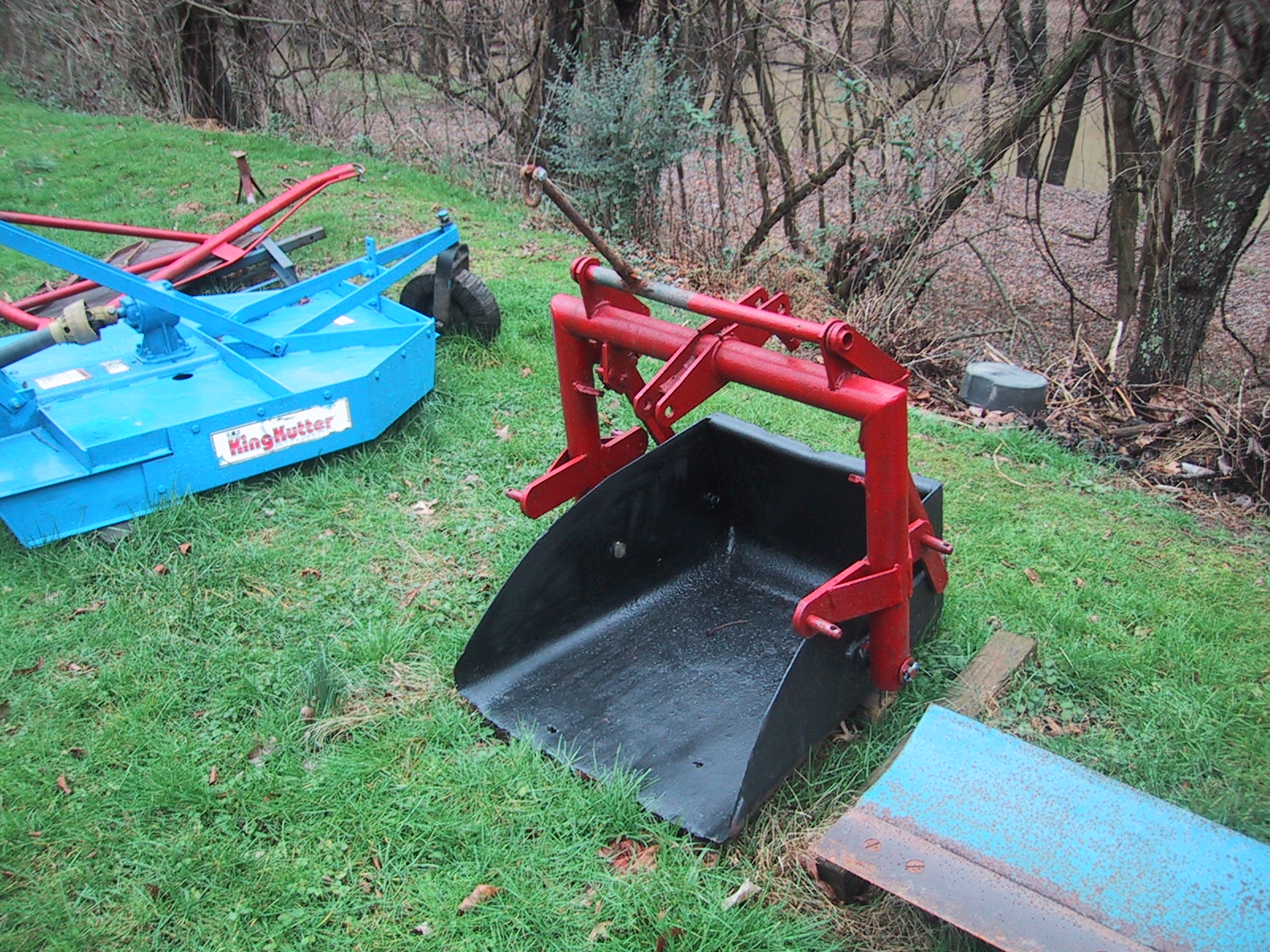

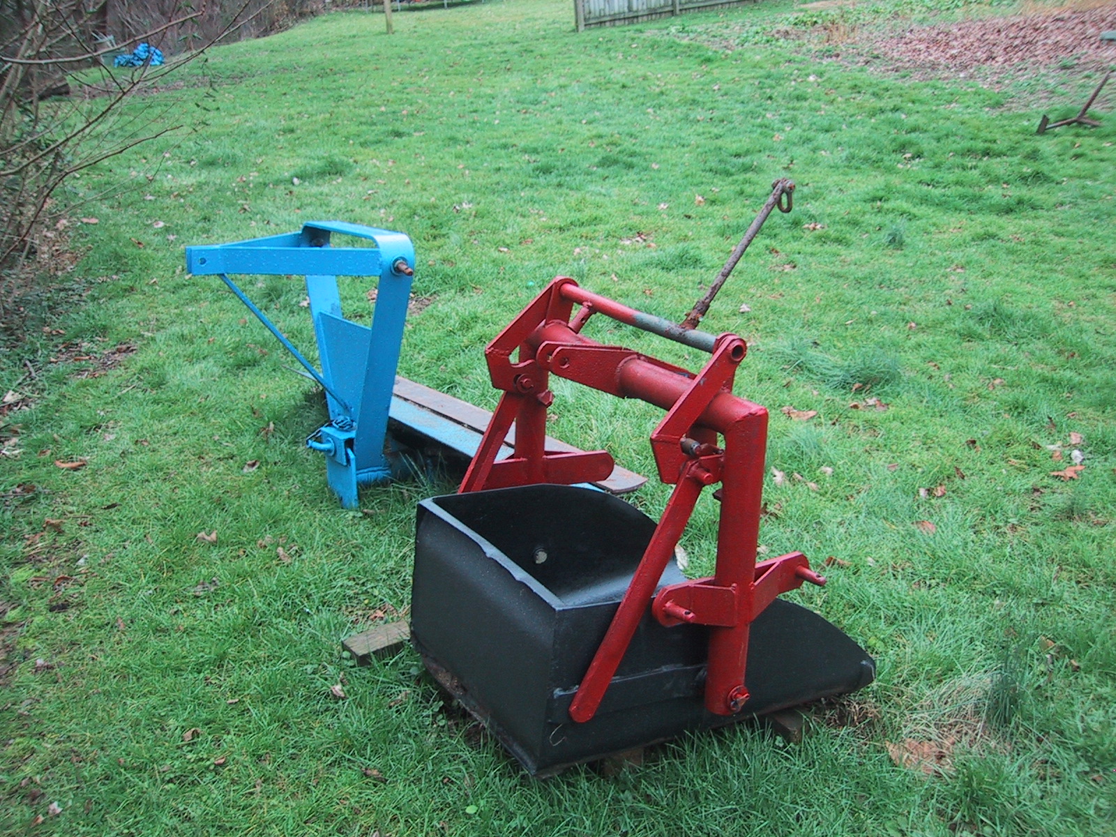

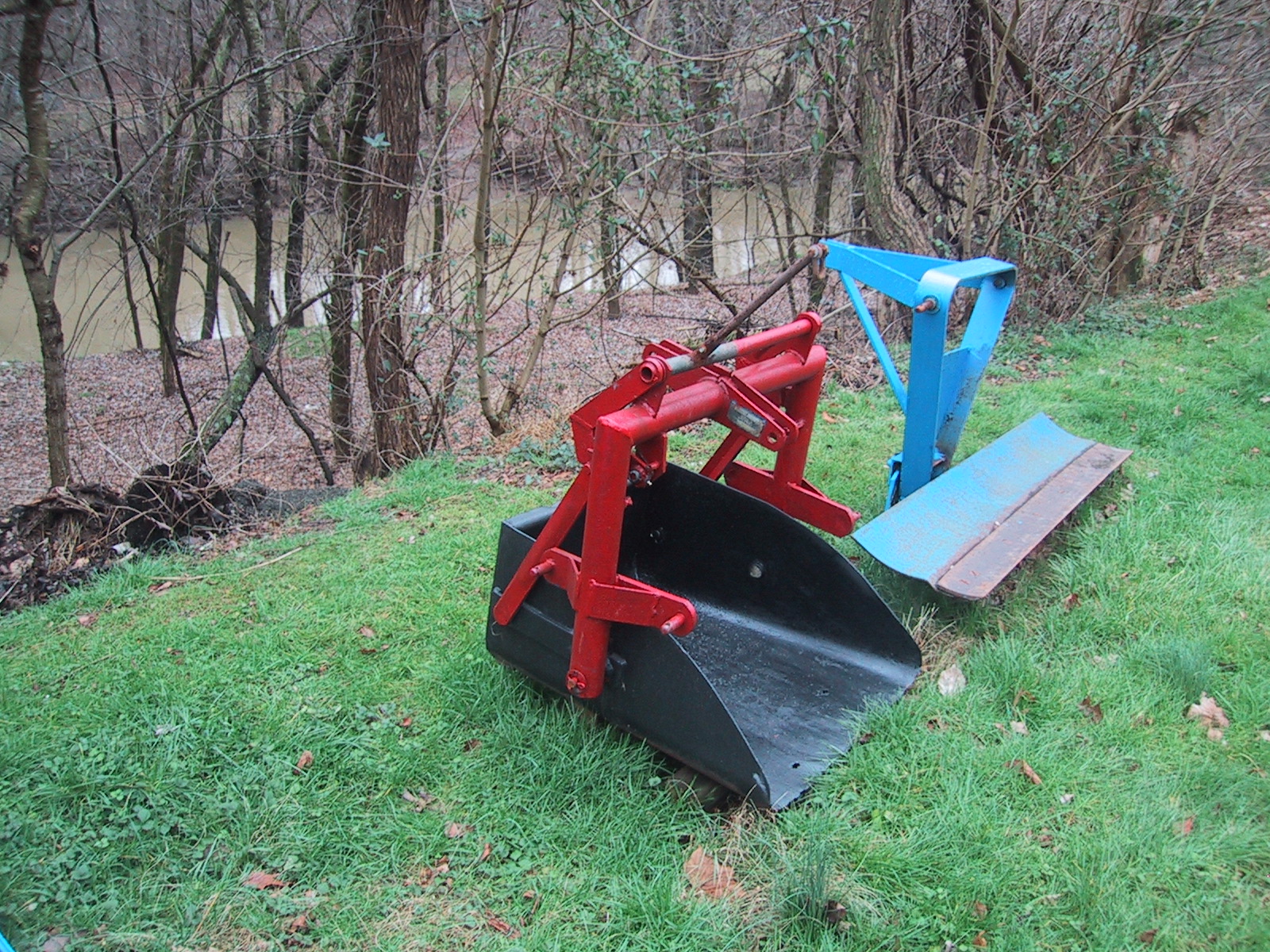

I have a Ford 706 Dirt scoop That I bought at the local junk yard for $20 spent $30 more fixing up . Sure beats a shovel all to way. Some of us don't have FEL .
