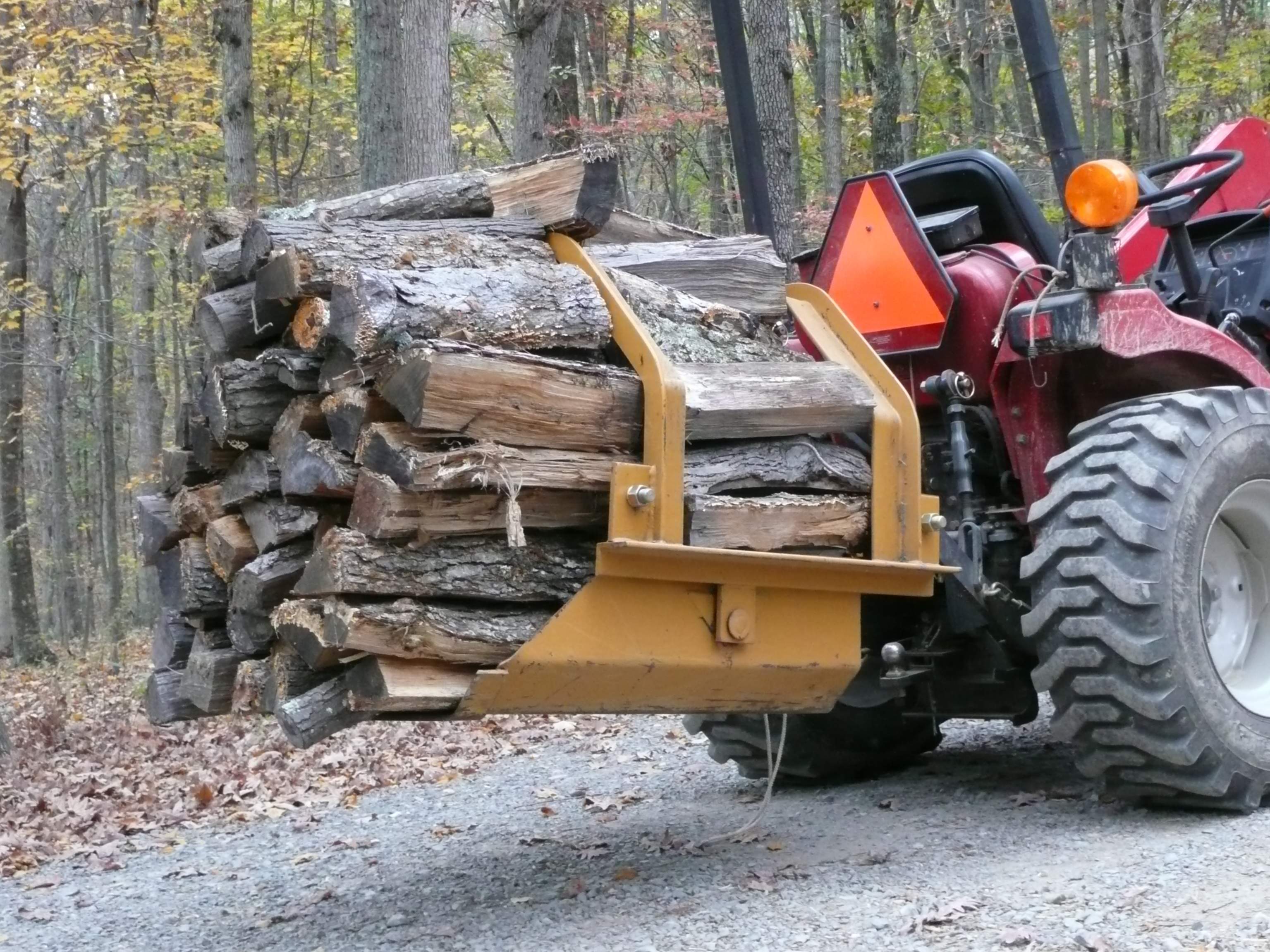

I have most of the implements I would ever want. Two that I would hate to be without are my rear blade and my dirt scoop.
My KK dirt scoop is about 7-8 years old. For many years before that I had a very similar, but much heavier Ford "pond scoop."
It is like a super wheel barrow and super tool carrier. If I were to estimate usage, I would say that it is on the back of my tractor about 30% of the time. My rear blade is also on about 30% of the time, and I use my draw bar with various trailered implements about 30% of the time. The remaining 10% of the time is used with a brush hog, box blade, post hole digger, plow, disk, middle buster, and backhoe.
The dirt scoop is like a super wheel barrow. The FEL is great, but the rear bucket is too. It is well worth the price.
