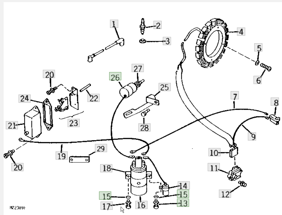

The engine was rebuilt 15 years ago and not a lot of hours on it. What rpm should I set idle? I do have the service manual.
   / 300 lawn runs 20 mins then backfires and dies #13
Old JD mowers that used the Kohler "K" engine (like Model K301, K321,, etc,,) have an ignition system with a coil, and a condenser.
Both the coil, and the condenser are susceptible to doing this stall thing when they get warm,,
#14
Yep it's one of those. Any tips on diagnosing?
   / 300 lawn runs 20 mins then backfires and dies #15
Replace the condenser,, then replace the coil,, ONLY use a Kohler coil,, or you will be replacing it again in 6 months.
These are not "digital" components,, they age, and fail, usually slowly.
Diagnosing is difficult for a newbie,, it is cheaper to replace the components, than learn ,,
replace the points, while you are at it,,

Any resistance measurements etc that can be done?
Any recommendations on sourcing parts other than JD?

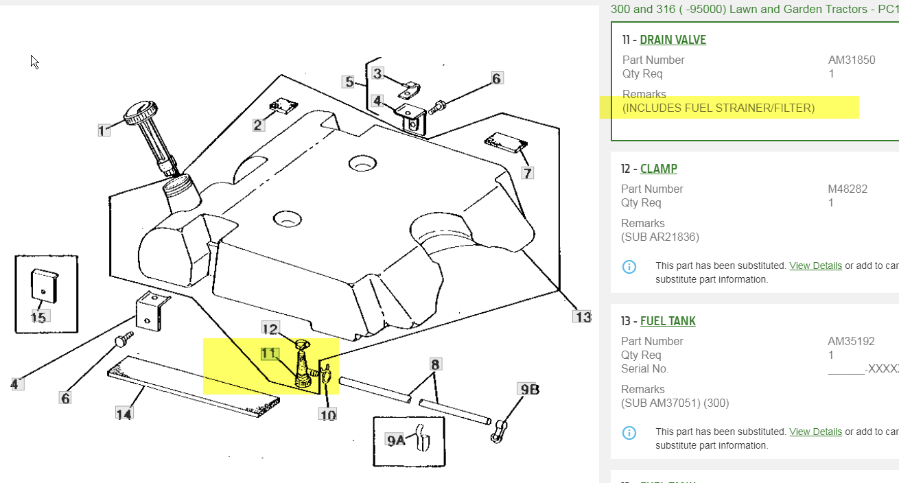

There is an in-tank fuel strainer that should be cleaned out if not done in the last few years.
I would replace the condenser.

fuel filter; looks to be part of the valve. I'll have to crawl under and have a look. It seems to run a good while, 15-25mins, before it sputters, maybe backfires, then dies. Visually I am getting a spark however.
   / 300 lawn runs 20 mins then backfires and dies #19
I think it's best to remove the seat & the fender so you can lift out the gas tank and access the filter!
At least that's how I have done it. I also added an inline fuel filter after the fuel pump.
   / 300 lawn runs 20 mins then backfires and dies #20
my first thought was also about fuel, it might only have "access" to 15 - 20 min of fuel in the line. check the fuel line and adjust the idle.
