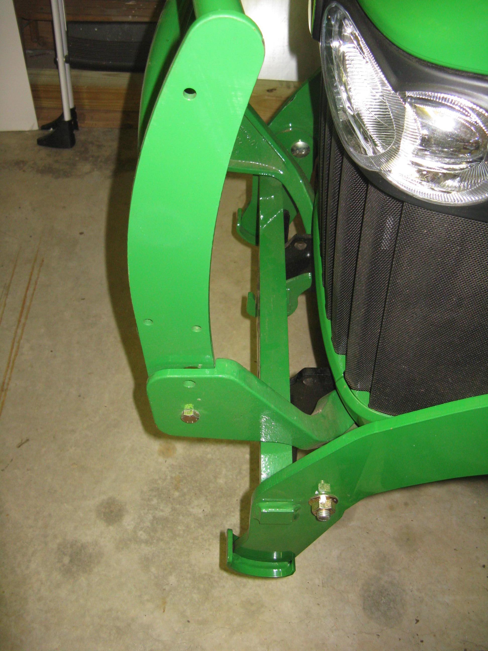

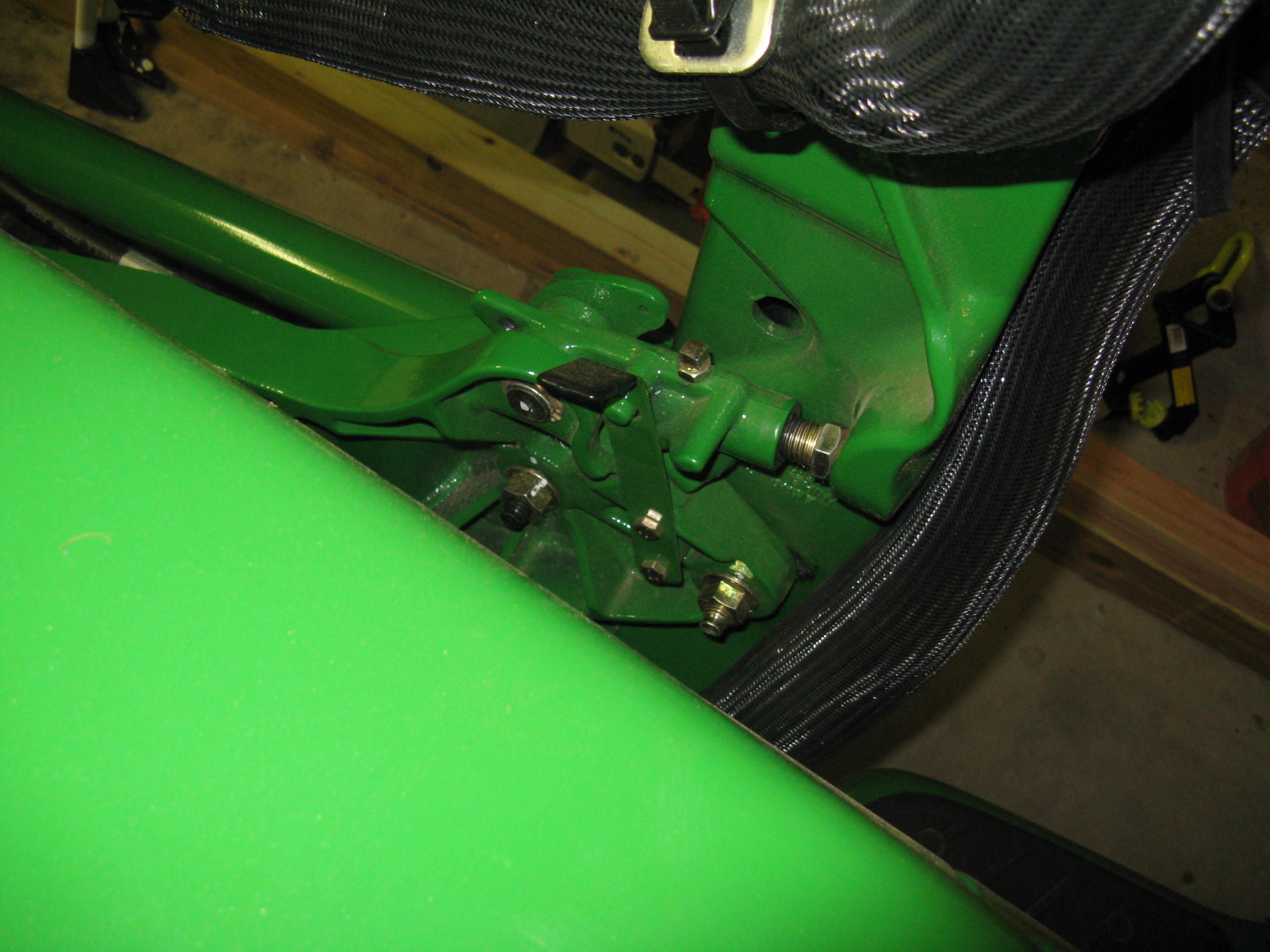

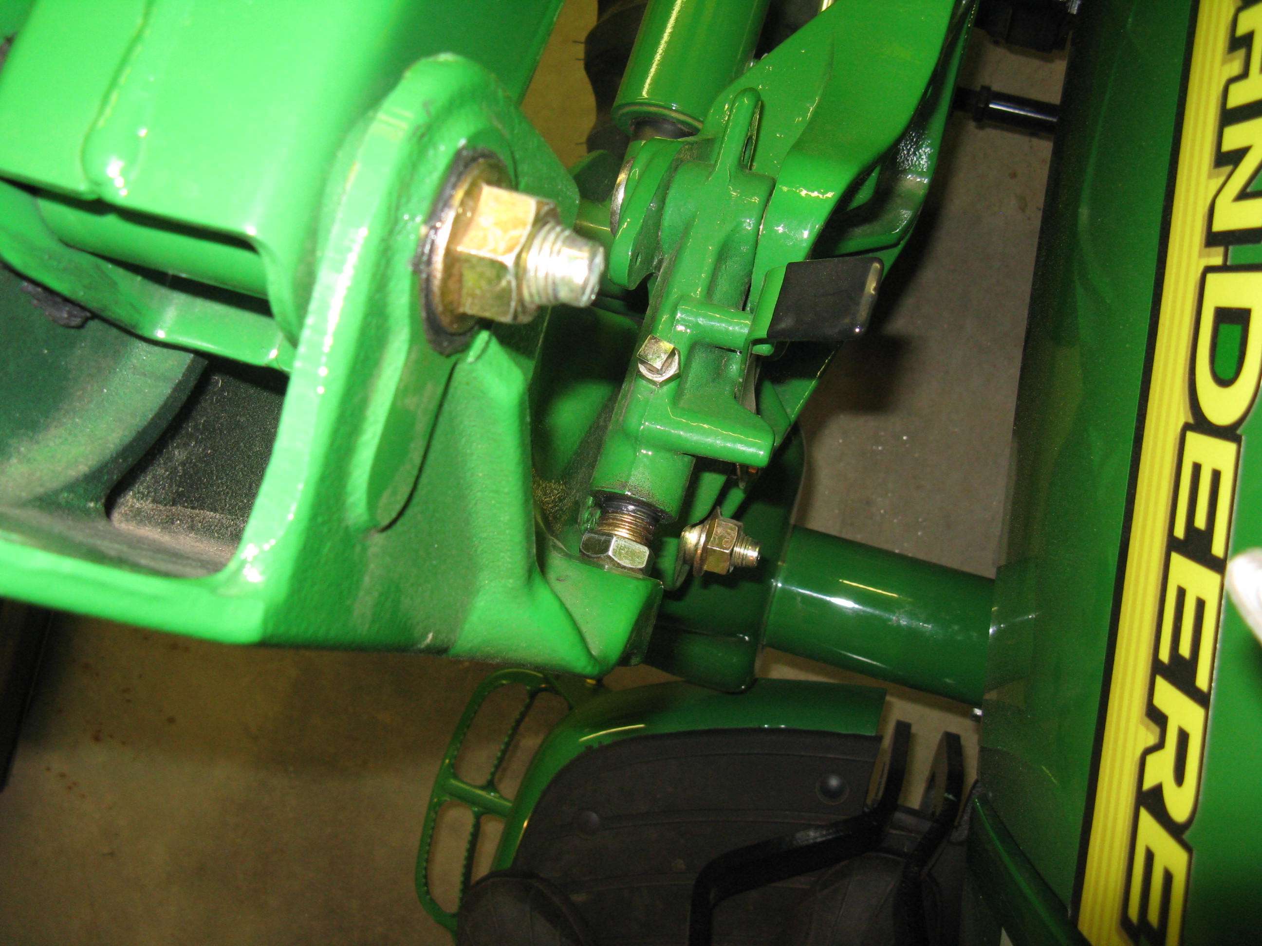

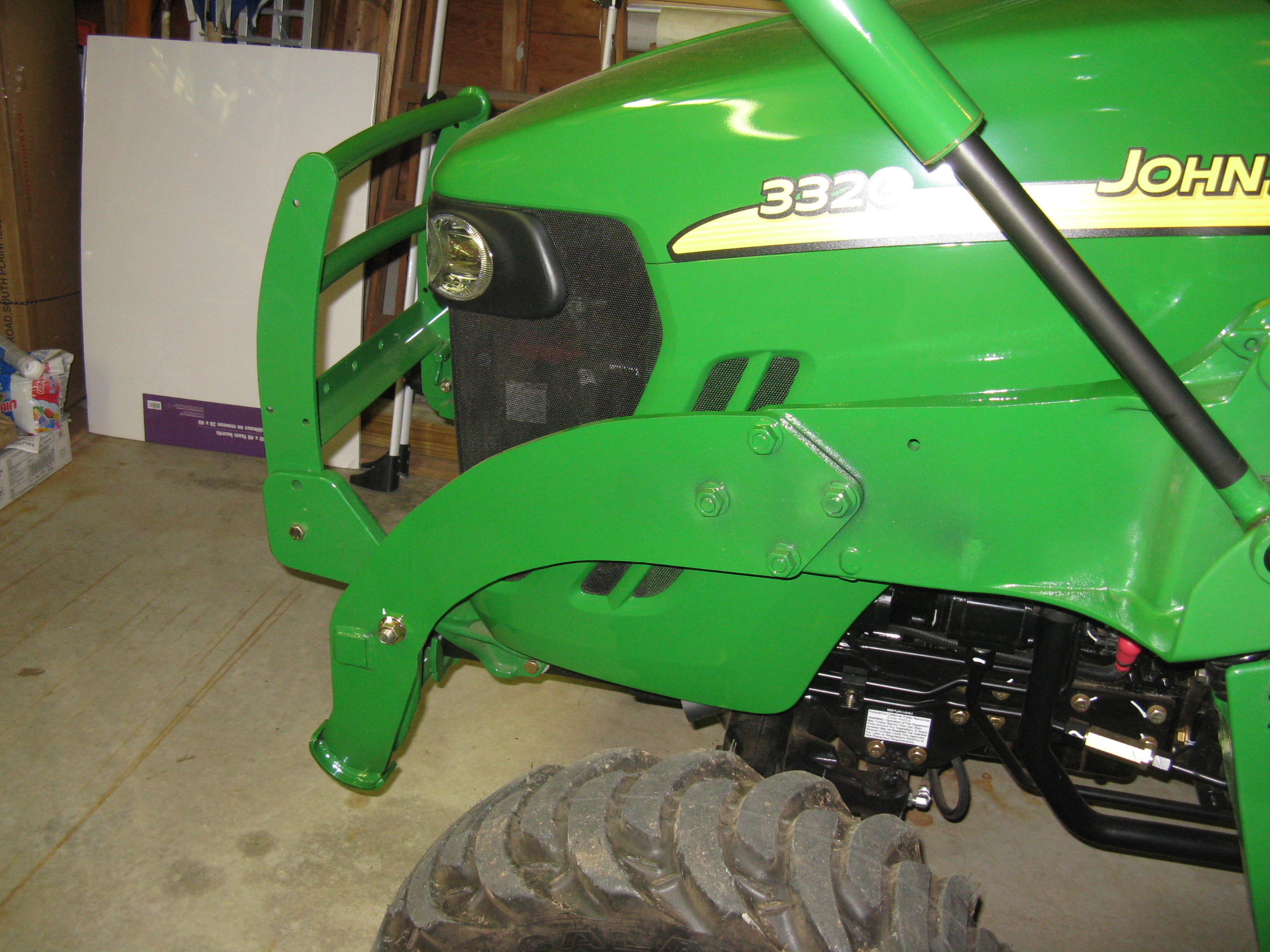

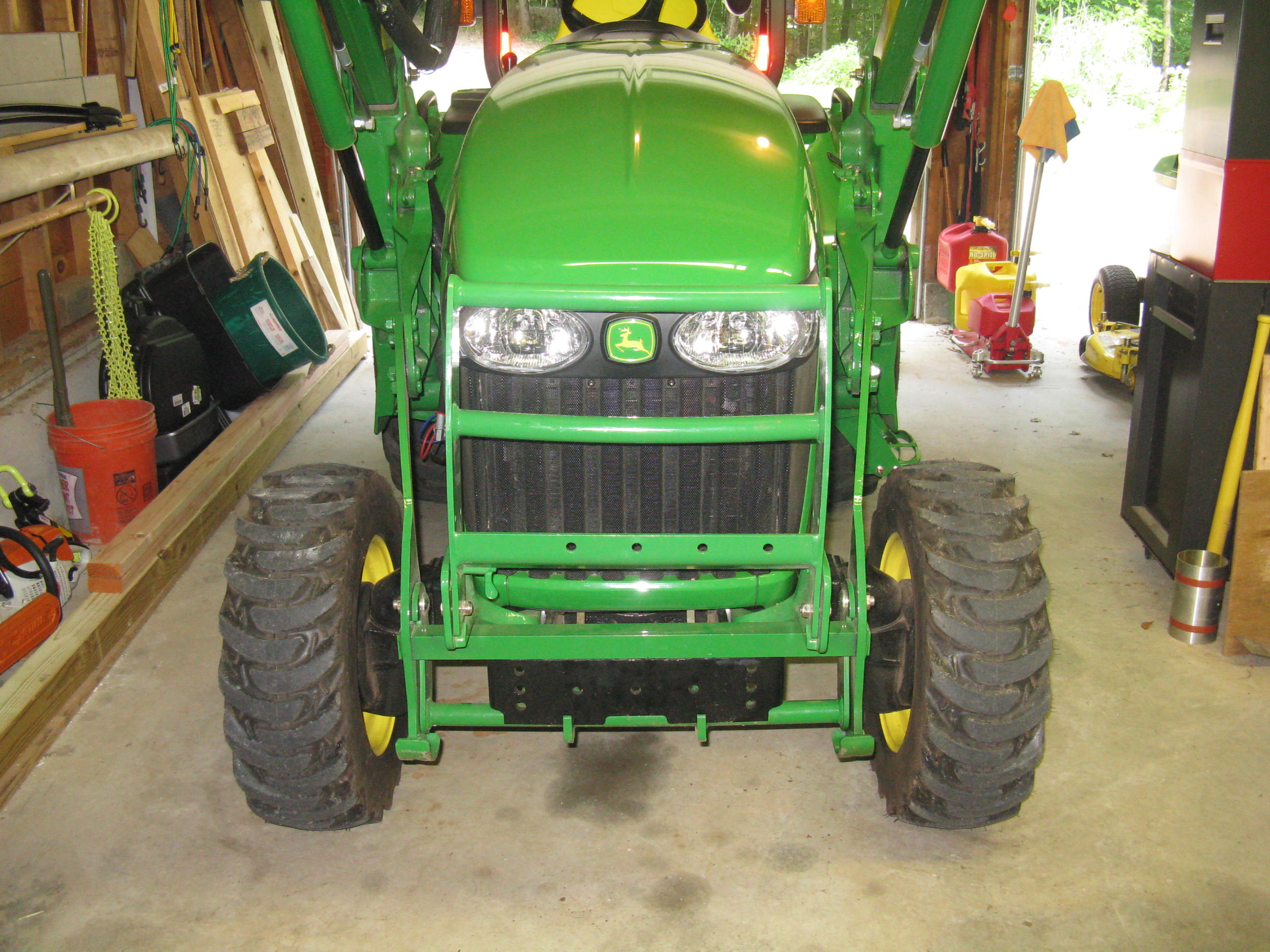

That big hit to corner of the loader may also put the loader booms and mast out of alignment. Check the front brace, it should sit square to the weight bracket and its face should ideally be flush with the face of the weight bracket. The steel brace connected by 4 bolts to the casting brace could be sprung. The bolt head adjusting screws at the loader mast need about the same length of exposed thread. The loader frame could be out left to right as well as up and down. If your new timer rod is not going in easy the frame alignment could be the problem. If things go together ok, but the standard bucket on and adjust per the loader's manual instructions. Good Luck!
