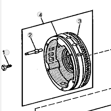

I have a 3010 gas that needs a clutch. I have the tractor split and the clutch pack seems to be stuck to the flywheel. It is attached by 6 bolts. They came out no problem but i cant get it off. I have been spraying it with pb blaster and tapping it with a hammer but so far no luck. Any tips?
/ 3010 Clutch Help #2
My guess is pressure plate assembly is dragging on pins(item 2). IIRC pins can get notches worn into them from pto utilization.

/ 3010 Clutch Help
Is this the pin you are referring to. It should slide off of that pin correct?

/ 3010 Clutch Help #4
No the pins I referred to are in flywheel hidden from view behind pressure plate.

/ 3010 Clutch Help #6
By the looks of your picture, I would say the tractor has been sitting without running for quite a while? Appears to be a lot of rust there. There are some holes in outer rim of flywheel that you might be able to pry outwards on clutch plates, but you may have to get aggressive with a heavy hammer and punch around outside of lip of pressure plate cover. The three pins you have circled do go all the way through to the flywheel. Cover may be tight on pins and all of the plates behind the cover may be rusted to pins also.

/ 3010 Clutch Help
I was able to get it off. It was definitely stuck on those pins. Thanks for the help. Now im wondering if i should replace the rear main seal. It doesnt appear to be leaking. I would like to but looks like i need a special tool to install it. Any thoughts?
