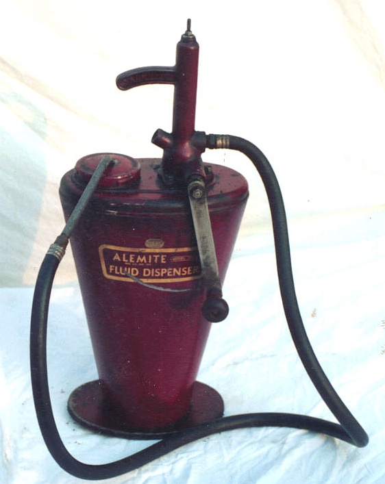

I have a vintage Alemite fluid pump that still works great. Each crank of the handle pumps about a pint. When I changed mine, I went through almost all of three 5-gallon pails of hydraulic oil. The tank on the Alemite pump has a large fill cap so dumping oil into it is easy.
Mine is same as this one but with a few dents in the tank. It's a time and mess saver.
