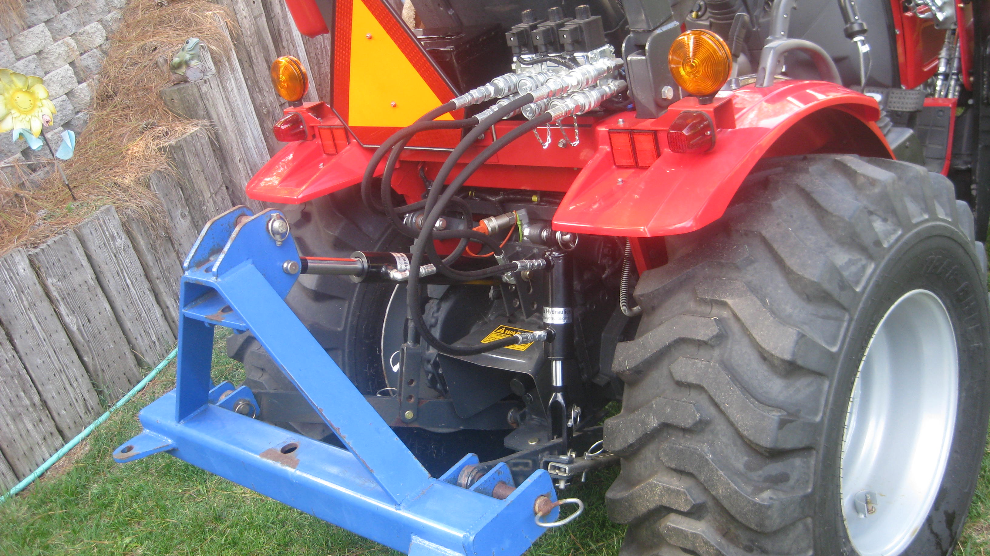

The rear remote can be installed by removing the seat and the plastic cover panel on the inside of the fender. Not that big of a deal. If your dealer is willing to sell it to you for $850, get it, that is a deal. This valve also has the float function with it, it is a good clean setup. If you think that you will ever need more than one remote, then forget about it and just go aftermarket. Mahindra only offers a single rear remote option for their 16 series tractors. Morons :sigh:

What on earth would you be doing with a compact tractor to need two sets of remotes? There is a simple system made by Fasse that will turn you single set into a dual

You're joking right? Number one, that Fasse multiplier WILL NOT work on the Mahindra 3215 factory rear remote, been there done that. The swivel pieces that are suppose to allow you to plug into a single set do not get you enough adjustment to plug in.
Second, top and tilt cylinders for the 3pt hitch, there's 2, an angle cylinder for a rear blade or landscape rake, there's 3. Ever seen a rear blade that has 3-4 rear hydraulics on them? There would be 6. I current have 4, for top & tilt, angle and offset for my landscape rake and hope to purchase a Land Pride RBT3584 some day. I will use the angle and offset hydraulics on that also. ;)

A HUGE part of the hydraulic thing is education. Most people simply do not know about it. My experience is that a lot of dealers don't know-understand, so don't want to sell the stuff, plus it is costly. I have had dealers flat out tell me "why would I want to sell a top & tilt system to a customer that I have to charge $2000-$3000 ,when I can sell them multiple implements for that much money? The customer is better off with all the implements."
REALLY, so now ALL the 3pt adjustments have to be made manually and that ends up not being made at all after awhile. Everyone ends up with "that's good enough syndrome" simply because they are tired of the tiresome process that it is to make a manual adjustment. When if they had hydraulic adjustments, it takes fractions of a second and all they have to do is touch a lever with their finger tips.
