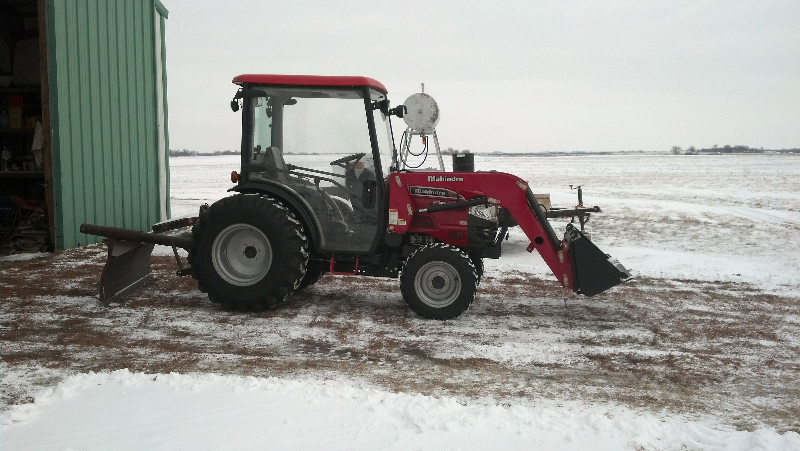

Far from a guru but I can give you my 2 pennies as I use a 3016 for logging and snow removal. If you put a 4010 next to a 16 series, it will dwarf the 16's. They use larger tires and are a bit wider as a result. I cannot fathom how Mahindra takes measurements but you can see with your own eyes the size difference. A 25% slope is 1/4 of 45* angle. Not too bad but I have these degrees at my place and would never consider a load of any sort in the fel. or the 3 pt. traveling sideways on these slopes. You may want to explore getting a logging winch if stem gathering becomes prevalent.
The 30 and 36 are the exact same frame. I believe the extra hp on the 36 aides in pto driven equipment and hydrostatic drive. The 3016 gear I have digs virgin soil very well especially with a tooth bar which i would consider getting if you are doing cuts. As you cut, grade degrees become less of a factor as you create "flat land" for the tractor to travel on. I am also leaning toward the 4010 and price has little to do with it. I simply think it is a stronger machine. One thing to look at on the 4010. If you look underneath, there is a "protrusion" right before the rear axle that looks like a 3/8" screw hanging down. I don't know why it's there but I would look to fabricate a plate of some sort to protect this area of the tractor that looks like it could get damaged quite easily in the forest.
A snow blower is a consideration if you are having to remove snow with few "dumping" areas on your property. I use a snow pusher fabricated to my bucket attached to logging hooks along with a rear blade. One bolt on each side and I can log when there is snow on the ground w/o the side plates. This has worked well for me to clear a 100' driveway and about an additional acre of landing area. I have areas to put snow but with snow pack approaching 3' here, I am getting concerned about where I'd put another 20" event.
Be sure the 4010 is indeed a new left over and not a return. I also purchased my tractor as a "left over" that was used around the dealership but it had only 6 hrs on it. Whatever you get, be sure to load the rear tires.
