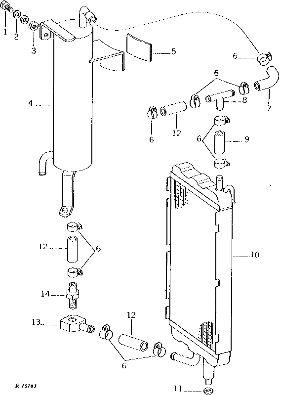

I'm running a post pounder on the tractor and I have to let the hydraulics catch up every so often otherwise I can tell the front pump is starving for fluid. What I would like to know is if the rear pump pumps the hydraulic fluid into a tank that feeds the front pump or if the rear pump pumps hydraulic fluid through a line directly to the front pump? The reason I'm asking is because if there is a tank that feeds the front pump then it may be possible to expand that tank to hold more fluid so that the front pump doesn't end up starving for fluid. If there is a front tank, where exactly is it located?

I have no access to JD 3020 service manual but IIRC trans pump output is closer to 5 GPM than 11 GPM. Hyd oil reservoir is similar to parts key 4 in photo. If I was operating post pounder I'd suggest to return oil to fitting by hyd filter in 2nd photo that has hyd hose connected to it. Attaching to this fitting puts oil from post pounder into rockshaft return line leading back to frt hyd pump.
