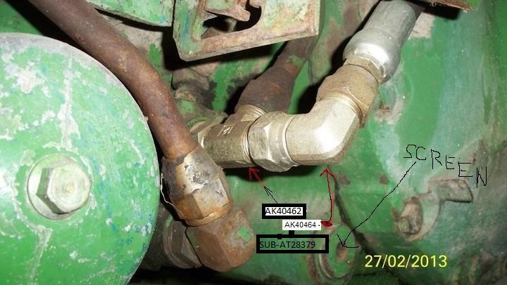

Why don't you plumb your tractor following the photos I posted and I'll bet your post pounder problems will stop that is if post pounder valve is in reality a closed center valve???? To lower cost you could supply hyd pressure to pounder from tractor scv and return the oil to rockshaft oil return line where hose is attached in this photo. AK40464 in photo subs to AT28379 Fitting 37 DEG. FLARE SWIVEL 19.39 USD which along with a set of quick disconnect fittings will put you in business for a lot less than a pto pump.
Its most definitely a closed center valve. I'm thinking about plumbing it as you suggested. My main concern is that it might not dump the hydraulic fluid fast enough. The pounder uses an oversize return line. They don't plumb it in to the hydraulic return, and instead dump into the reservoir, so that it can evacuate the fluid from the cylinder fast enough to drop the weight. So I'm not really sure what would happen if I plumb the return line as you suggest. Any thoughts on that?

If your pounder valve is the convertible type OC to CC & vice verse there's a seal on the inside that can blow causing CC valve configuration to revert to OC. I've witnessed that numerous times in the past on JD FEL valves. My knowledge of post pounder hyd's is very limited so I can't intelligently answer your question BUT IMHO a large return hose is installed for a reason.
