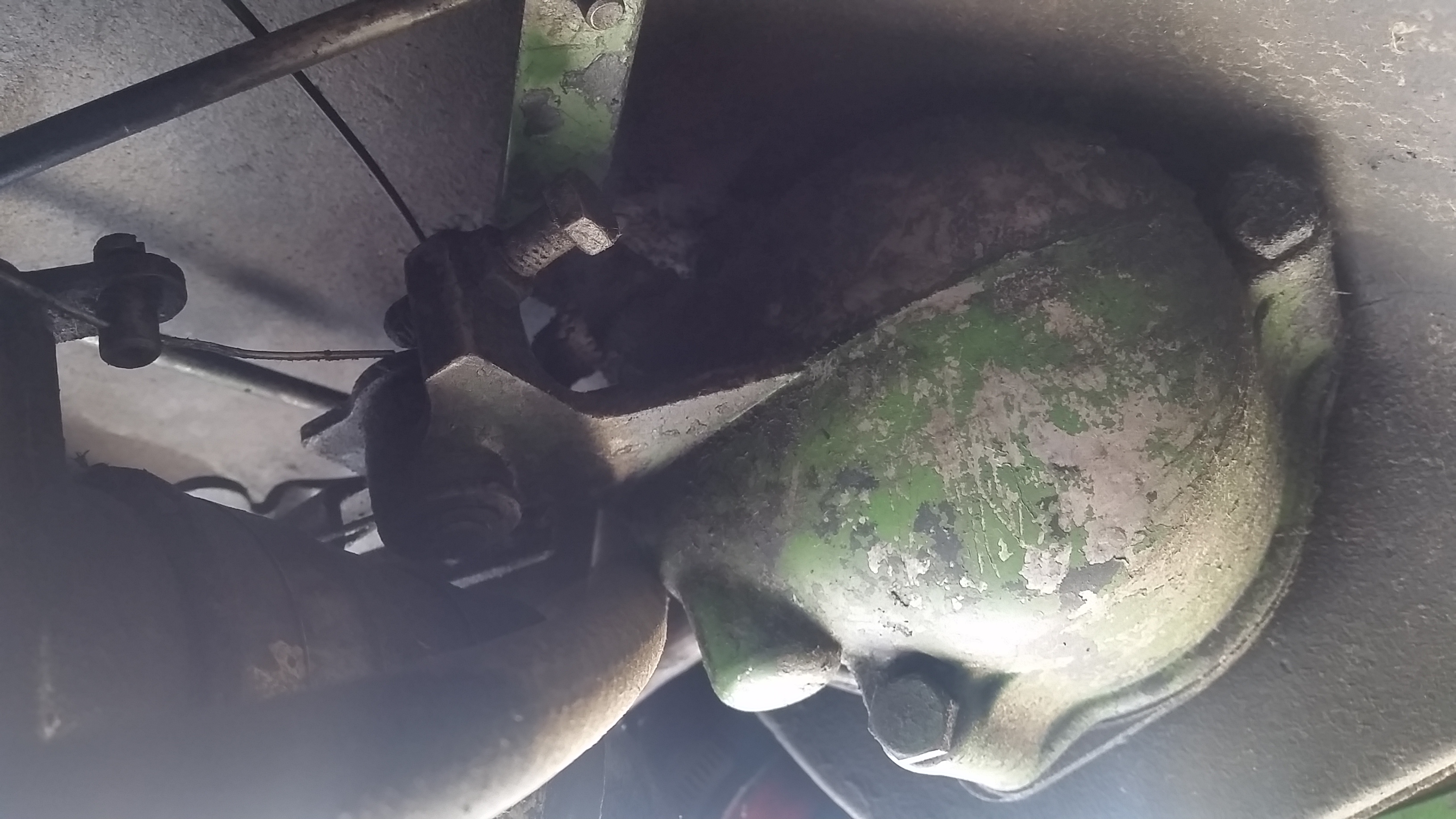

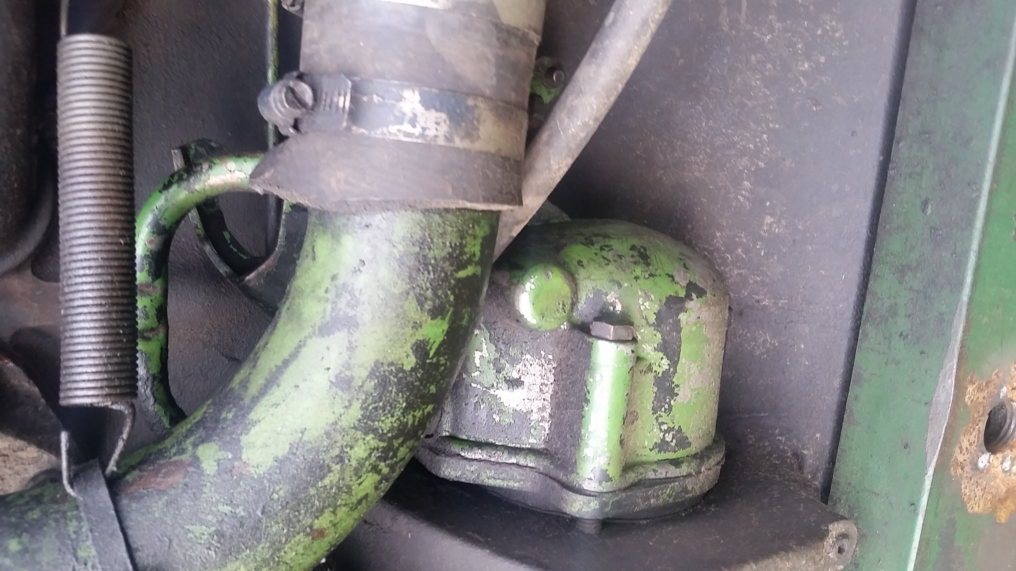

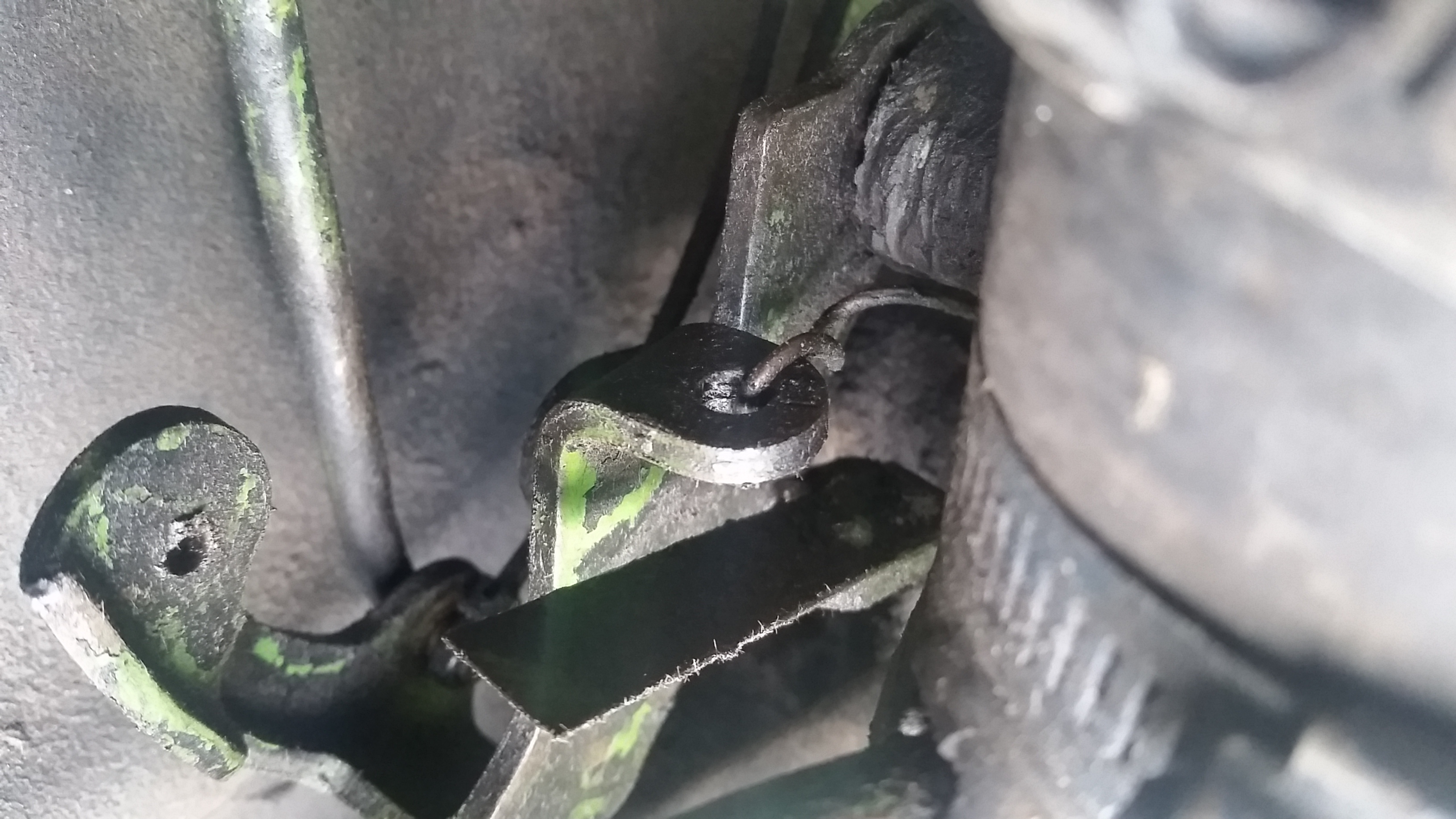

My throttle linkage came apart in the field and I can't find the missing pieces or even know what they look like or where they go. It is working now but not correctly. I've searched JD parts schematics but can't find the right one. On the website I've found the linkages from console down to engine and where they meet the carb but nothing from the area where they turn 180ー at the front of the engine. What is this part that they are mounted to, I'm sure that will help me find the correct pictures. Thanks. 20160809_075136.jpg

You said "carb" so assume gas, not diesel.
The "part" is likely the governor.
You can look at parts at jdparts.com to get an idea, but probably not the location to hook things up.

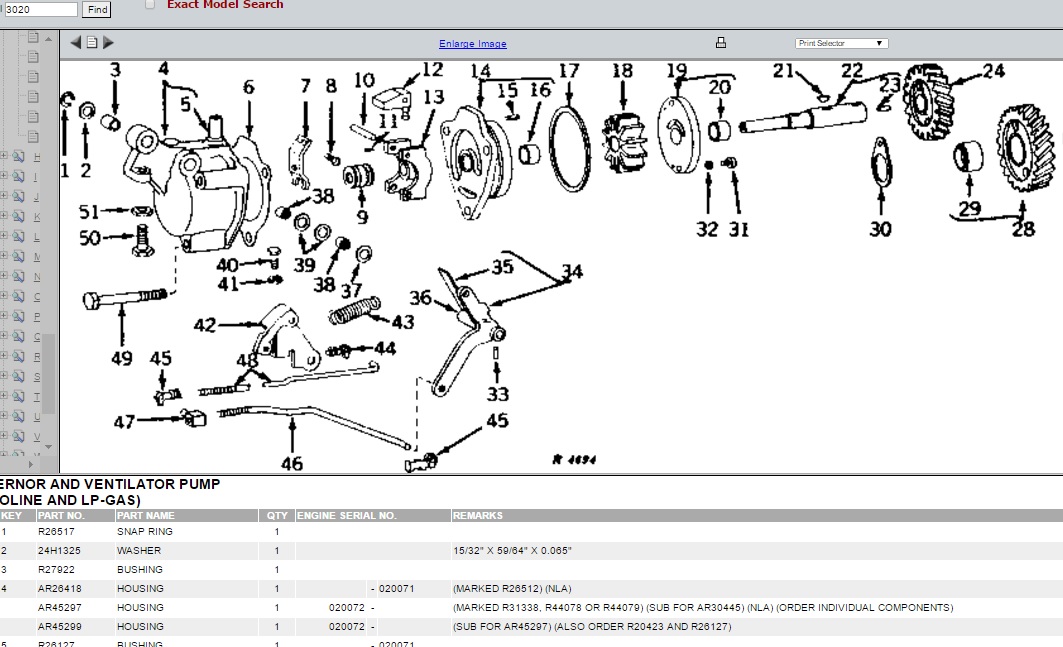

What I found on that site..

Yup you nailed it! Governor is it, and yes it's a gas, forgot to mention. I do use jdparts .com but its hard to find certain things if you dont know what jd calls it or in my case, you dont even know what youre looking at. Thank you, this will help me a lot!
