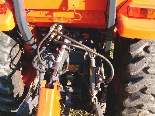

Has anybody installed a hydraulic top link and side link kit on the 3040 or other tractors with the 2 remote rear valves? Where did you get it and does it work well?

I would call Mark at Carter & Carter Machinery. He posts here and is a TBN sponsor. I added a hyd. top link to a 3440hst for a customer and he liked it. I think Mark can get you set up.

The standard top link on your 3 point hitch is replaced with a hydraulic cylinder.
I have CCM top link and tilt cylinders installed on my unit.
I highly recommend a hydraulic top link. I use it every time I use the machine.

Pardon my newbie ignorance, but why would you need a hydraulic cylinder for the top link? I must be missing some great piece of wisdom here that's obvious to all but blondes like me.

I have 30 hours on my 3040 now and know just enough to be dangerous. That said, I can see a value to the hydraulic top link in situations where you want to change the angle of attack with certain implements such as a box blade. Otherwise, you have to get off the tractor and manually adjust the top link. The HTL is not necessary but would be very nice to have.
