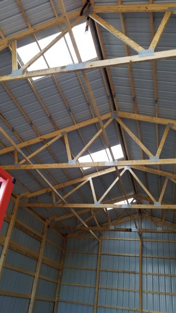

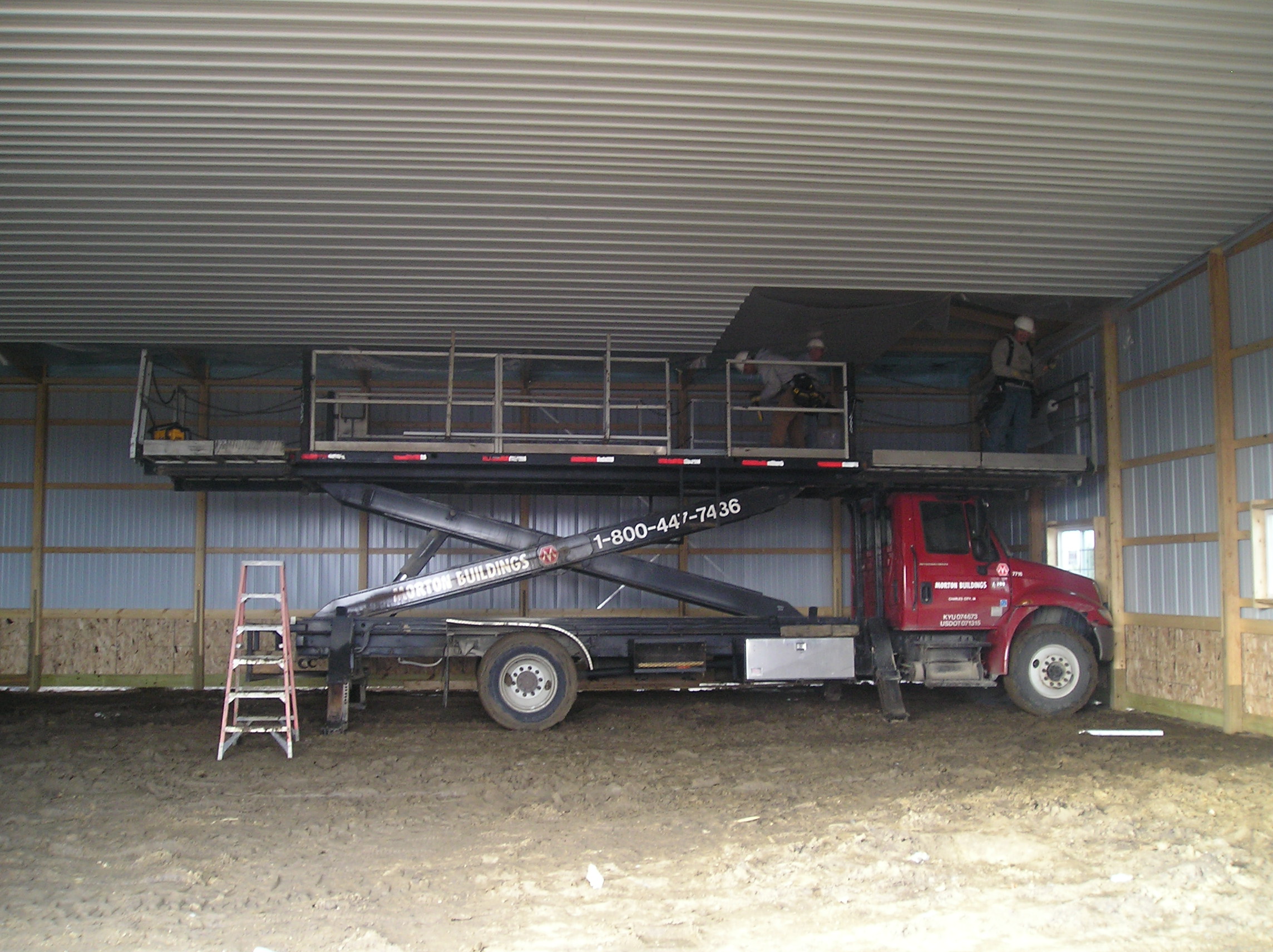

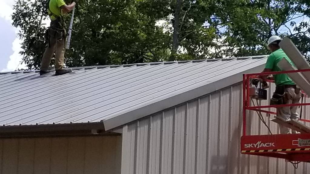

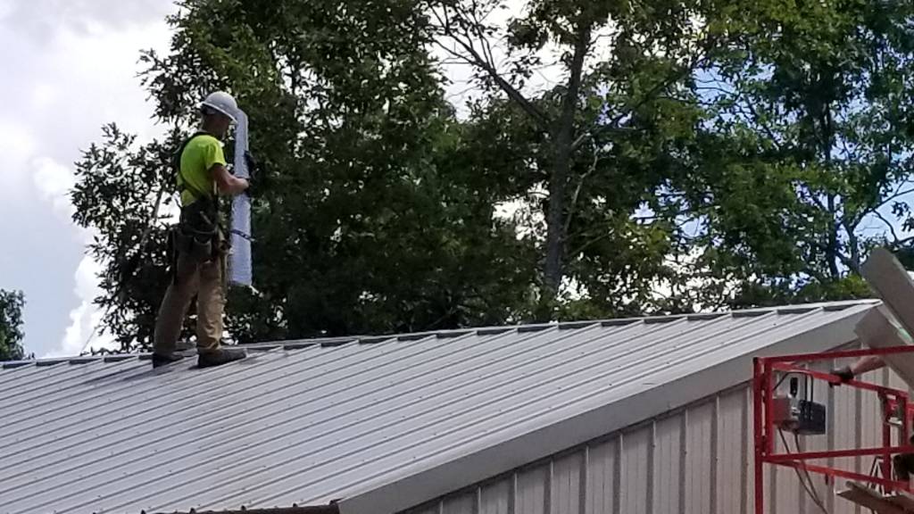

...Keep in mind that the metal roofing has ribs on 12" centers and spaced 24" apart. You are going to have 12 screws per 2x4 purlin and 10 purlins which would give you 120 screws per 10' bay. 50 year warranty says it will work !!!
The design of the metal roof panels when fully installed equally distributes the dead load over the supporting members...
   / 30x50x16 pole barn construction
#32
Thanks for explaning it in simpler terms than I did !!

I wonder why all truss rafter buildings aren't built with 10ft span using 2x4 purlins? Definitely cheaper!!!
Not sure what you mean. But building houses you have to add the weight of the plywood decking,shingles etc. and drywall,etc.
   / 30x50x16 pole barn construction #40
I should have been more specific. I wonder why all pole buildings aren't built with 10ft span using 2x4 purlins?
