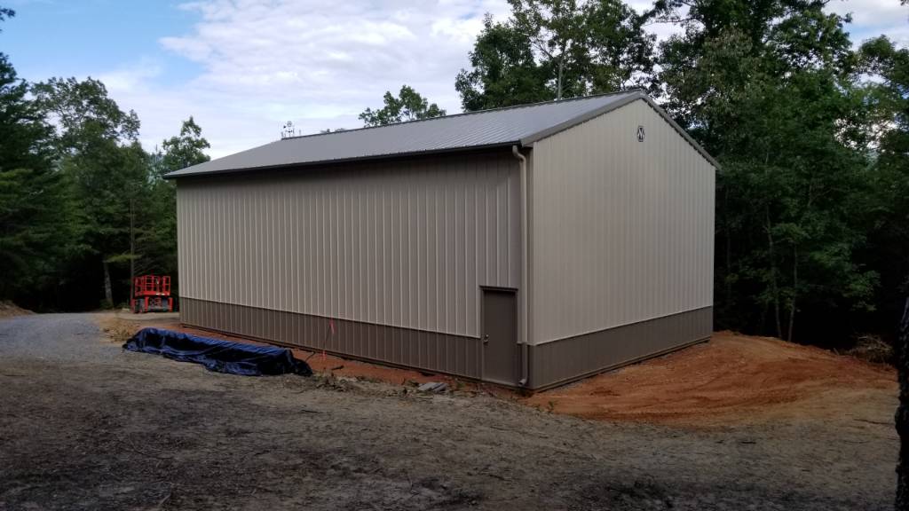

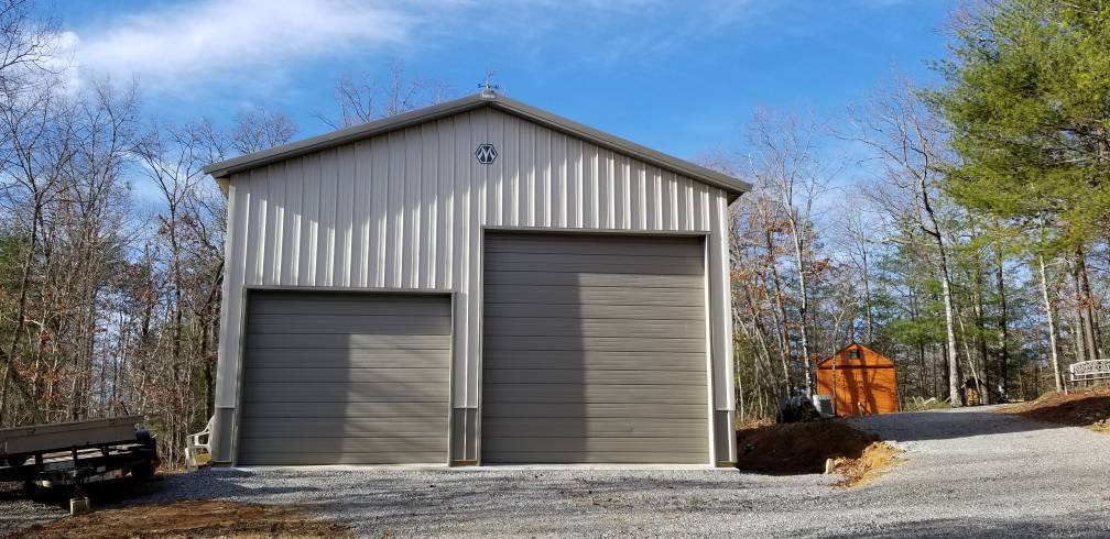

It looks fantastic and will give years of enjoyment. My only suggestion was to do whatever you think you may do now before moving in!
