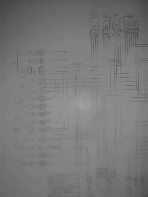

The pick circuit for the relay goes from the PTO switch - relay - 10 amp fuse in the fuse box. Looks like a green wire from switch to relay and a yellow to fuse. I need to hit the hay, getting hard to focus. Get more information tommorow.

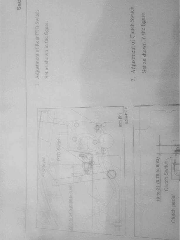

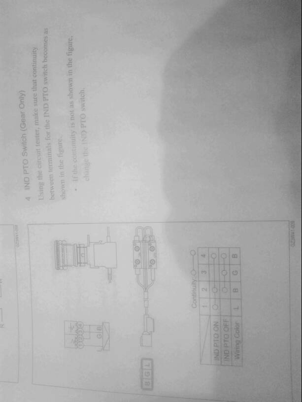

Here's how to test the PTO switch also the adjustment of the rear PTO switch if yours has it.Hope these help. 201805110745431000.jpeg201805110758011000.jpeg

I checked the fuse and it was blown. I thought it was good since the dash light came on.
Thanks for the help.
