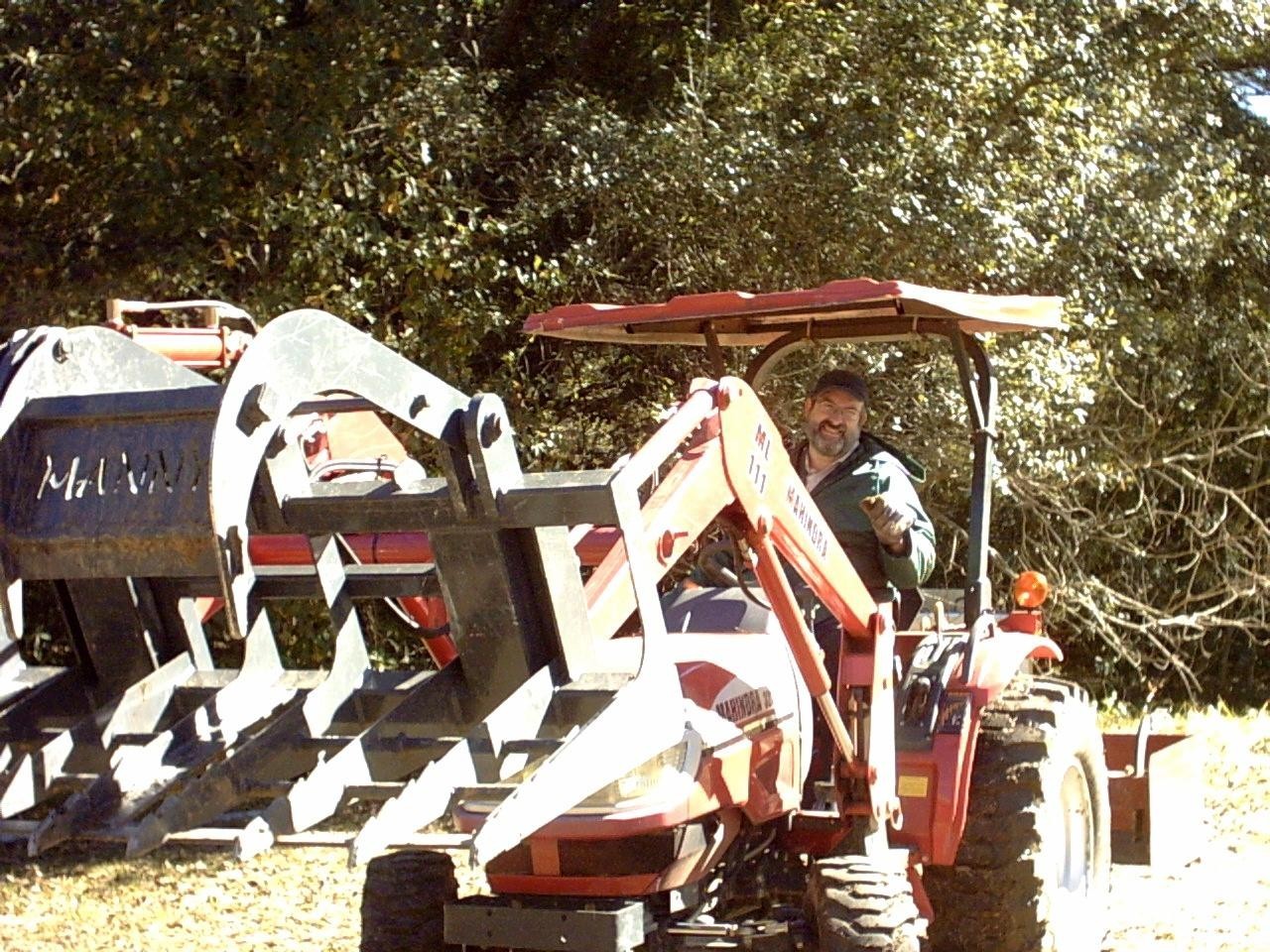

Well i am thinking that it is the solenoid, won't know till i can get to it. I was at my mom's tonight where tractor is at moment. Of course it was dark, couldn't hardly see it with a flash light. Will have to remove bracket to electric fuel pump to get to it,as it seemed to me. To answer a few questions seems to have a gallon or two flowing out of electric pump. No trash in strainer. Warranty over about a year and a few months. I have been pleased with the tractor. Done most every thing i've put in front of it. I am a drafter for small company in lower Alabama. We have a plasma cutter for which i setup a grapple to cut out of 1/4" plate. I just used mild steel. I made a deal with one of our welders and cut 2 sets out of a 5' x 10' sheet, gave him second set of flat plate pieces for his "green" tractor to do welding. Was able to get 11 fingers for the bottom part and 4 for the top. Even cut some of the parts to make my own skid steer mount bracket. Throwing a mix of some 3/8" plate and bar some 3" x 3" tubing I have a very usable grapple loader. Toward front of lower fingers, running across the width is a 3/8" x 3" flat bar that basically is parallel with the ground. The small semi-pointed tips were the doubled on each side to make them 3/4" thick. So far it has worked very well. The weight is around 400 lbs. Was using grapples at my mom's. There was a dead pine that came down to clean up and some other stuff while it was there. I don't think my problem is too serious, at least i pray and hope not. It's just the inability to work on it when I would like to. And my fingers are not that tiny either to reach into those small spaces.

The solenoid is one sealed unit. The wires leading to the plug seem to be operating as they should, while I had the solenoid off for testing I found the "run" side was inoperable. I can only take it that it is dead/broke within housing, can't find break in wire. But, since the "start" side works I used it to at least get "Manny" on his own feet. To answer your question of "Manny" my wife wanted to "name" the tractor when we got it, and around that time we watched "Ice age" the cartoon, "Manny the moody mammoth" came to mind. If you want to know who did plasma "artwork" that was just my drawing, part of what I do at work. Thanks for kind words on my grapples. They helped me clean after Ivan.
And Ivan was the earlier sloppier tractor? ;)
I am not very steady at free hand cutting with my plasma torch, so I
have to use guides and templates. Was your lettering done with a
template or free hand?

As far as "Ivan" all jokes aside, it was one messy hurricane. People even here not far from me still have some evidence to remove. Some people are even a little emotionally changed by it. As a matter of fact. I don't like to think of it myself.
The plasma cutter at my work is a computer driven plasma table. I draw in 2 dimensional (2D) format which is then converted to CNC operations for the cutter table. So no, I wouldn't have a steady hand for cutting either. I do like working with it though, your only boundary is flat plate and imagination. Hope I covered everything, once I start one of these long explanations I forget what my previous posts were, HA HA.....
And to dfkrug as much as you seem to fab there are some kits you can get to use hand held plasma cutters such as "torchmate" that is just one but i believe there are others. Many you just build your own table to put their gantry upon.
