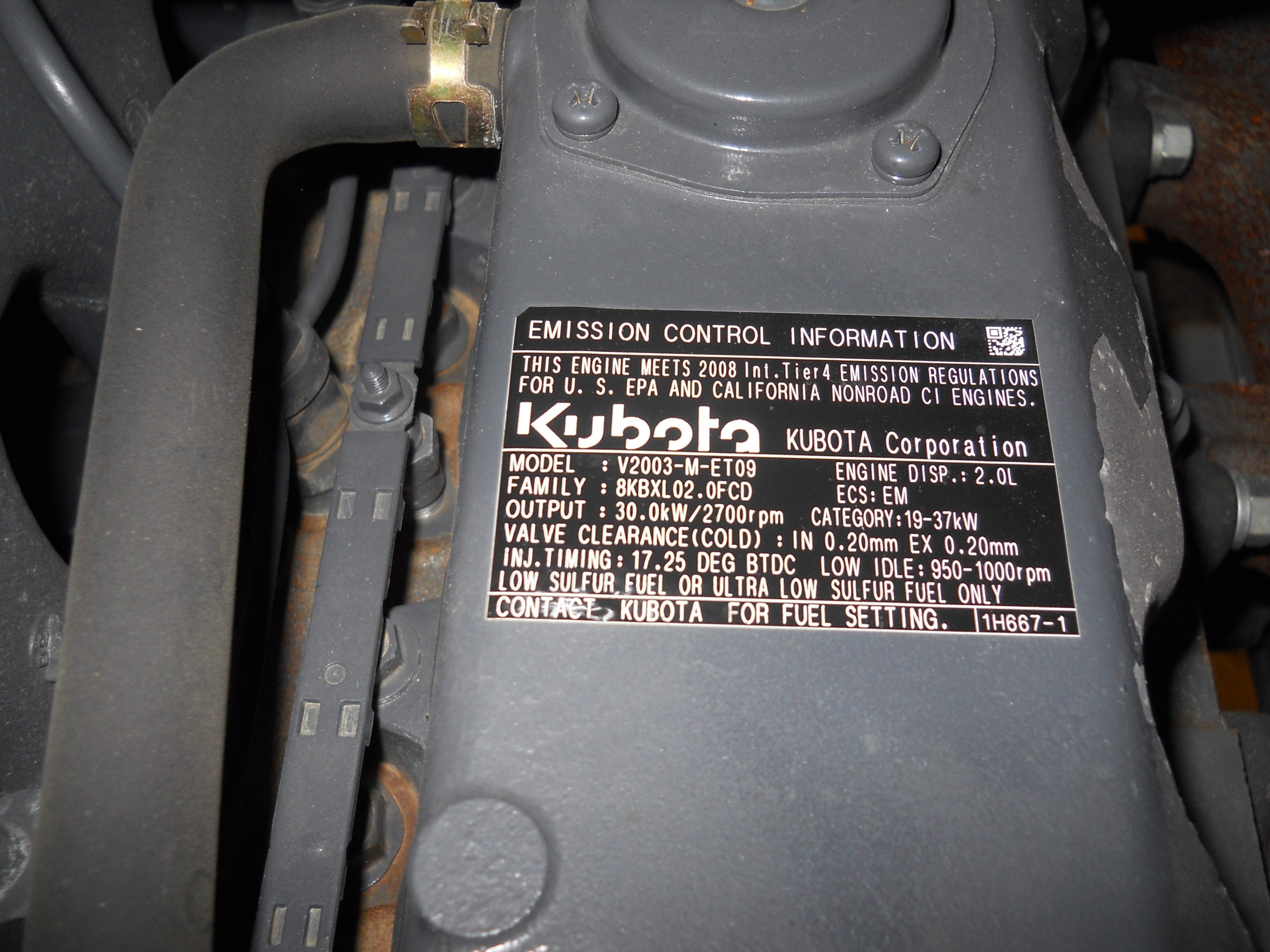

No. None of the L's are at Tier 4. Its Tier 3.
From reply of Kubota above, looks like they are. I am pretty sure mine is T4i. Will have to double check. Philip.
   / 3240 HST-1 vs. 3240 HST-3 #12
I do believe my engine is the interim Tier IV, I think all the GLs have the interim IV standards. I have heard it called Tier III, stage III B, and a few other names because the 25 to 75 HP engines never had a real Tier III standard. They just skipped from II to interim IV. At the end of next year they will be true Tier IV. At least this is what I've been told.
   / 3240 HST-1 vs. 3240 HST-3 #13
Here's what Schwermetall posted last year when discussing the differences. He got a good explanation directly from Kubota. The only thing Kubota missed was the new decals that PHILIP8N pointed out...

I can confirm from the emissions label on my L5740 engine that it meets Tier 4 interim. As someone mentioned, in the 50 - 100 HP range, Tier 4 interim is the same as Tier 3 and was effective in 2008. Tier 4 final my tractor size falls into a 50 - 75 HP range and is effective 2013. The difference then is it cleans up soot by 90% so I think that means they will have a particulate trap of some kind.
Here is a photo of the sticker from the engine valve cover on my 2009 L3940-1. It states clearly an interm tier 4 engine. Philip.
   / 3240 HST-1 vs. 3240 HST-3 #18
I think interim tier 4 is some times referred to as tier 3.:thumbsup:
   / 3240 HST-1 vs. 3240 HST-3 #20
No, that is not correct. There are clear distinctions for tier 2, tier 3, tier 4 intermin, and tier 4 final. This chart should clear it up for you. Philip.
US EPA Nonroad Tier Chart 2004-2017
Not sure but I don't see any tier 3 below the 75hp category which I believe was the category being asked about.:thumbsup:
