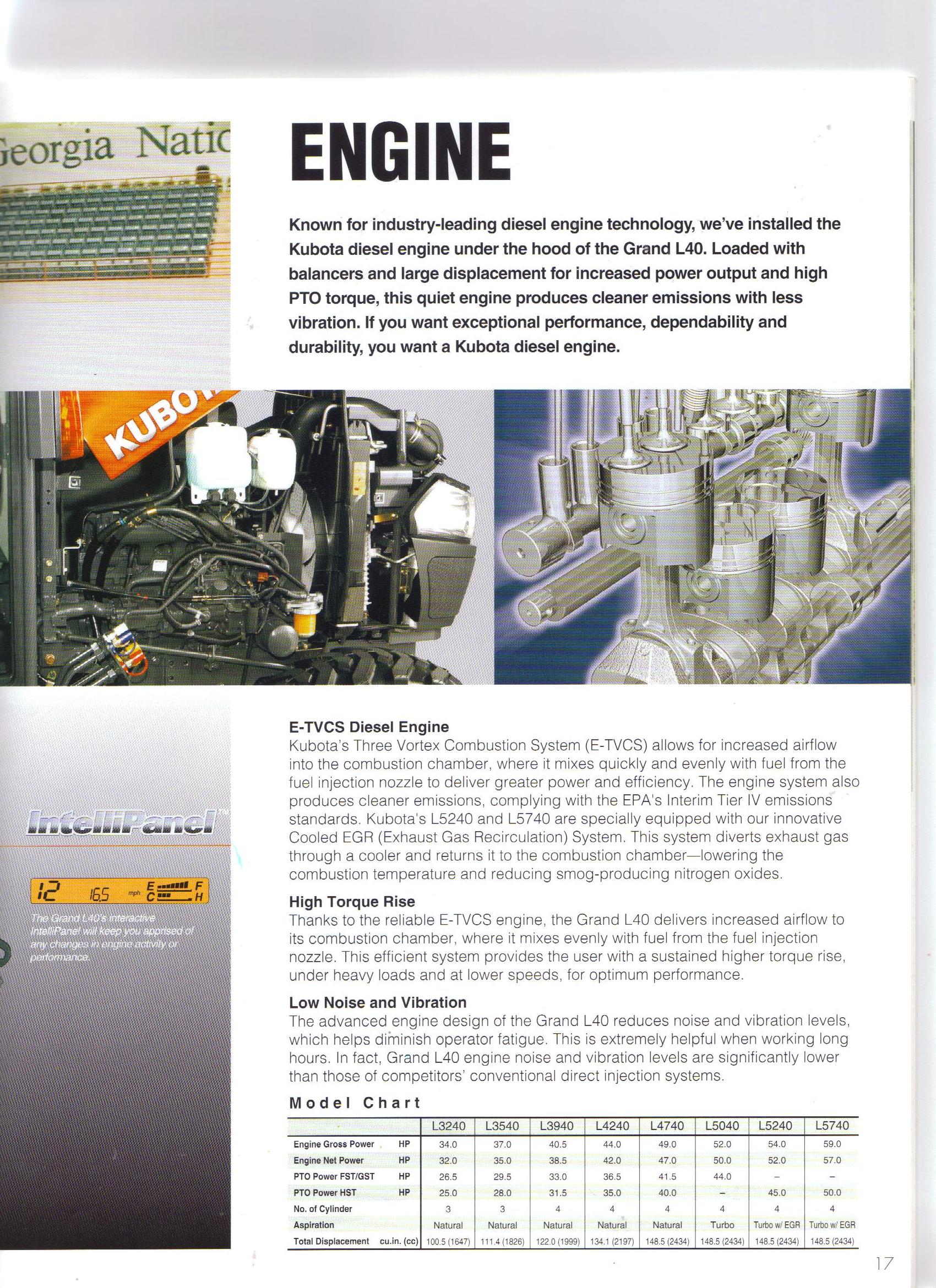

Here is a page from the GrandL series brochure printed in March 2009 I picked up when I bought my L3940 from the dealer in August 2009. It states engines comply with EPA's interim tier 4 emmision standards. Philip.
As does my L5740HST-1 right on the emissions sticker on the engine.:thumbsup:

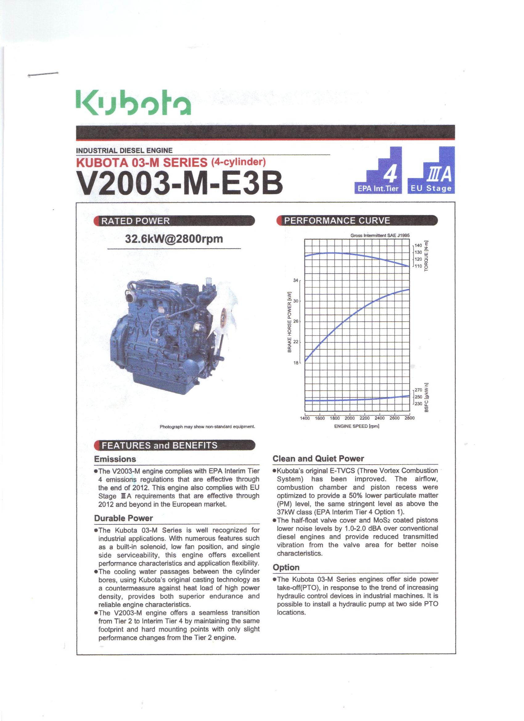

Here is something interesting I ran across. Kubota industrial engine data sheet for the engine in my tractor. Read last paragraph on the left column. This engine 'offers seamless transition from tier 2 to interim tier 4 ...'. Does not mention tier 3, because it was skipped in this power range. Philip.

The attached link has the off road engine emission standards. You will notice there is a Tier 3 for everything above 37 kW (50 HP). If you look at the Tier 4 interim you will see the same numbers for part of the range, but the power range changed. Engines in the bottom half of the range that met Tier 3 automatically also became Tier 4 interim compliant, but engines in the top half of the range remain Tier 3 engines until the Tier 4 interim goes into effect next January. Its a moot point for almost everybody here but the law has fine print that states if you sell machines that beat the standard, you get credits to allow you to sell machines that don't meet the standard until everything balances out.
