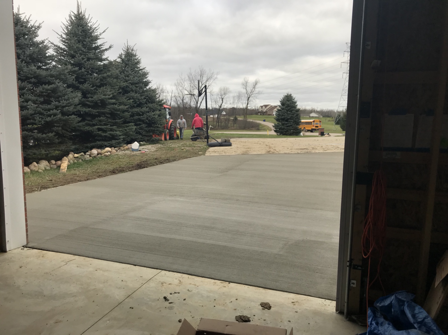

Forming up the driveway
   / 32x56x12 The Barn
#232

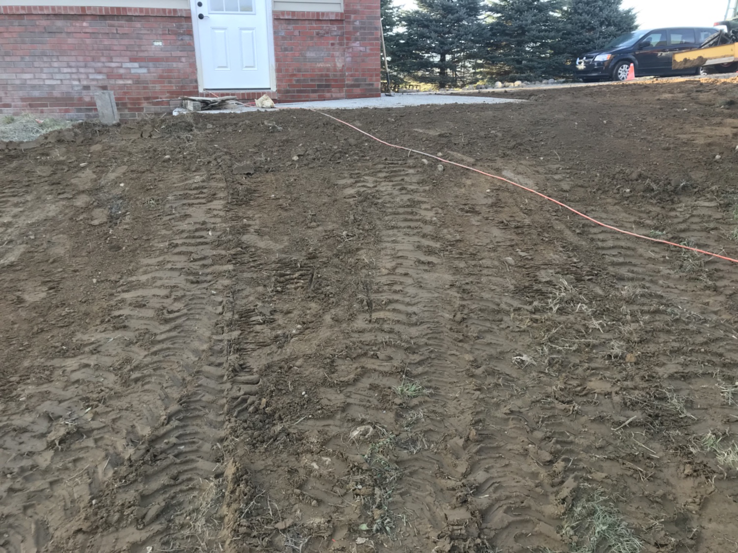

Even added some out back and smoothed it out a little. I’ll have to get a better photo. This is to a path way out back

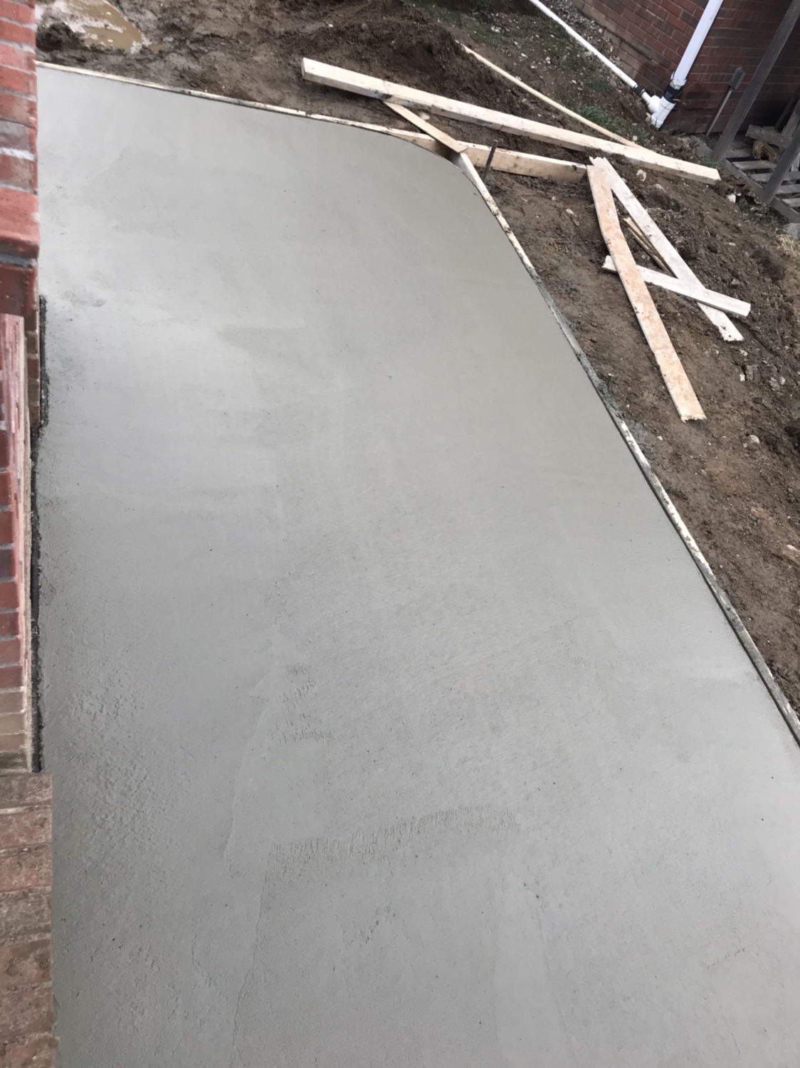

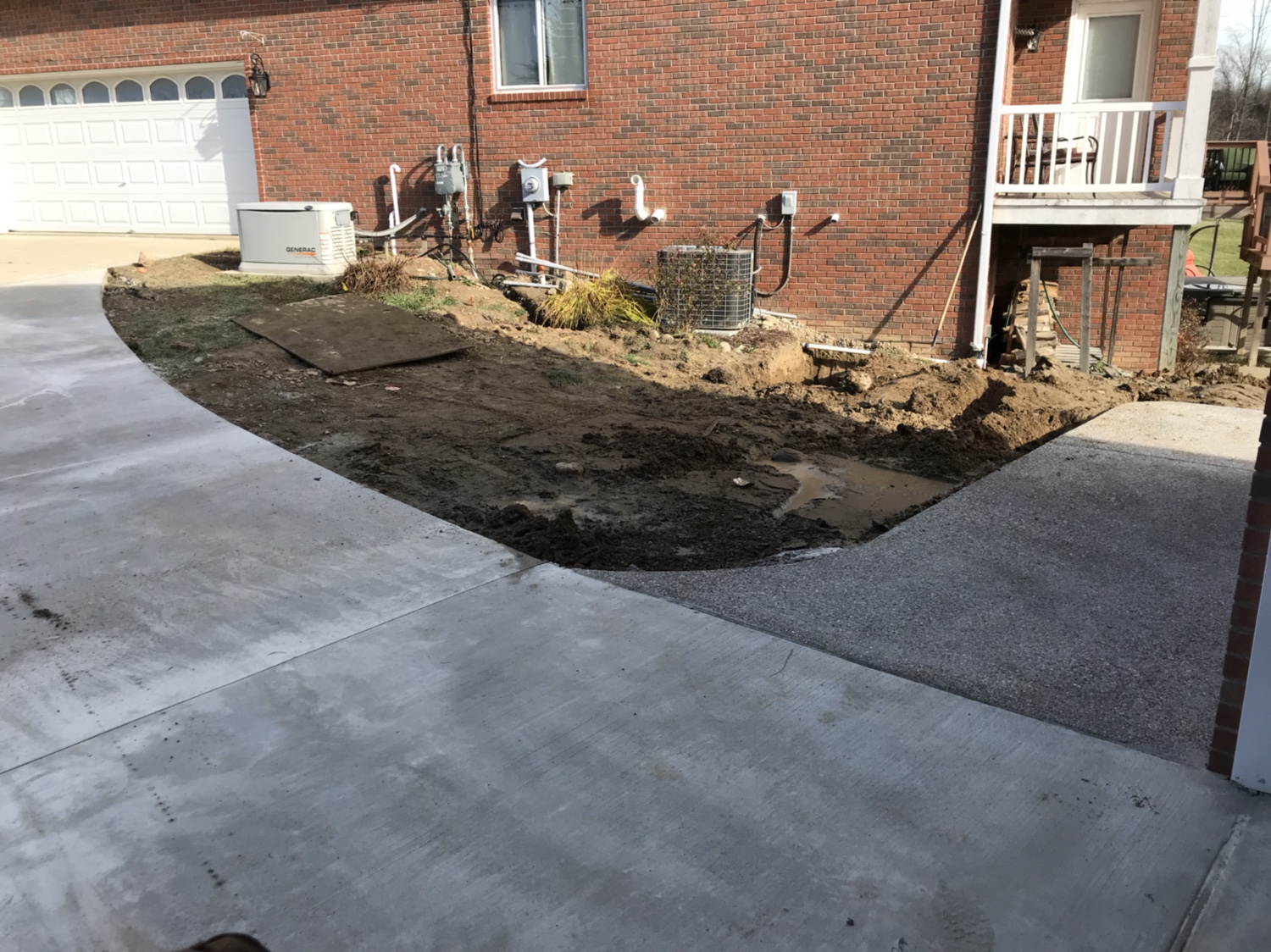

Looks very nice!
I see no reinforcing. Did you use fibre-reinforced concrete?
Were the expansion joints saw cut?
I absolutely HATE cracking, and would have cut many more expansion joints.
You live in a COLD climate, so you will very likely get some cracking.
The concrete is 6” with fiber mesh. No rebar.
There is saw cuts in it now. I may add 1 more in a spot my father in law recommended. (He was also in concrete).
