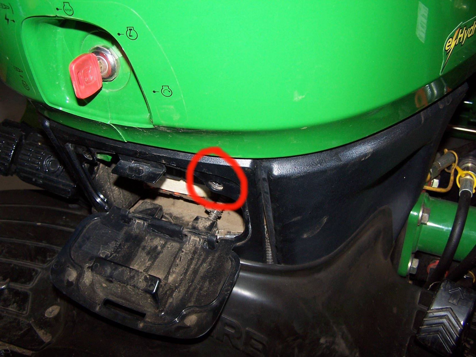

Any idea how to get the tupperware off the 3320 so as to access the throttle friction adjustment? I can't even find the screws.
I think all you have to do is drop the 4 screws and separate the connectors to the instruments?
I wish.

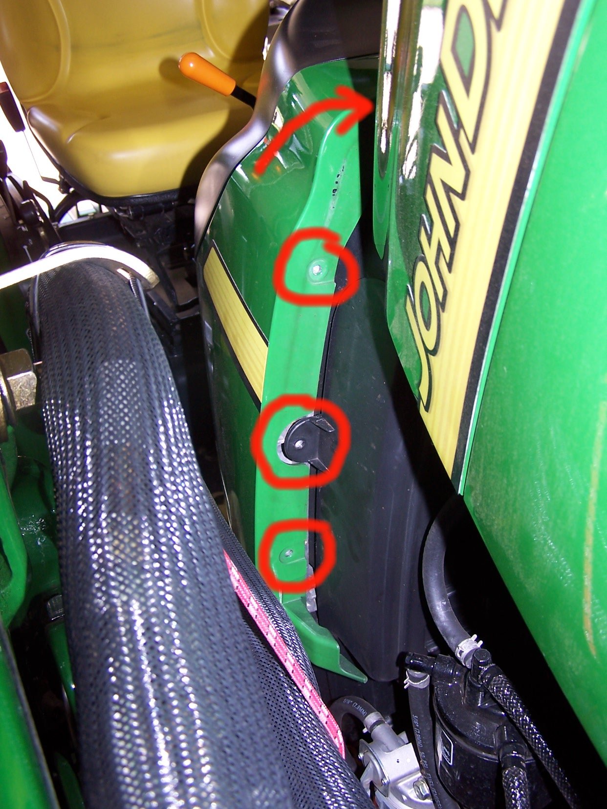

I have removed the four forward facing "star" screws. Three of the holes can be seen in photo #1. I also found a lower rear facing screw inside the fuse cover area as shown in photo 2. But she's still holding on tight. Any other ideas?

Wow, that is different, to remove my instrument panel, all I had to do is drop the 4 star screws on the panel itself, and disconnect the connectors.
How about the nut on the ignition switch?

To remove the green plastic covering, you also need to remove the black part holding the instrument panel. To do that, open the fuel door and see the two 10 mm head bolts going in at an angle. before taking those out, first open the hood and find the slots in the cast aluminum part that hold the nuts on the other end of those bolts. It has been my experience that if you stuff those slots tight with rags, the nuts won't fall into the nether regions of the engine compartment. And if you are careful, you should be able to screw the bolts right back into them when you are done.
Then remove the screws and rotate the front of the black part backward, pivoting around the rear of the black part. You may have to unhook the instrument panel wires (can't remember, its been a few years since I did this). There are a couple tabs in the black part that engage the green part. When you rotate the black part enough, it should lift free leaving the two green parts able to separate.

Thanks for the tip Roger. I was able to get the dash and side covers loose enough to get at the bolt. Much better.
