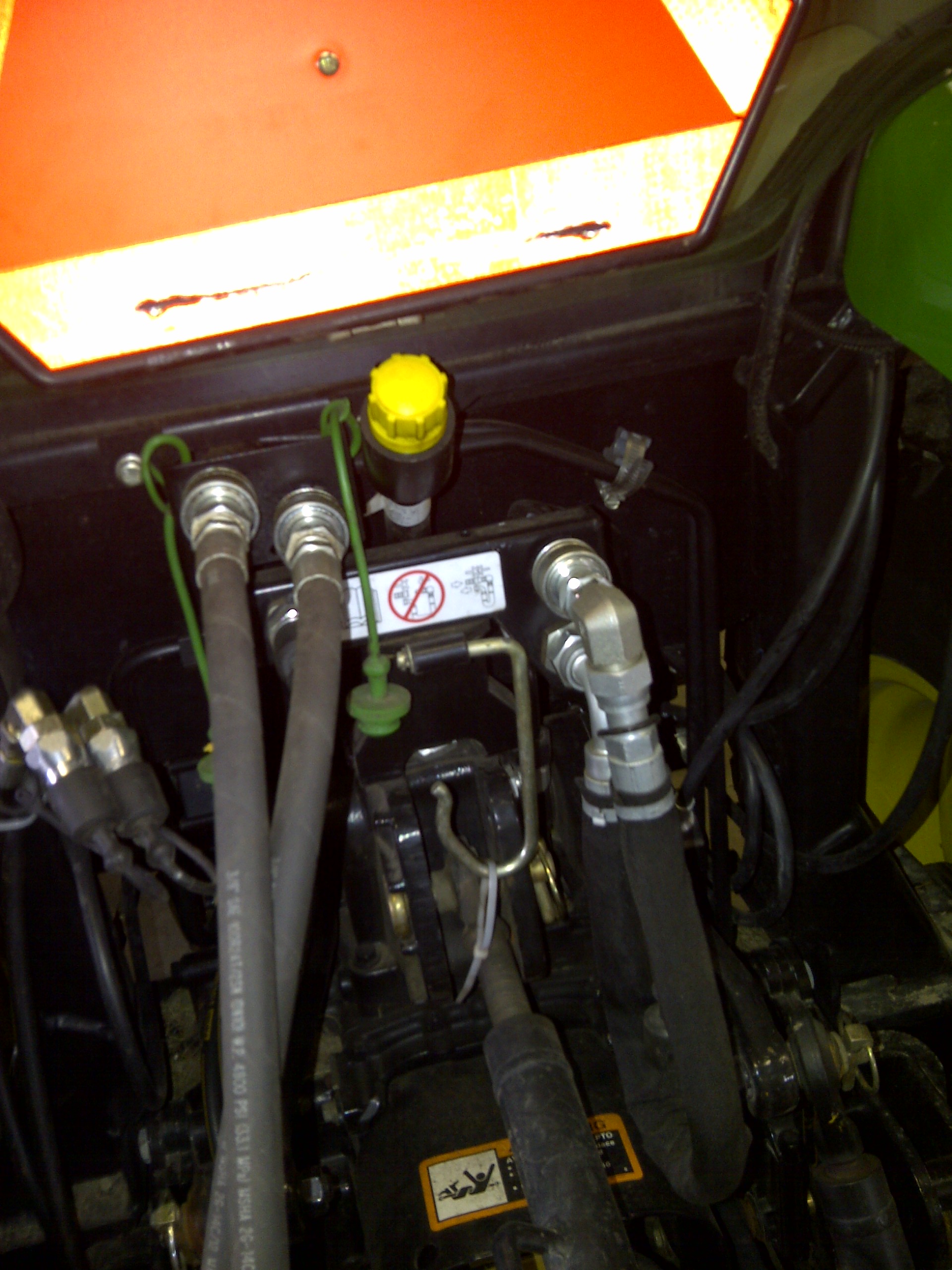

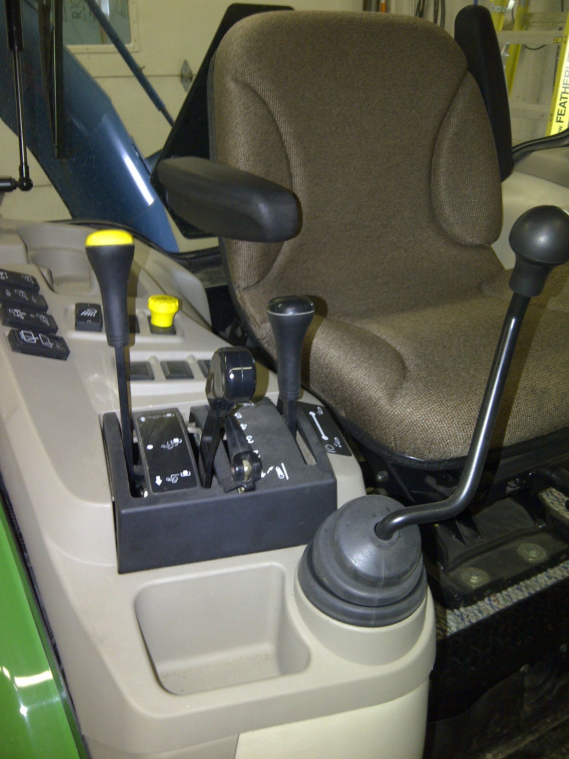

This may be past the point where you need the info. The first pic shows the control lever for the MMM (3rd SCV) on my 2007 3320 CAB. The short lever closest to the seat is for the rear SCV. It is a self centering position - normal closed. The other pics shows the QC's on the left rear of the tractor for the SCV. The two hoses to the extreme left are the MMM lift cylinder hoses - disconnected in this pic. The connected hoses are for a chute control on a snow blower that has not yet been removed. The other hoses & QC's on the right are for the Power Beyond function - at the moment nothing is connected. The hose does a loop back to the tractor when no implement is in place.
