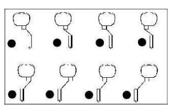

What is Min/Max.. is the width adjustable or different wheel offsets?
   / 3320 price check #16
From the owners Manual (you can download it from the Deere website.)
For 8 position wheels, the mounting flanges on the rear rims are closer to
one edge of the rim than the other, allowing the inner wheels to be mounted
in different positions. By changing this position of the wheel on the rim, up
to eight different tread widths can be achieved on some machines.
Mounting Guidelines
To keep tire rotation in the proper direction when wheels are reversed
without removing tires from rims, move each wheel to the opposite side of
the machine.
Rims can be attached to either side of wheel.
Mounting flanges on rim are closer to one edge of rim.
IMPORTANT: Avoid damage! Always make sure tires rotate in proper
direction. Arrows on sidewall should point in direction of forward rotation.
Tread width can be changed by turning the wider side in or out.
To keep tire rotation in the proper direction, move each rim to opposite
side of machine, rather than turning the rims around.
Dished wheels can be reversed.
Tighten all bolts to specifications.
