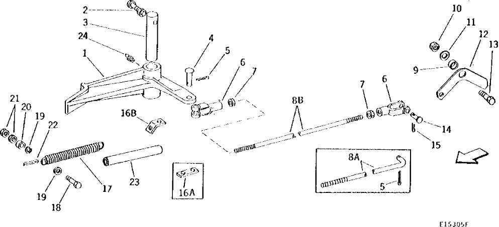

The normal reason the plunger head stop(parts key #1) gets worn from contacting crank arm isn't baler getting out of time but the stretching of the angle of the lever(I call it the boomerang parts key #12) from the needle frame slamming into it when needle frame returns to home position. The stretching of the lever angle allows the stop to start clipping the crank arm on every stroke of the plunger head. Back when I worked for a JD dealer multiple numbers of those levers were replaced for the reason I described.

AKfish
Well... that's a good "nugget" of information! Thanks! :thumbsup:
(I looked at that plungerstop -- and... man, I was glad I wasn't in the field when that baler did whatever it did to cause that!! :eek:)

I'll give you another "nugget of sq baler info" if you'll send me an "Alaskan Gold nugget"!!!!!!!!!
Seriously the stretching of the angle on the lever can cause the lever to bind on the pivot bolt bushing therefore rendering the PH stop inoperable although mechanism will appear operable.
Hmm... every season, I pull the baler into the shop and go over everything and then hand bale a couple of bales with it before hitting the field. I fire the baler up - "dry" for a few minutes at 150 rpm or so and look it over - then actually bale with it a 540rpm.
Have to admit - I've never actually watched the plunger arm cycle past the stop mechanism.
I will this year... Thanks. :D
And, I'll be lookin' very closely at that "boomerang" lever, too.

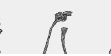

Hello! Prompt that can such be. The problem in that that tears the right side of a bale, or doesn't fasten. You don't know in what there can be a problem?
