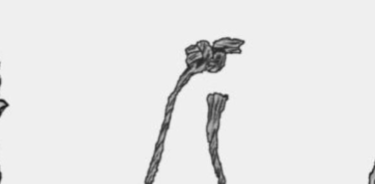

I just bought a JD 336 baler from a consignment auction. After I got it home, I found the data plate missing. Is there any way to ballpark the age of the baler? 2. One side will tie a knot but the other side does not. I'm kind of green when it comes to working on them and any help would be a great help. I would like to use it a bale straw this year. I don't have much time to get this baler field ready.

Welcome to TBN, RCCB. The 336 is a very good baler. Get an owner's manual and the technical repair manual. I bought the OM and the repair CD on eBay.
I'm not sure that investing a whole lot of time on the age of the baler is necessary... They're old! But, there's lots of parts and rebuild items available.

Very good baler. No significant changes to the current models. Parts catalog is on John Deere site on line. My dealer stocks most of the parts. Owners manual is a must. It tells you how to set up the knotters and everthing else. Knotters can be tricky though so if it still doesn't tie after you get it all to spec you may need some expert help to lay hands on it. The exact year is totally immaterial. Think 1980's.
FYI don't switch twine type. If you found any twine in the baler make sure you use the same material and weight as was previously used. There are places where the twine runs that wear and changing to another kind will fuzz the twine and give all kinds of problems.

Old balers that have knotter problems can be a real pain to get running correctly. You need to debug the knotter problem and keep posting back here to TBN as you accumulate more data on the bad knotter so we can help you along. You can do some of the diagnostics without powering up the baler. But eventually, you're going to have to split apart 8-10 small square bales, hook the baler to your tractor and run it while you hand feed hay into the pickup and watch the knotter's perform. You need to get the operator, service and parts manuals pronto.

On the side that is not tying, is there a knot on one end of the twine? If so, which end? The string on top of the bale or the string being brought up by the needle? What type of twine are you using? Sisal or plastic? 7000 or 9000 ft?
