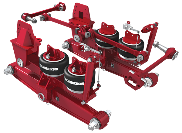

Like you said Hay Dude, I think you are overthinking it. As long as the truck hasn't been abused, you won't break those rears doing what you are doing. I wouldn't spend money replacing them.
As for you're other question, Chalmers was the walking beams on a big center mounted round rubber block. Very good suspension. Next best ride compared to air, but super durable and stable. Used on everything from trucks to crane carriers and even my pony dump trailers.
Tuff Trac (Freightliner/Western Star), Volvo T-Ride, Mack M-Ride are all basically, for the simplest description, an upside down leaf spring pack with no beams. Like Chalmers they also have a very good ride and tons of articulation.
The other thing you could do if that RT walking beam ends up being too horrible a ride for you (which I don't think it will be) is Link and Hendrickson used to offer a retrofit kit to convert them to air ride where you replaced the leaf spring pack with air bags. This pic is the factory setup you can spec on new trucks, but the kit did the same thing.
