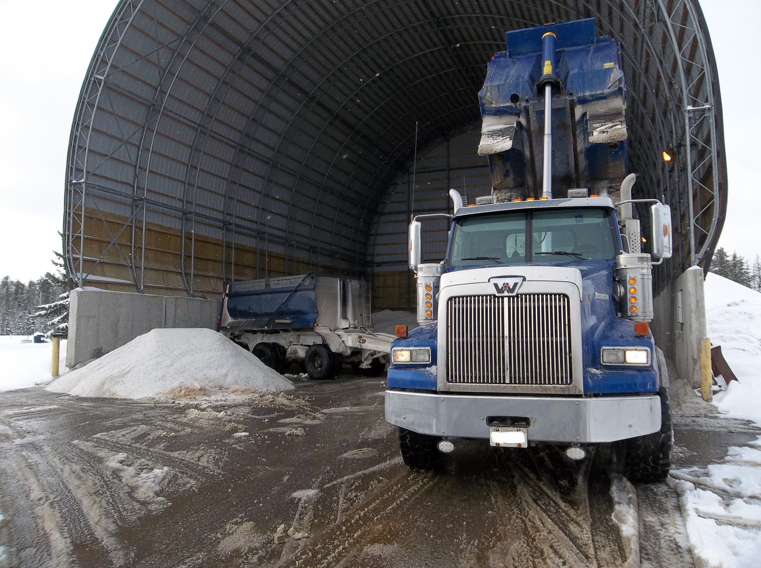

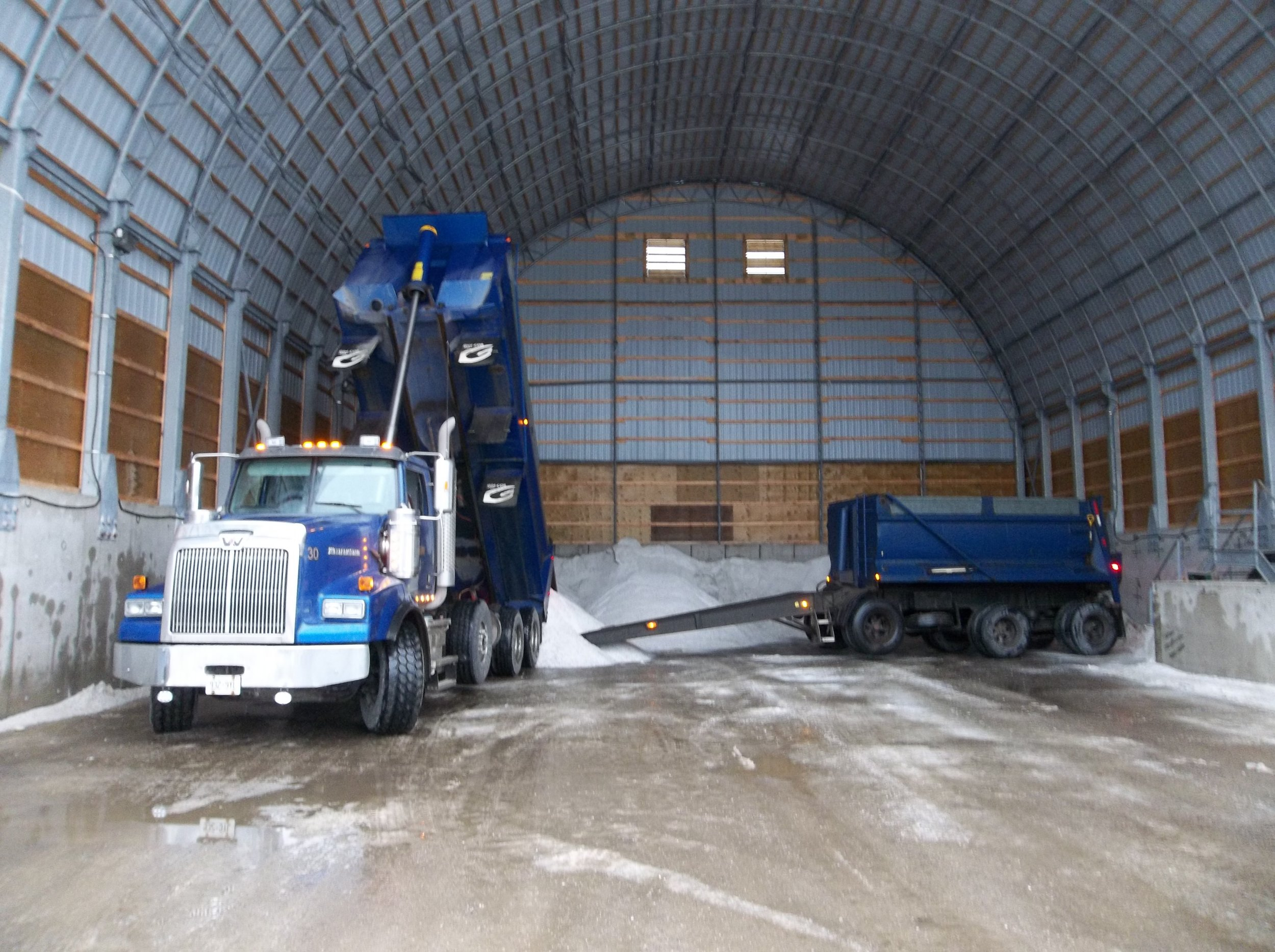

I prefer air ride on the trucks, but I liked having the Chalmers on the pup trailer because you could pick the rear tandems up off the ground with the lift axle and pivot on that lift axle to jack knife around stuff.

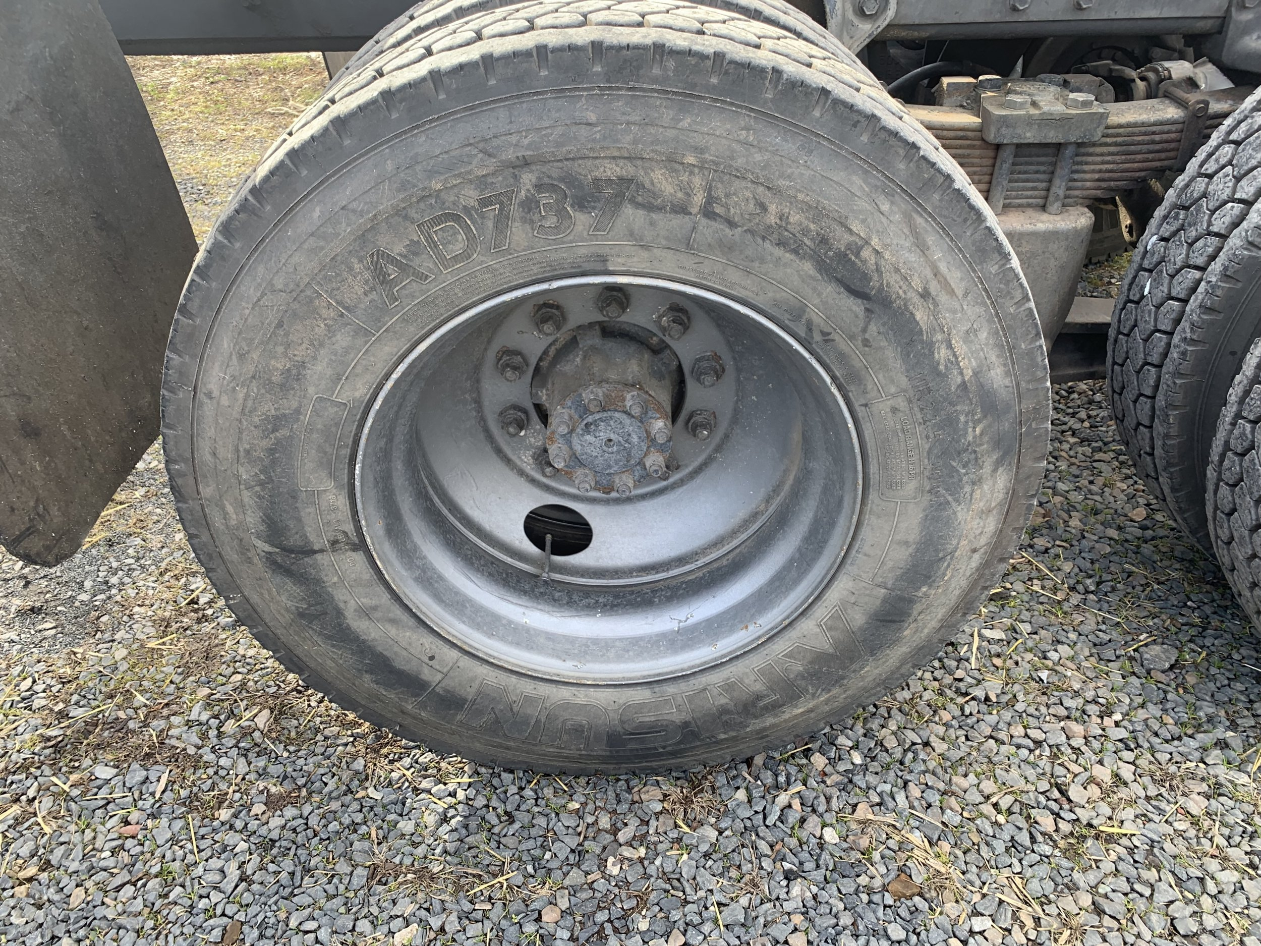

I snapped this pic mostly to remember what tires were on it. To the right you can see part of the suspension

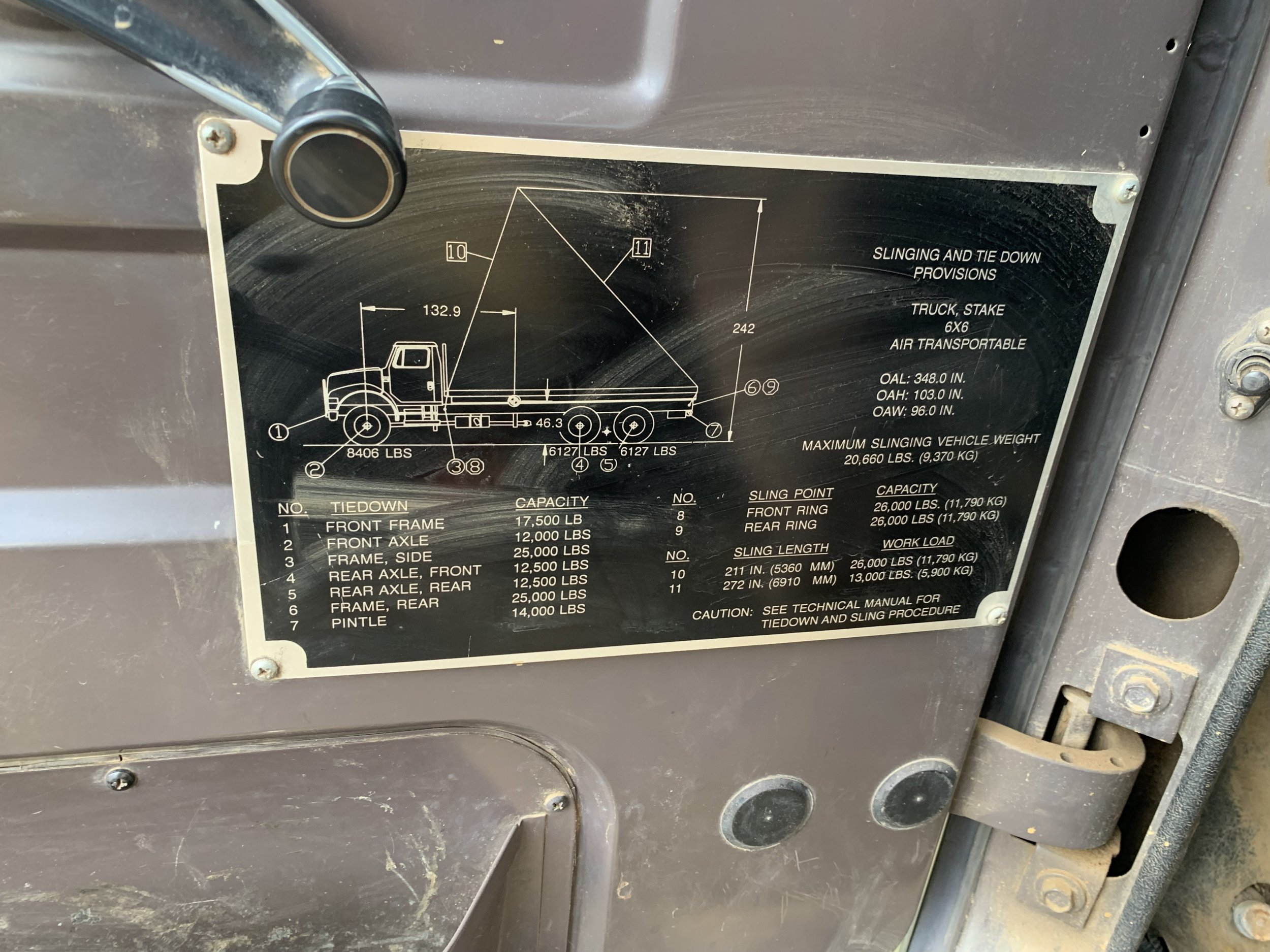

Below is the tag from when it was a military vehicle. The IH and door jamb specs are higher. I think the military derate s trucks as I commonly see on their others.

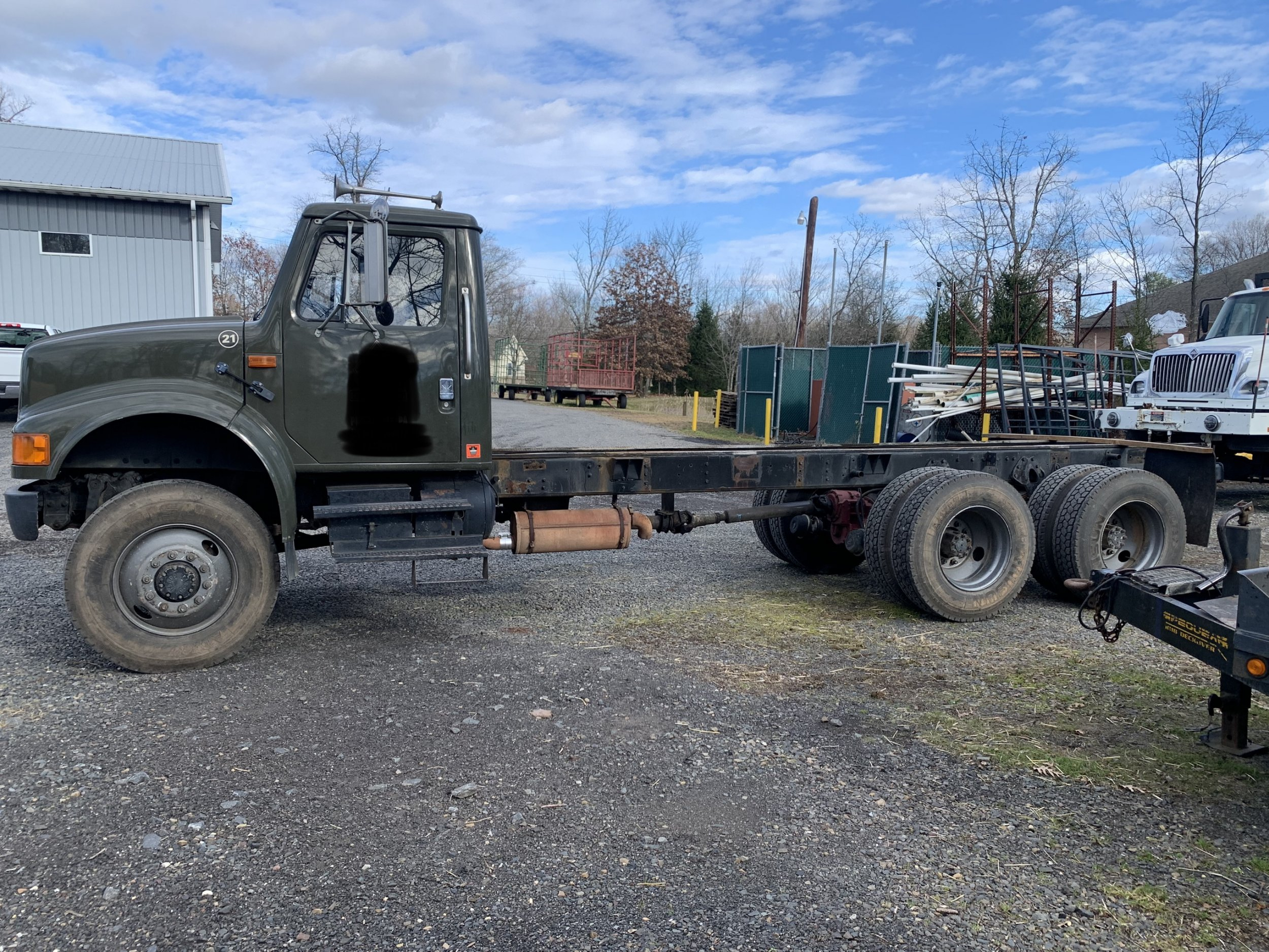

One more pic of overall truck
