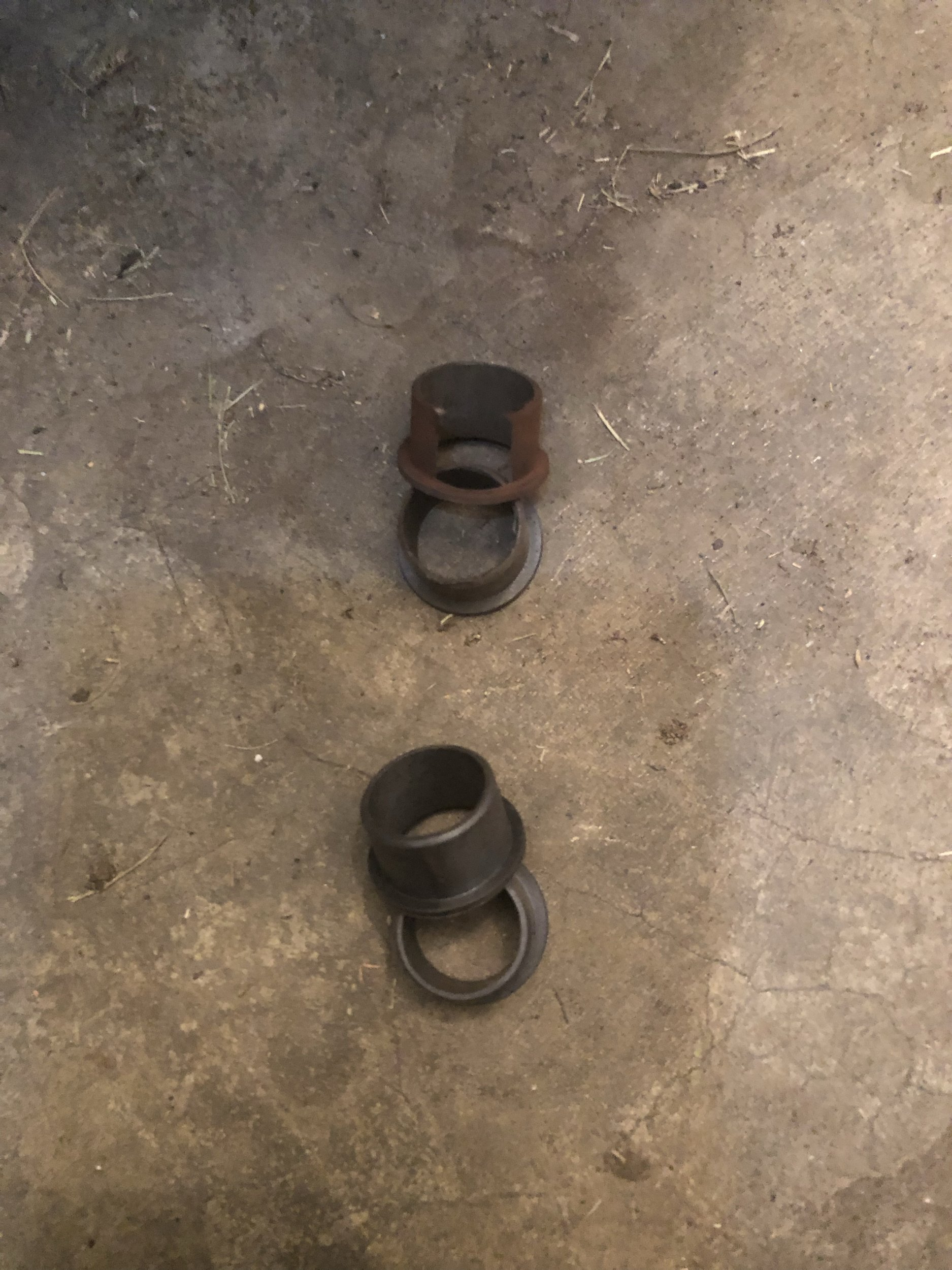

Just about done with my drive belt/idler pulley replacement. Along with fuel pump/lines and transaxle filter/fluid change, I hope.
Big snow coming in a few hours, I’d like a running snowblower.
I need to stop by the dealer for an internal filter , they only gave me the external one.
One thing the parts guy did suggest was to replace the idler pulley bushings- M71682
Also the bushings on the idler pulley dual mount- M111358.
Old bushings on top.
He was right about the pulley mount, one bushing was broken and the shaft is worn. The shaft looks welded to the large plate that is riveted across the frame so I just cleaned it up as good as I could and replaced the bushings.
We’re the second owner of this 345 with just about 600 hours on it. Hydraulic filter had a 2007 date on it so at least some maintenance was done to this thing.
The original fuel pump sprung a leak, right onto the exhaust. Upgraded pump has a third outlet with a hose to drain fuel directly onto the ground in case of a leak.
Changed all the fuel lines while I was in there.
I removed the body work, doesn’t take but 5-10 minutes working slowly.
I didn’t jack the tractor up, I would probably get it in the air if I had to do it again just to save my back.

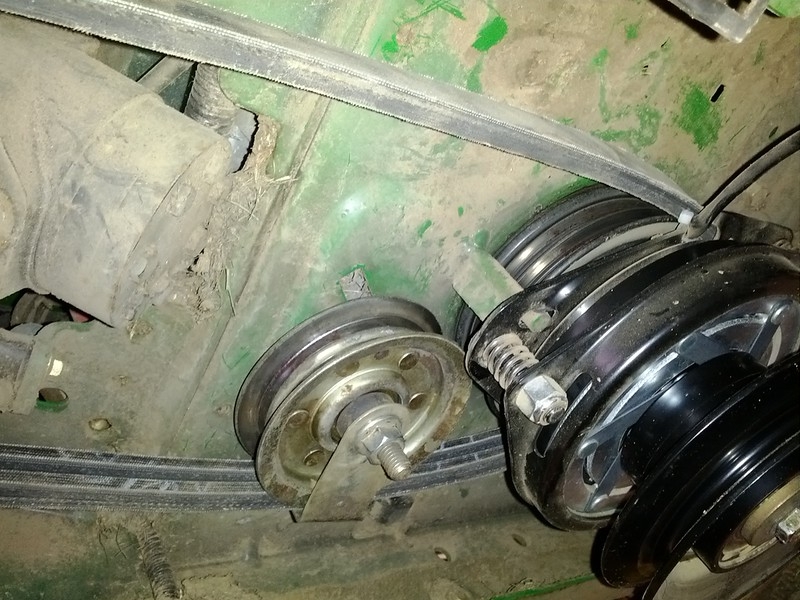

How do you change the pulley next to the power takeoff. Isn't that carriage bolt under the engine?
