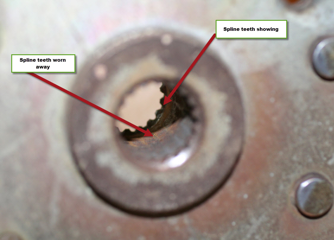

I just finished up on replacing the trans-axle belt. Thanks to all the posts on this subject as it made the job a lot easier to follow. I had a little grief separating the electrical connection to the PTO. I finally wiggled it apart after 15 minutes and could get the new belt up onto the drive pulley. The electrical blades in the PTO plug were really corroded tight. Used some electrical spray and put them back together quite easily. Taking the fender/seat assembly off is the best way to go. I would have missed the trans-axle input sheave pulley had all the gear splines worn away and was just about free spinning. The nut was tight and that was the only friction holding the pulley tight to the input shaft. I had read somewhere that the spline metal on the sheave pulley is softer than on the trans-axle input shaft. That keeps the input shaft splines from wearing out creating a real costly mess. It appears that spline takes a lot of the stress when turning the input shaft so you may want to check it when you get to that point.
