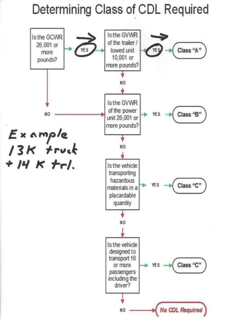

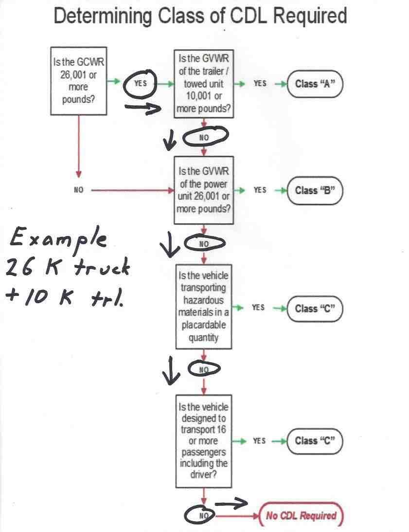

Here is the flow chart from the NC CDL handbook (page 1-1). Most state have a similar flow chart.
I have annointed it for my hypothetical 26K truck and 10K trailer. The same qould apply for LD's 19.5K truck and 7K trailer.
A 13K truck and 14K trailer would require a Class A CDL, which can be seen if one follows the second flow chart.
