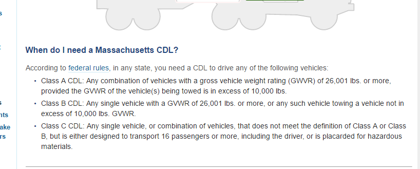

I have a 16K GVW F450 and 9999 GVW trailers. No CDL needed. However if I pull a 10001 GVW trailer behind a 7k GVW F150... I need a CDL.
WHY. Are you engaging in commerce/towing for profit.
And even if you are......
Looks like Massachusetts follows the fed.

Only if you go over 26k combined. The CDL weights are the same in every state. Class A is over 26k gross combined with a trailer of more than 10k Class B is over 26k gross and/or with a trailer under 10k In NC, If you have a 12k GVWR truck, and a 12k trailer, you need nothing other than your standard license. Same as all other states
Not in California. Any trailer over 10k need CDL. Unless it is RV then you can tow anything. The equipment and dump trailer dealer I bought my dump trailer from orders in 14k dump trailers derated to 9990lbs just for that reason.
   / 3500 truck needs CDL? #109
You live in a nanny state. Most other states just follow the feds restrictions. Which are exactly as I have stated. I am not gonna look up all 50 states and see if that add additional restrictions on top of feds restrictions.
Here what I can find for CA
A commercial vehicle is a motor vehicle or combination used for hire to transport passengers or property or which:
Has a gross vehicle weight rating (GVWR) of 26,001 pounds or more
Is designed, used, or maintained for carrying more than 10 passengers, including the driver
Tows a vehicle or trailer, which has a GVWR of 10,001 pounds or more
Transports hazardous materials, which requires placards
Tows any combination of two trailers or vehicle and trailer
Si it seems that CA lowers the passenger # down from 16 to 10, and throws in that 10k trailer thing....whereas the fed only uses +/-10k in determining between classes.
But in either case.....the way I read the first line in red is the same thing I have been saying. Only need a CDL if working for hire. Yet you say ANY trailer over 10k.........but the way its worded would lead me to believe that it doesnt apply to personal trailers, hauling your personal stuff not for hire.
