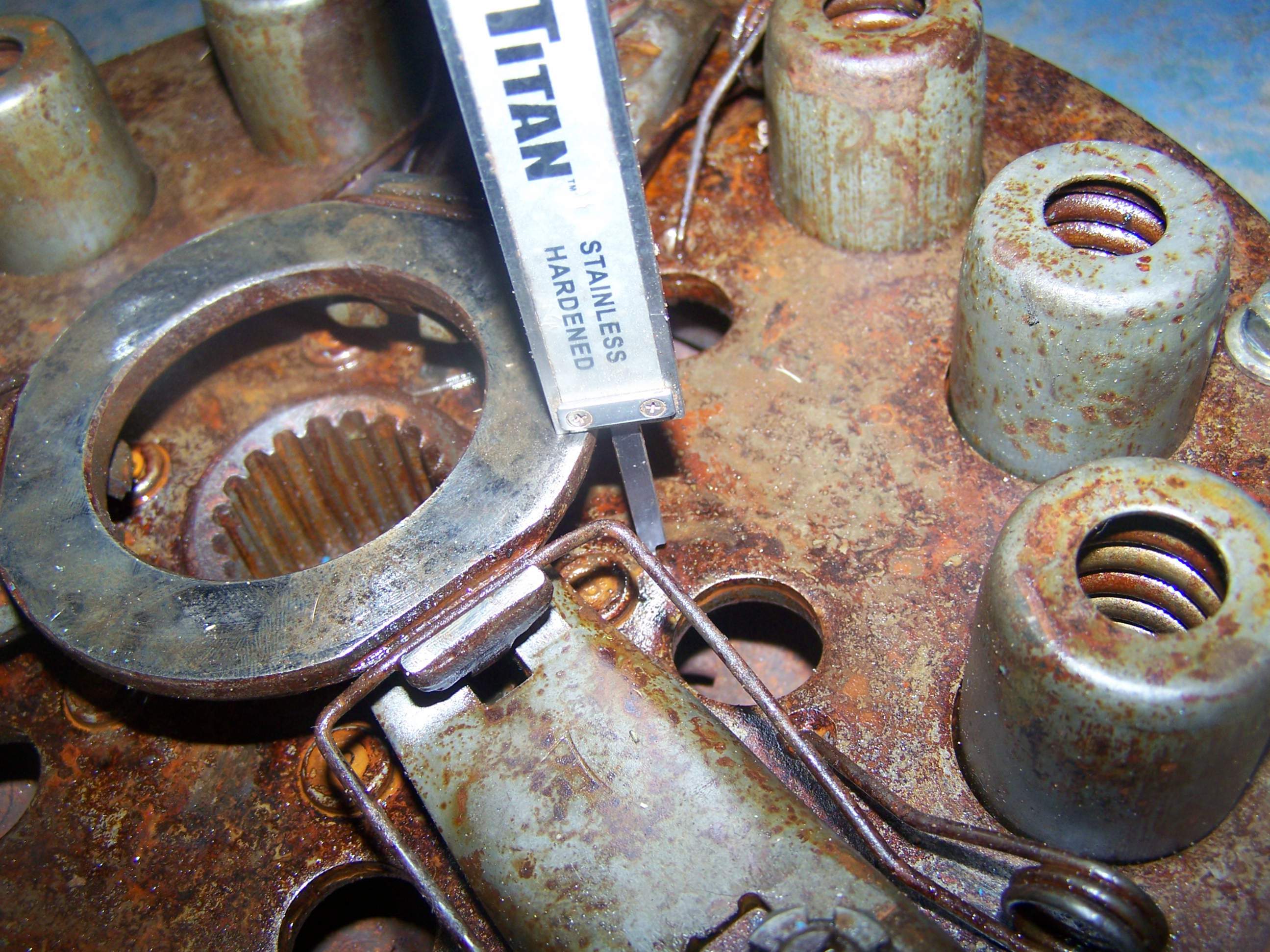

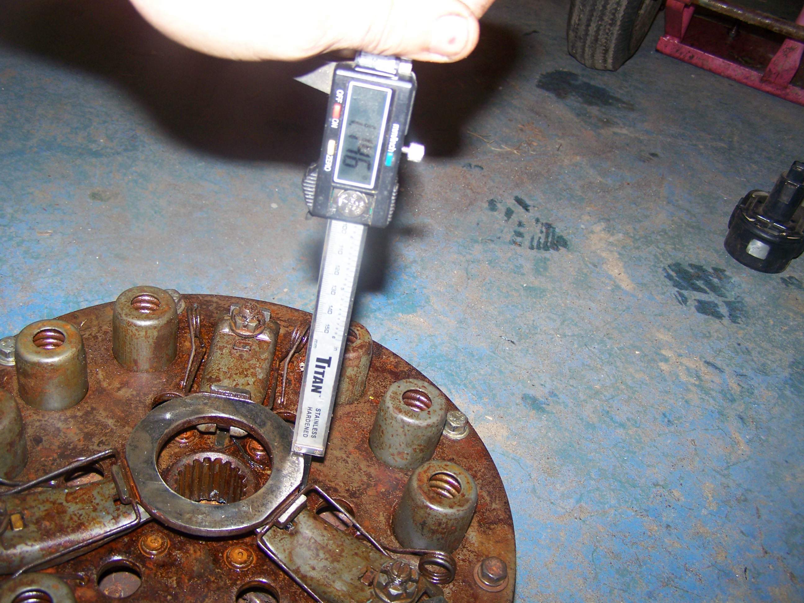

Have done my pressure plate a few times - mine has a tendency to break one of the adjusting bolts every so often when worked hard. I have a spare pressure plate that I think I'll get a machine shop to upgrade to larger bolts for the next breakdown. I prefer to adjust the fingers with the flywheel on the bench instead of mounted to the crankshaft and vertical. Just mount the disc & plate and torque the bolts down and do your adjusting. The service manual spec is 65mm (2.559") +/- .7mm (.030") from the face of the flywheel to the top of the forks. This measurement is extremely hard to get without their special tool but I rigged-up for it years ago and once I had them set I took a measurement from the back of the pressure plate to the top of the forks and came up with 1.150" and have used that since. It puts them where my clutch linkage will adjust properly when all reassembled. Your tractor could be different, you'll just have to figure it out.

THANKYOU! I would not have thought to locktight that plate into place. I don't understand how you can measure from the flywheel face to the top of the forks with the clutch assembled. Sure seems easy to measure from the top of the clutch to the fingers. I recently did a Belarus clutch and they gave me a measurement from the clutch mounting face to the face of the pressure plate when it was disassembled.
I dont see any way to measure the 65mm from the flywheel face when it is assembled! Is this where you are measuring the 1.150" at?
