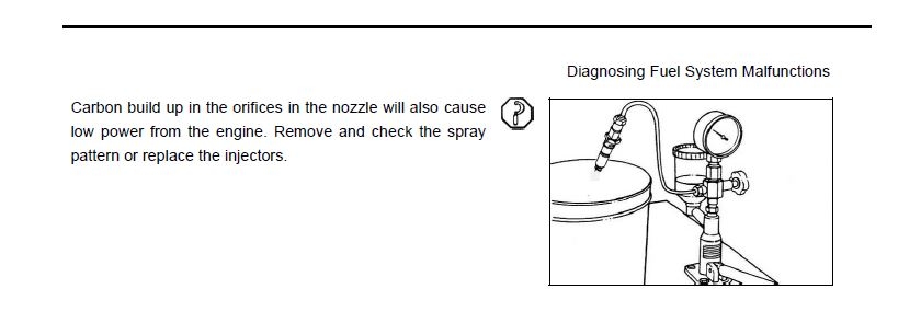

branson 3510i will not speed up. i checked the lift pump, even put in a new lift pump tho the pressure seems to be 3-4psi, should i expect more ? the tractor starts right up never fails,but will only run at a minimum speed, the throtel cable is ok i can see it opening and returning , tractor speeds up just a few rpm, since the tractor starts right up and runs every time i would think the fuel injector system is ok. not sure what the butterfly does, does it or is it suppose to open a needle valve, if so is there a plug i can take off to check for debre ? thanks craig..... on going used the tractor to move tree limbs around at idol speed. engine still running at idol not missing or smoking. do not really want to pull the injector pump unless someone says that is the problem. connot believe no one knows what pressure should come from the lift pump. thanks craig

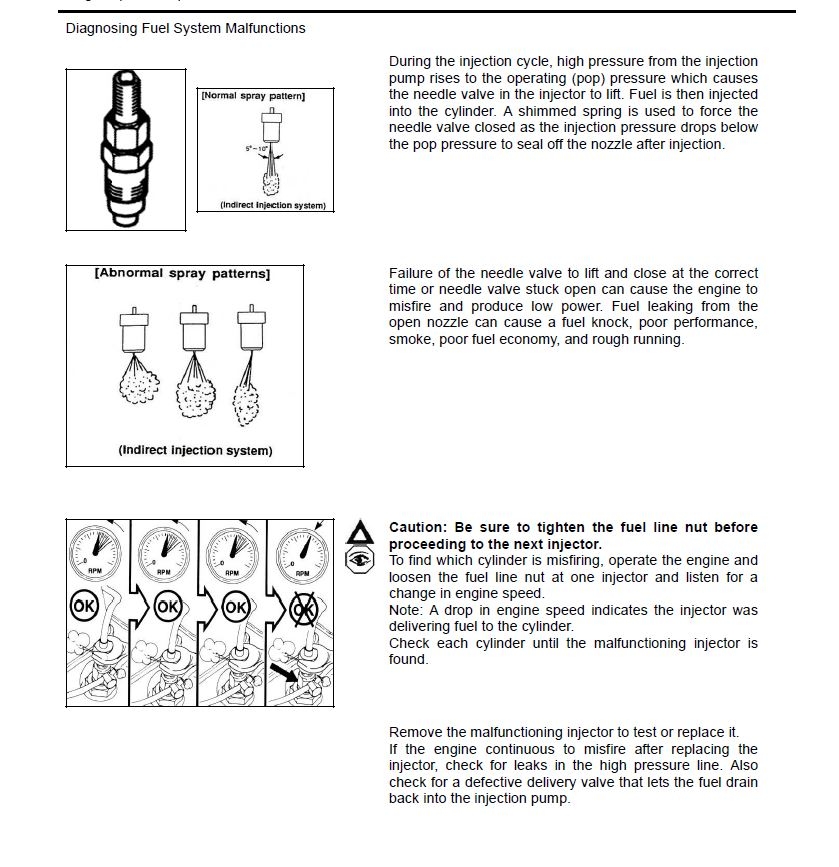

well it was my understanding the fuel feed pumps, or fuel lift pumps are supposed to operate at a 4-7 psi range, but i would think even at 3-4psi it would still operate at higher rpms than what you are seeing even being a slightly lower psi pump.
has it had any smoking on start up at all any black, blue, or white smoke?
it could be you have an issue with the injection pump, but i agree with you that it would have more issues starting as well. it could be you have a bad or weak spraying injector but that would also be pretty noticeable as well on start up and even while running.( you can pull them and use a POP tester to check their spray patterns
hmm you've got an interesting one for sure, ill be following along to see what you discover.
as for dpf being clogged i don't think that model even came with an emissions system unless that was made after 2014, but tbh i dont rightly remember what years that model ran through.
i added two pages about the spray patterns for the injectors hopefully this will help.
