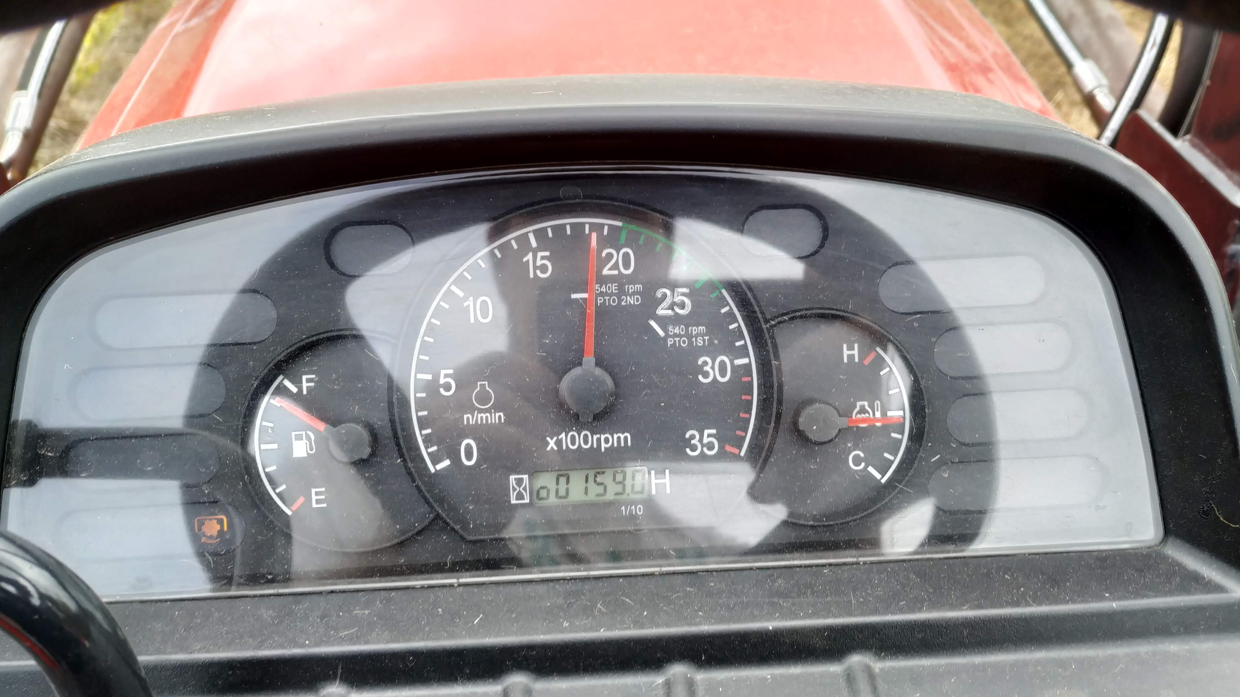

Found an older picture of mine. This is where it stays once it's warmed up. Even under load, it won't go above that. It did went above once but I had the radiator full of chaff, which I cleaned right away.
Now, I do believe the dash is slightly different on the Cab version.

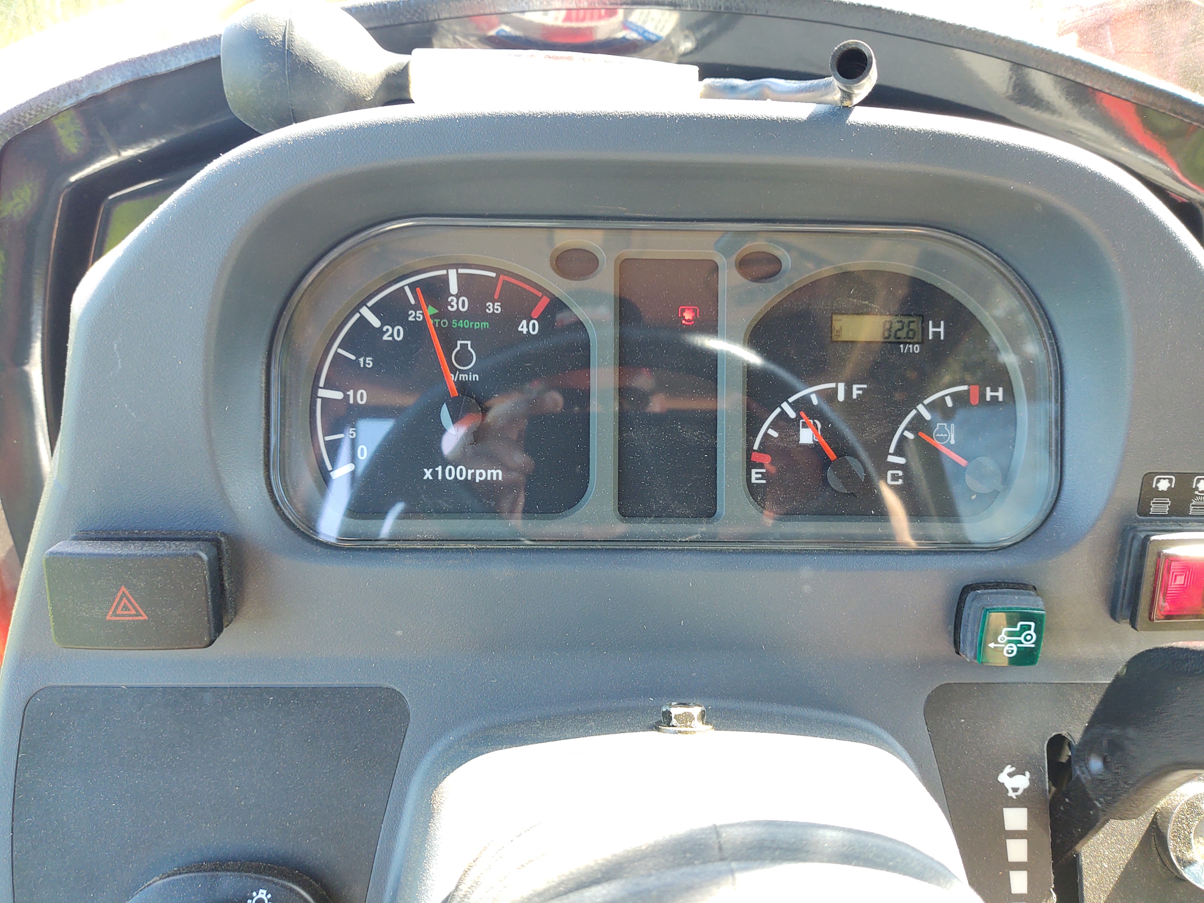

Ok, update, I flail mowed for ~1hr and you can see what the temp gauge looks like, also after mowing I held my hand on the radiator for about 20 seconds and was not tremendously hot. Dealer thought it might be temp sensor, I guess it could be but to me it still seems like a thermostat which his mechanic said he did replace. I wonder if they might have put a lower rated thermostat in. Dealer will get back to me. You can see how the gauge fluctuated.

A lower temp thermostat would mean that the temp gauge would just sit slightly under the mid mark. It wouldn't cause the temp gauge to fluctuate like that. Once it gets to operating temp, it should just sit there.
I'm also wondering about the temp gauge sensor or wire acting up.

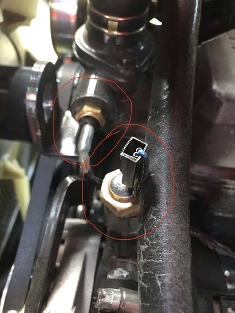

I would look closely at the sensor wires. I bad connection would create the symptoms you are seeing.
On mine, it has two sensors. One by the thermostat housing and one on the heater hose. They installed the heater hose on mine after hooking up the sensor so it is in a bind. I plan on fixing this when I do the 50 hr service. The wire should route over the hose not under. See picture.
