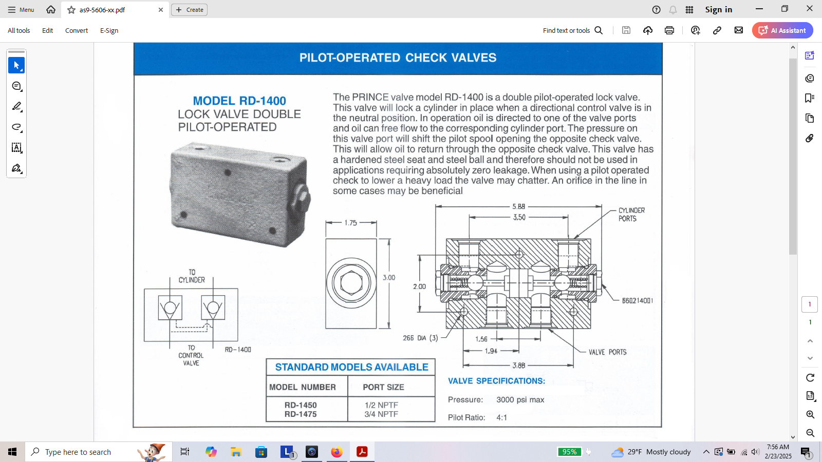

This is what I was thinking, this will also SLOW my dumping circuit- as from new it seemed real fast as if it released, so I was always careful dumping the bucket.Many hydraulic valves are spec'ed with a maximum leakage. Normally the more expensive the valve the lower the leakage rate.
I do not believe you would gain anything by "cleaning" or flushing the valve. If no creep is your desired outcome and you can live with slower dumping and response times you could add a pilot operated lock valve. Or a pilot operated check;
Otherwise a new valve would be required for less creep.
