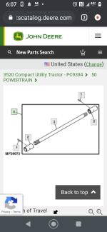

My 3520 keeps kicking out of 4wheel drive. I found the problem, but have not determined what the fix is. Seems the splined slip collar moves and lets the shaft slip out of position far enough that the 4wheel drive doesn't work until i crawl under the tractor ann physically move the shaft so it engages.
I know there is a roll pin through each of the 2 slip collars. What is going on that my shaft is moving too much and disengages?
Is there any adjustment on the shaft for end play?

The roll pin through the collars are to keep the shaft centered while the roll pins are installed. When they are removed the collars can slip over to either side and the the shaft can be removed.
It sounds like the roll pin is worn off enough to let the collar move and disengage from the driveshaft. It also sounds like the splines are worn.
The fix might be as simple as replacing the roll pins (inexpensive fix). If the splines on the shafts are worn badly then eventually the shafts will need to be replaced (expensive).

Just went out and punched one roll pin out and disassemble the intermediate shaft and two collars.
One of the roll pins was broken. Which allowed enough movement for the 4wheel drive to disengage. There is some wear on one end of the shaft and one end of one collar. I think once its reassemble and roll pins replaced it will be okay.
At worse it will wear out the one end of the collar and one end of the shaft. Otherwise i think it will work fine once i put it back together. No wear on the collar ends that attach to the trans shaft and front differential shaft.
