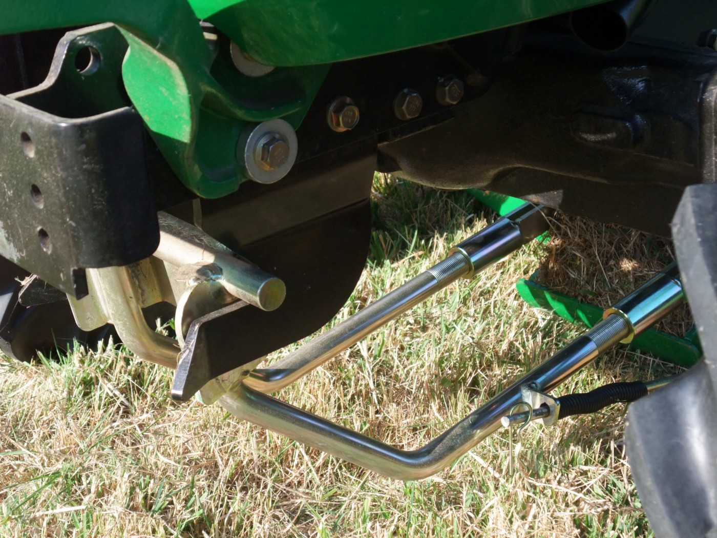

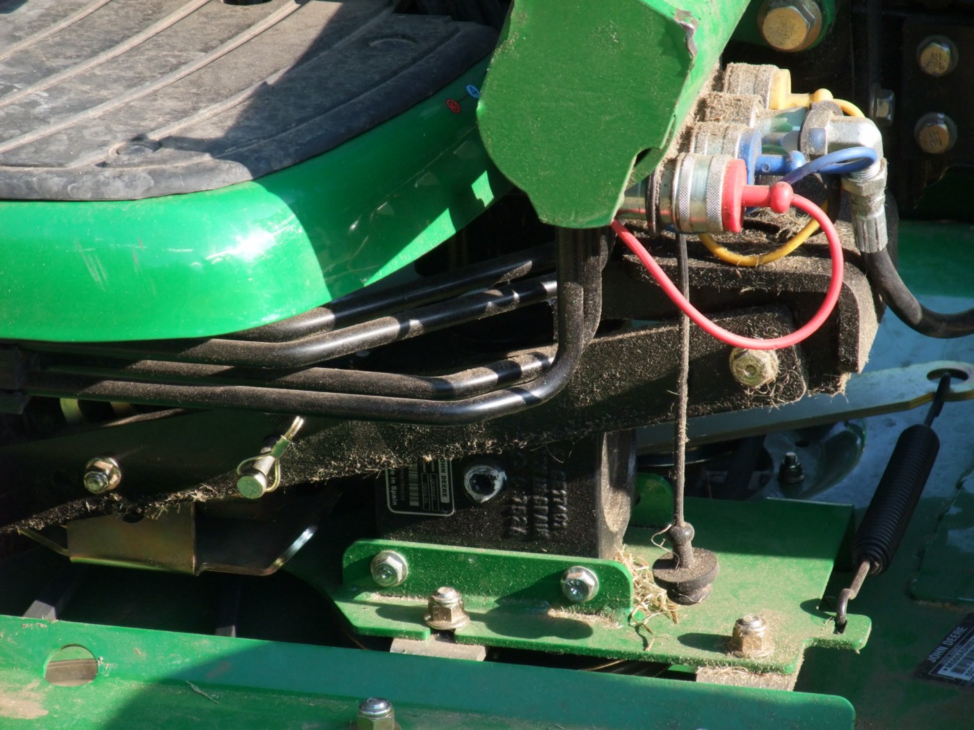

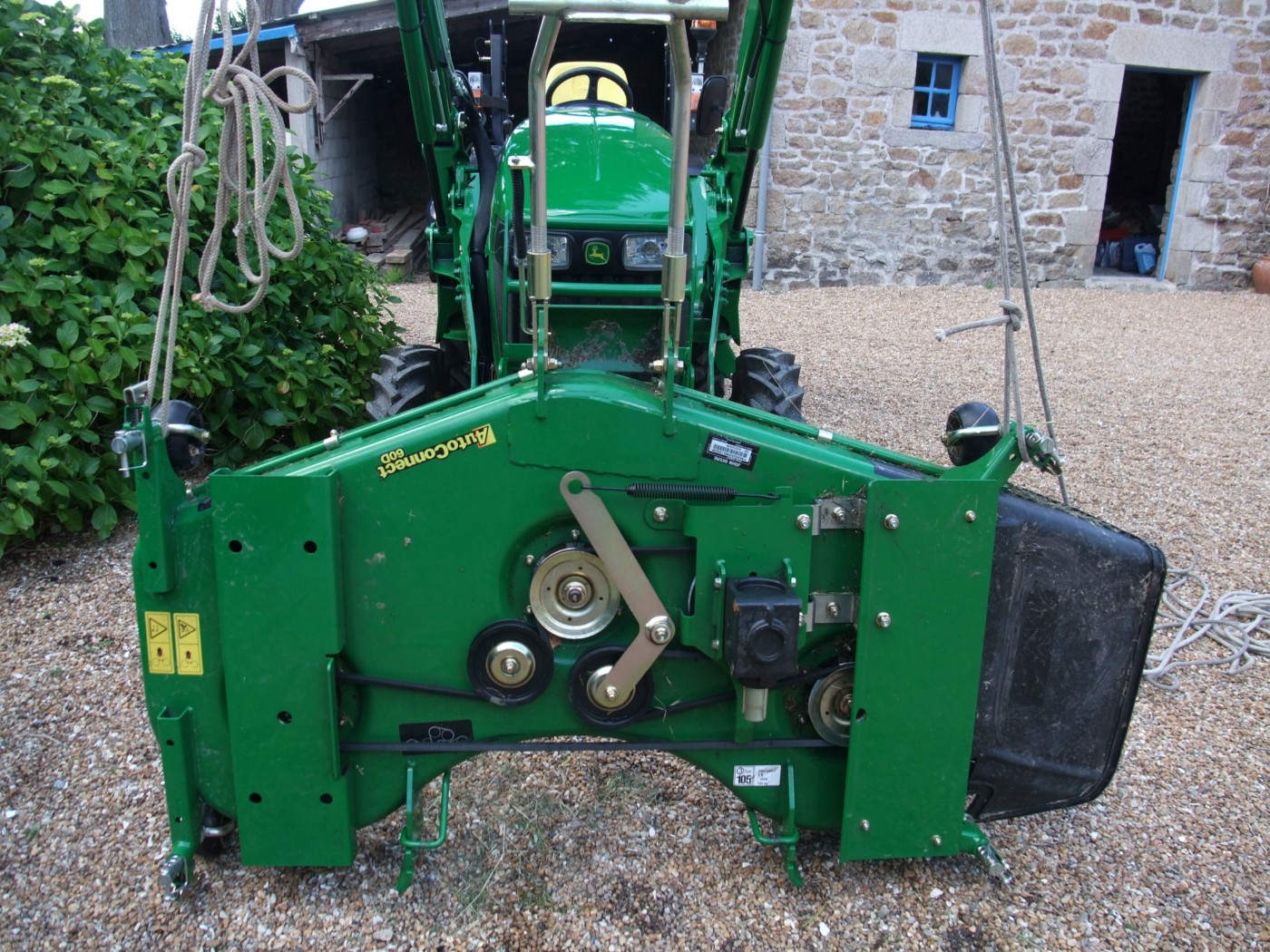

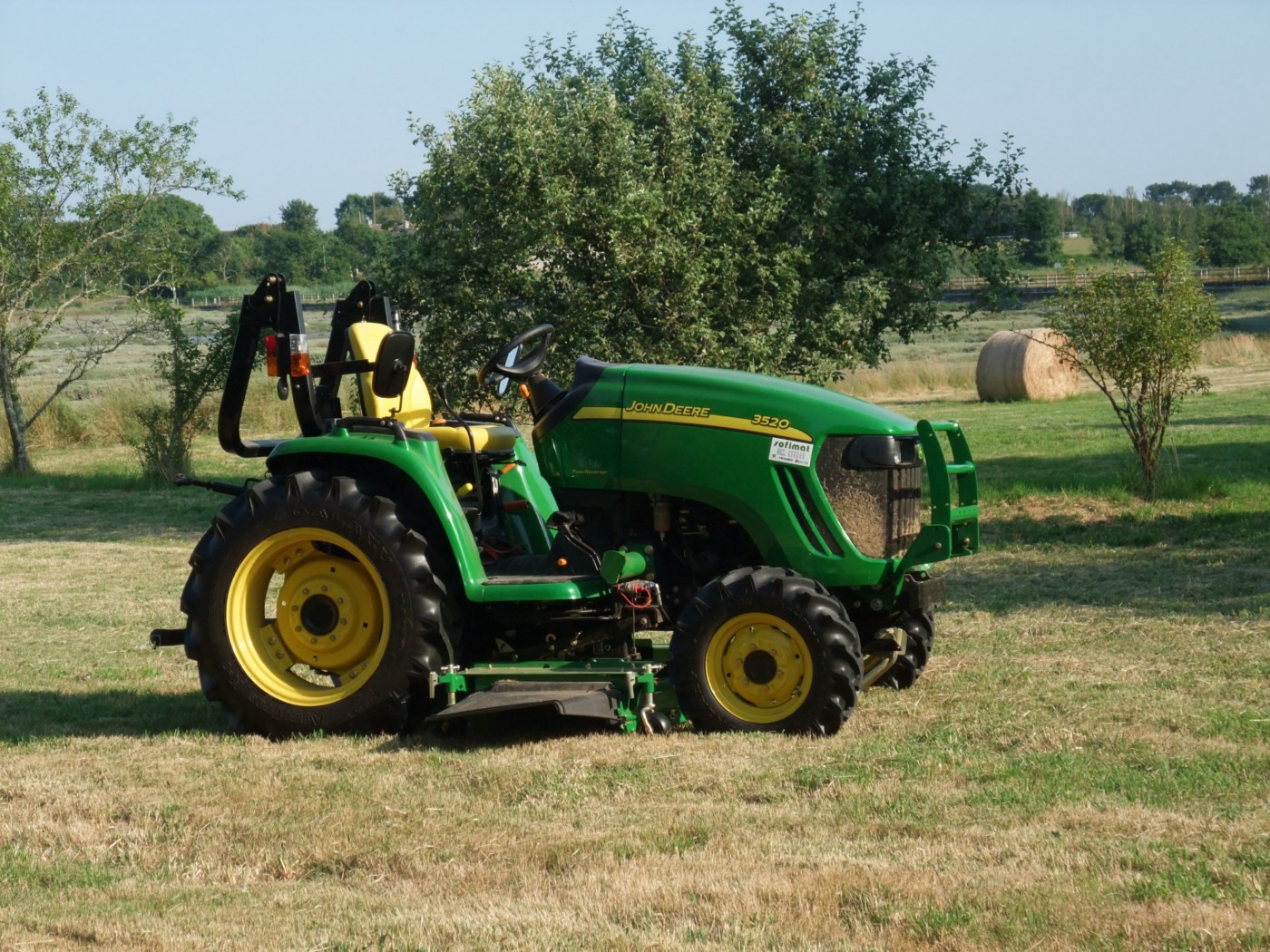

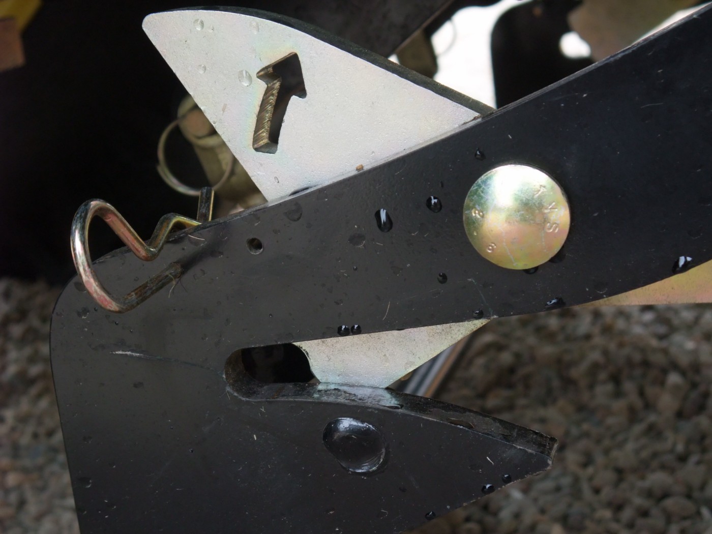

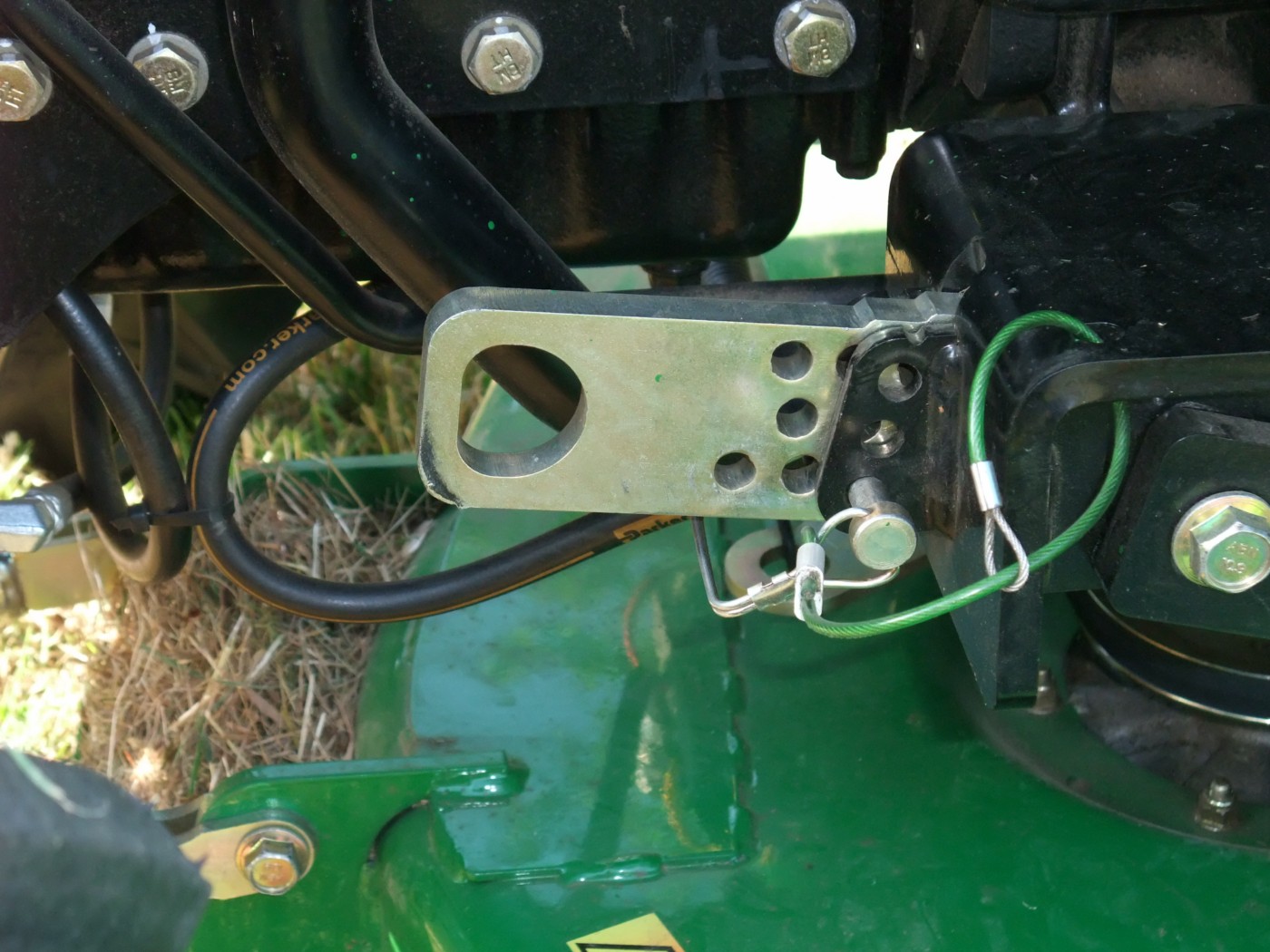

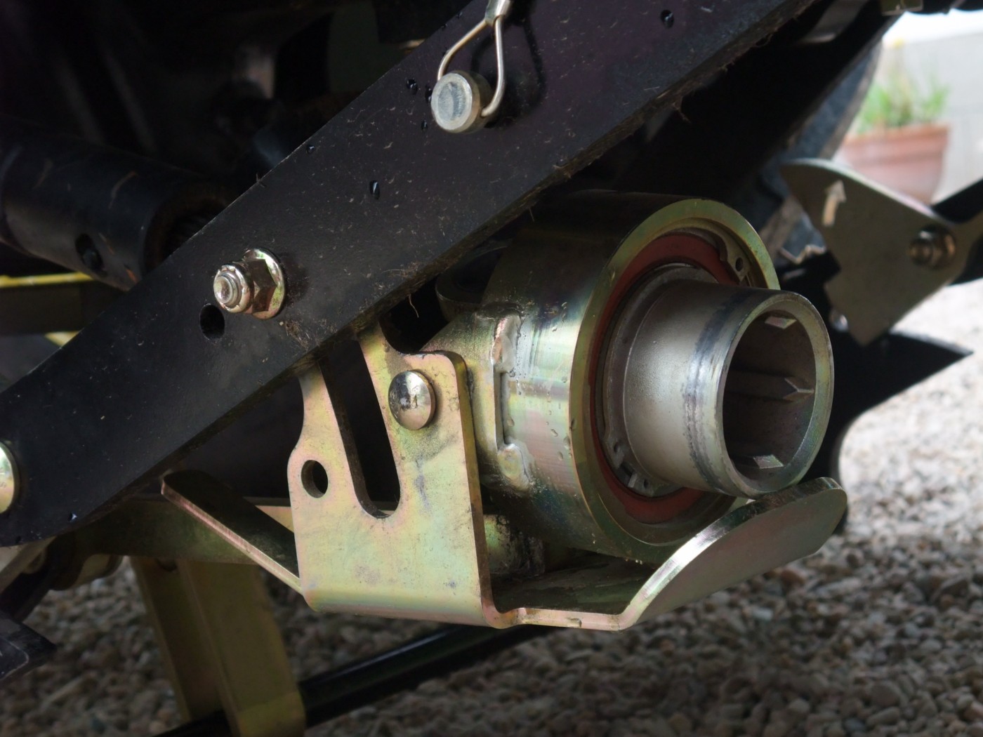

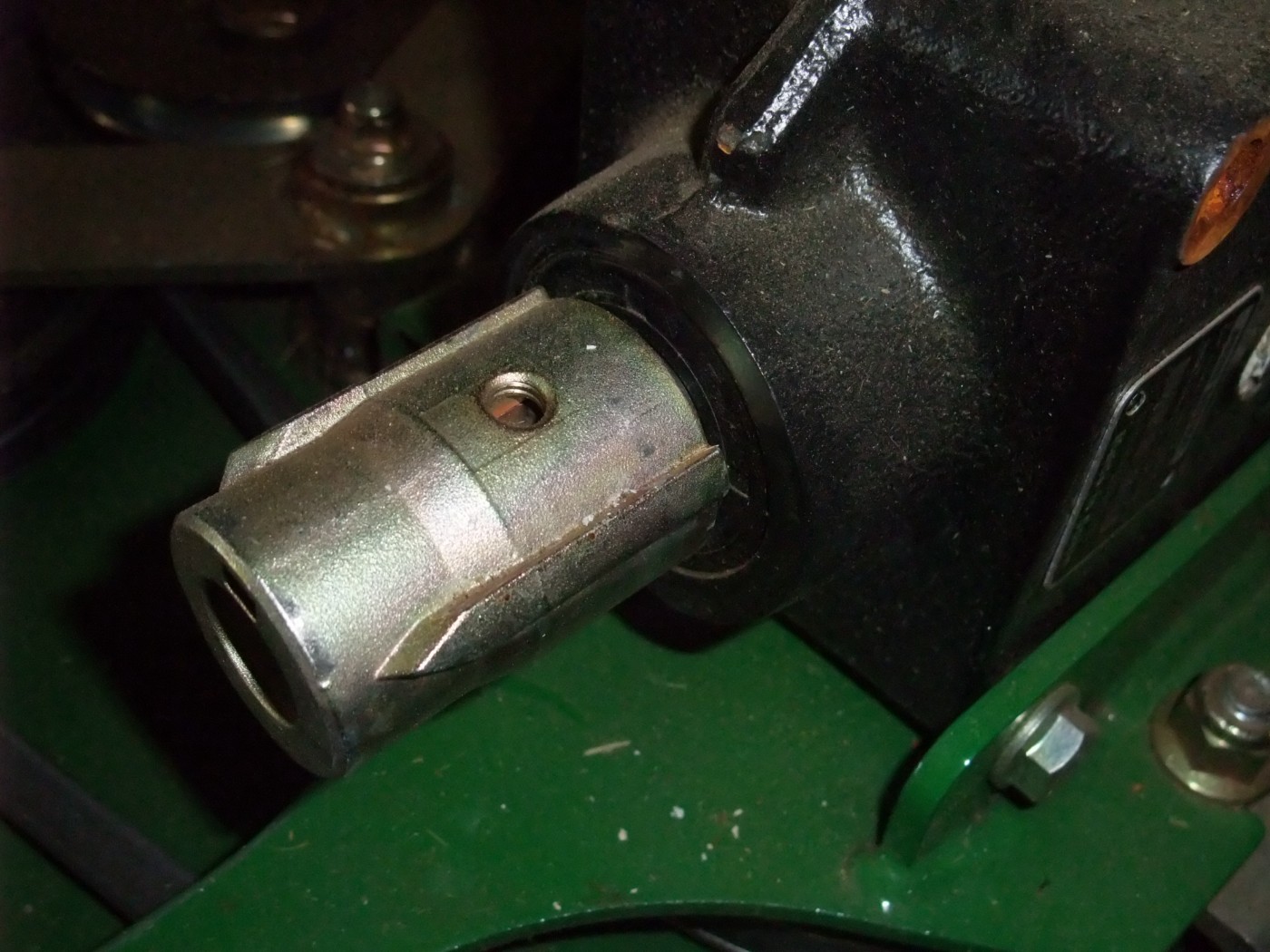

I have a 3520 and the 60D Autoconnect. I don't use a backhoe so cannot answer that question. For the rest, the MMM is perfectly compatible with the FEL (you lose the tilt function to use the line to lift the mower deck) and any 3pt implement. Putting it on and taking it off are not quite the piece of cake Deere make it sound to be but if you are careful you soon learn how to do it first time without forgetting one little pin or another and it requires no physical exertion.

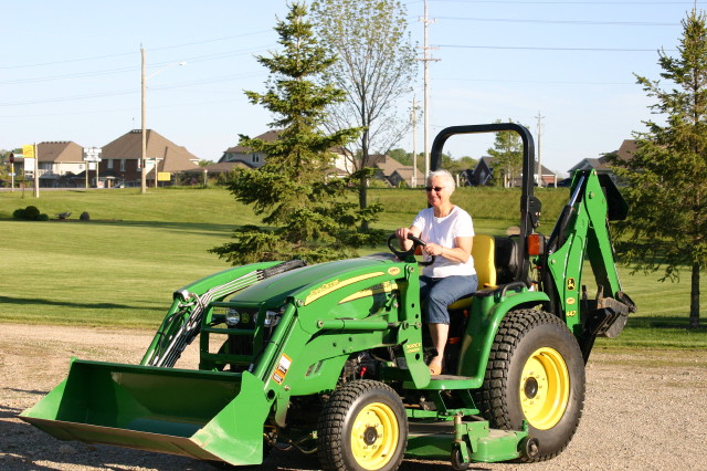

I've probably lost track of what question you are actually asking. Here is a pic of a 2008 JD 3320 with FEL, 7 Iron MMM and 447 BH all attached at the same time and I usually mow with everything on because every time I remove one of the pieces I need it the next day. I have no idea what type of frame the 448 / 485 BH uses but the 447 (and probably the 375) do not use a "sub-frame." The only thing that has to be removed to mount the BH are the 3PTH arms etc.

It's all on there isn't it! I emailed Deere and they replied to ask a dealer! This is where I got confused in the first place! Every dealer I ask tells me something different. THANKS, this answers the question better than any dealer now if I could just figure out how to pay for it all.
