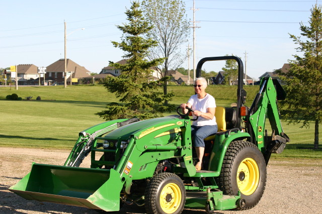

I've probably lost track of what question you are actually asking. Here is a pic of a 2008 JD 3320 with FEL, 7 Iron MMM and 447 BH all attached at the same time and I usually mow with everything on because every time I remove one of the pieces I need it the next day. I have no idea what type of frame the 448 / 485 BH uses but the 447 (and probably the 375) do not use a "sub-frame." The only thing that has to be removed to mount the BH are the 3PTH arms etc.

It's all on there isn't it! I emailed Deere and they replied to ask a dealer! This is where I got confused in the first place! Every dealer I ask tells me something different. THANKS, this answers the question better than any dealer now if I could just figure out how to pay for it all.
